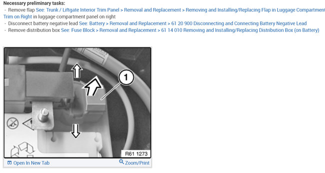

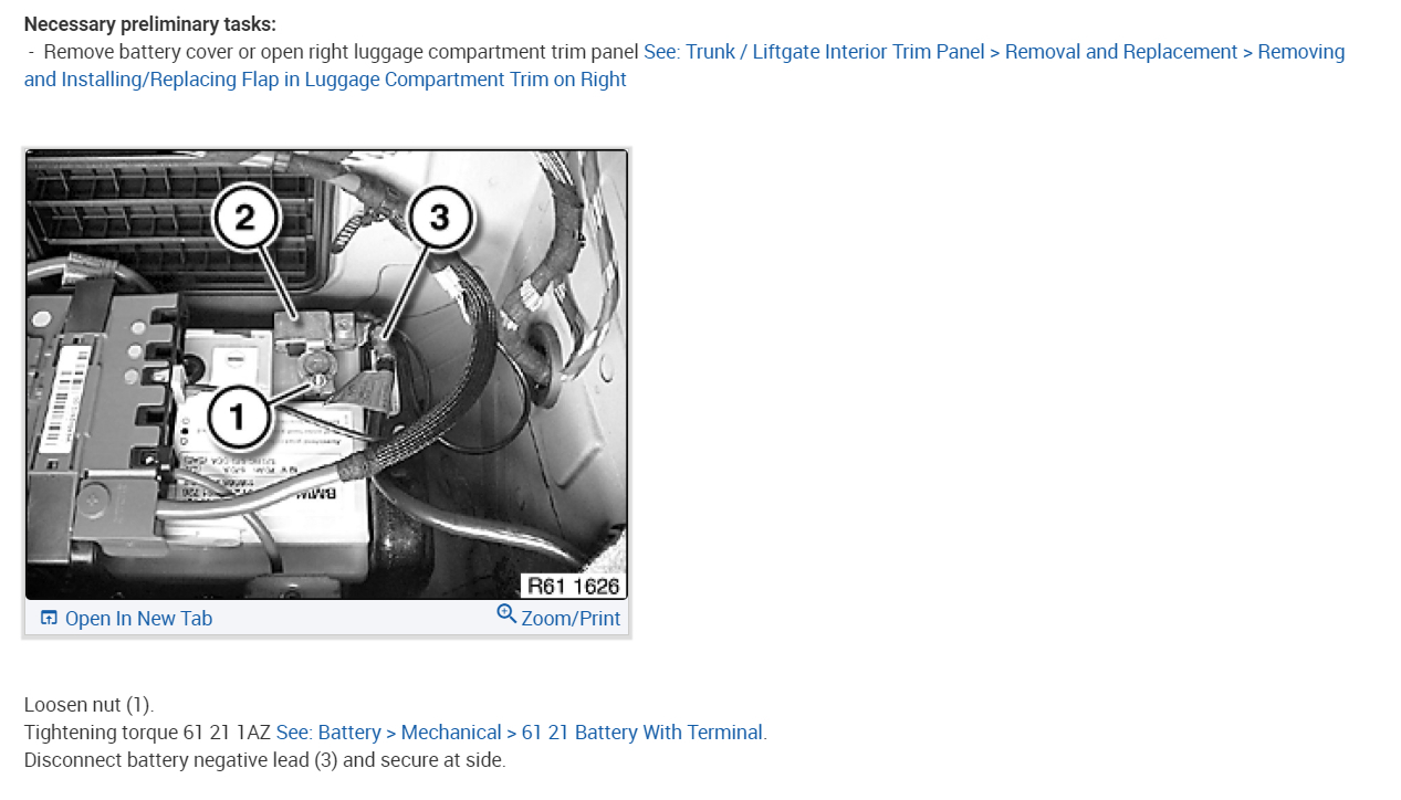

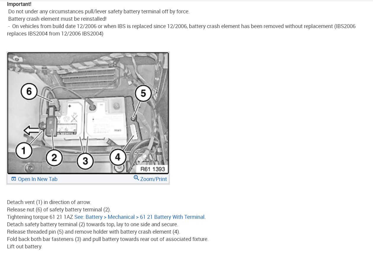

It sounds like the battery has shorted out and needs to be replaced. here is a guide that will walk you through the steps with instructions and diagrams below to show you on your car:
https://www.2carpros.com/articles/how-to-replace-a-car-battery
You can get a new battery from Costco. Check out the diagrams (below). Please let us know if you need anything else to get the problem fixed.
