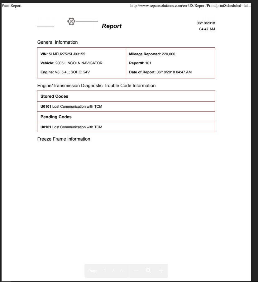

Yes, I have retrieved the codes and here are the results below.

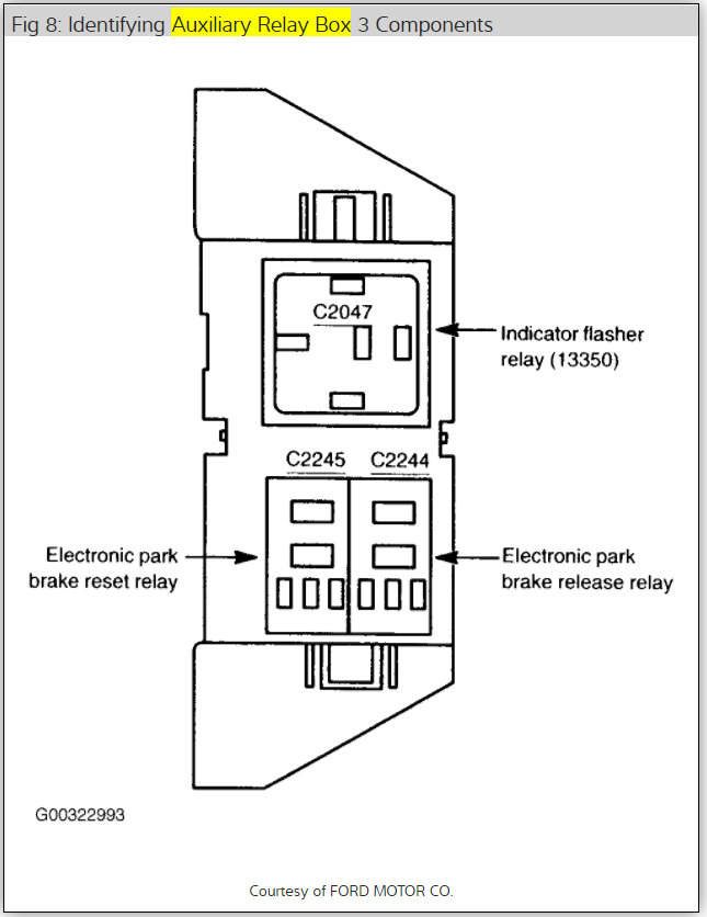

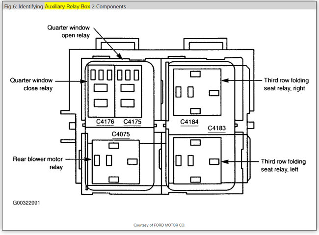

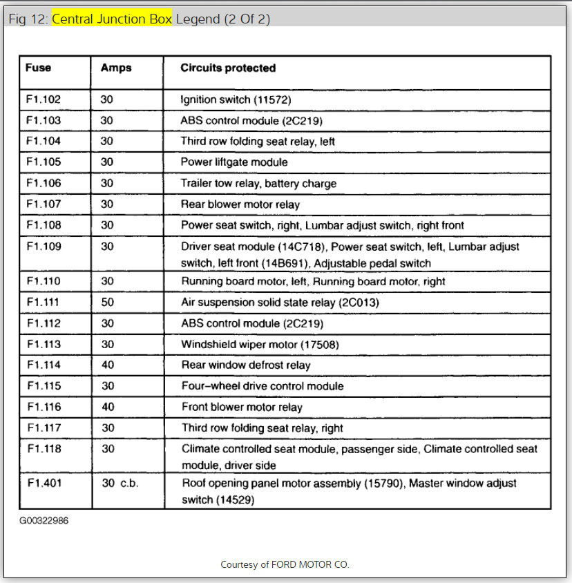

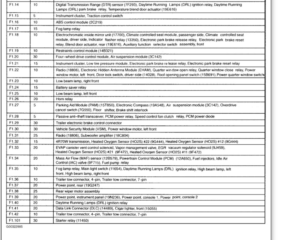

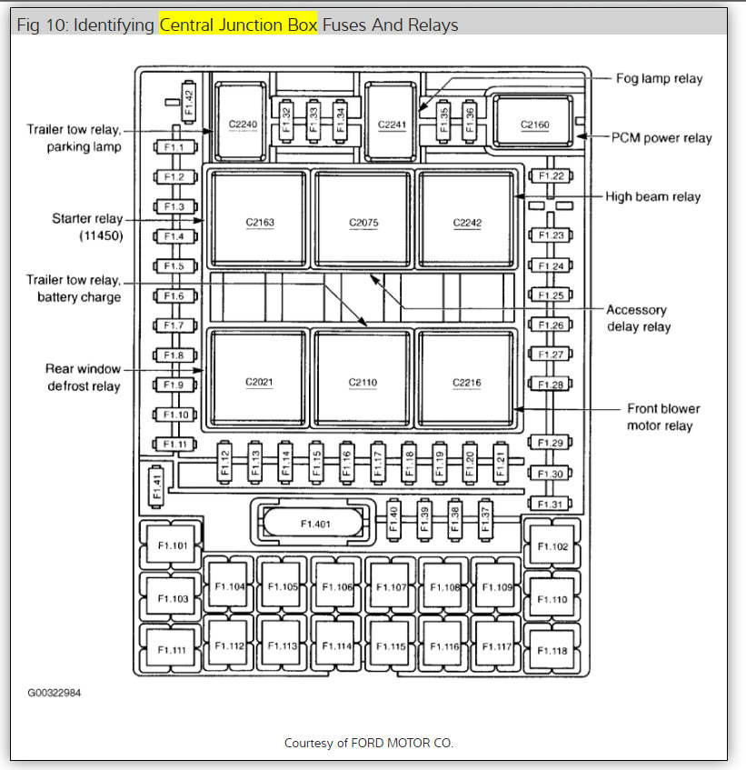

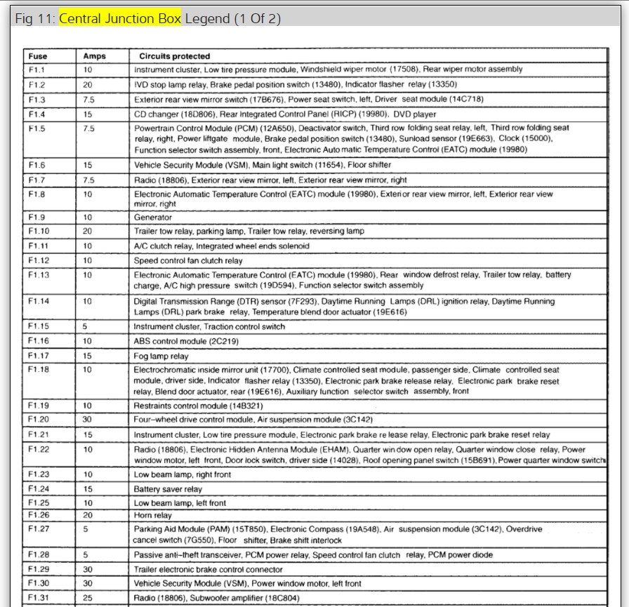

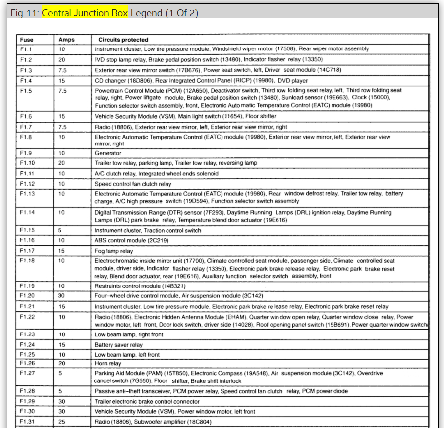

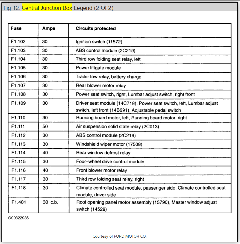

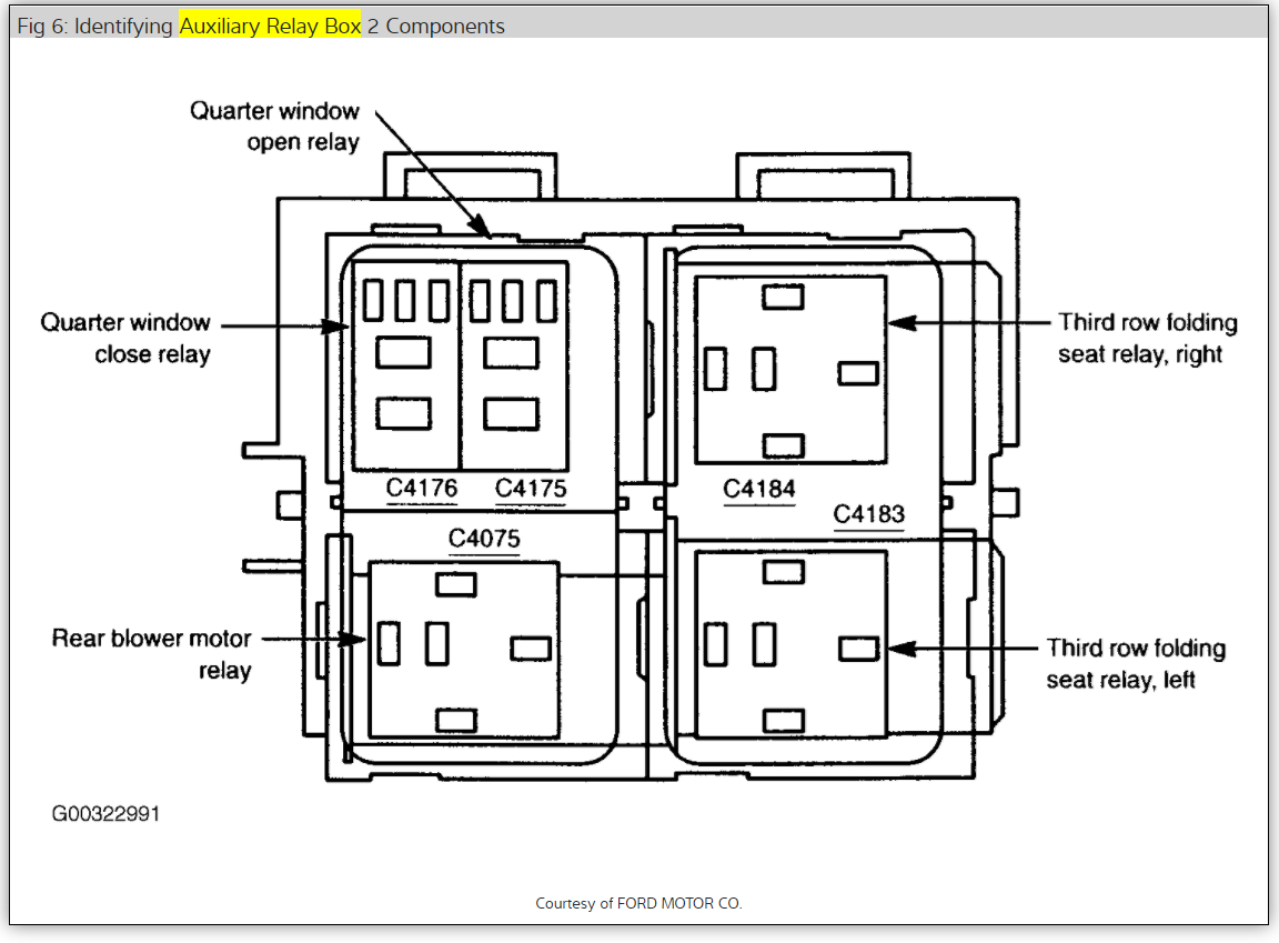

Okay, this usually means you have a fuse out or the PCM has failed and needs to be replaced. Here is a guide to help you test for power at the fuses and the 28, 9 and 27 fuse locations:
Check out the diagrams (below). Please let us know what you find.
Jun 20, 2018 at 3:32 AM

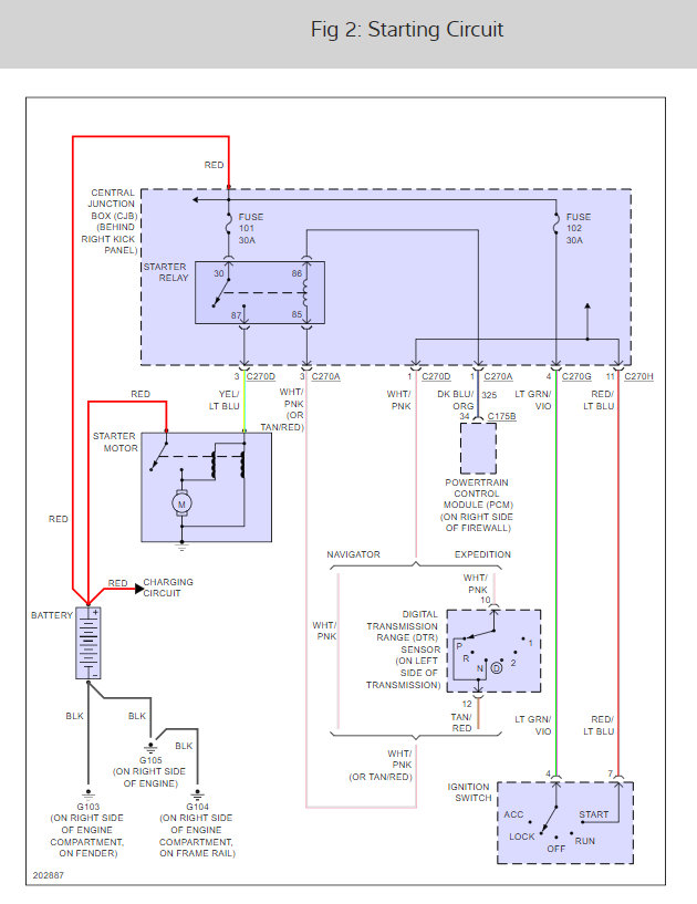

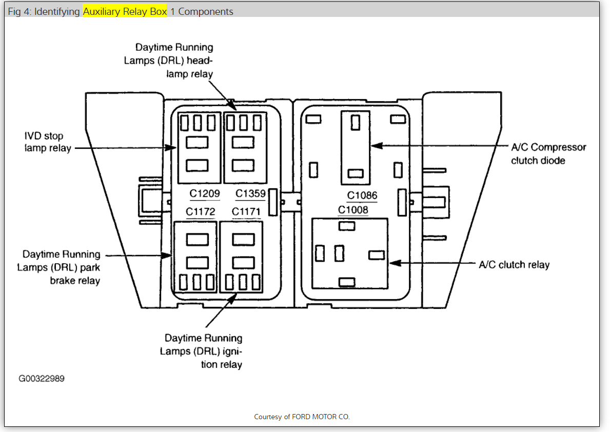

It sounds like the starter relay or the fusible link has gone out. Here is a guide and the wiring diagrams so you can see where you are losing power. Start with the trigger from the ignition switch.
