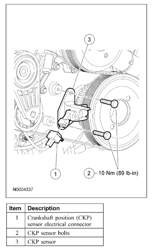

To me it sounds like you need a new MAF sensor because cleaning them doesn't always work if the sensor is too far gone. Next is the P0320 crankshaft sensor code, I am wondering when the harmonic balancer got replaced if they messed something up, also is the new sensor OEM? if not I would replace it with Motorcraft. Here is the instructions for changing the sensor below.
This guide can help as well
https://www.2carpros.com/articles/engine-stalls

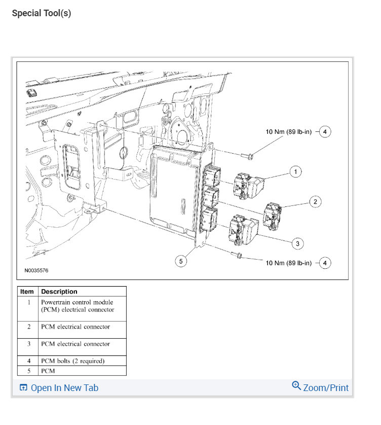

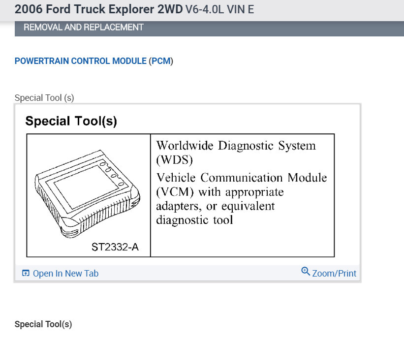

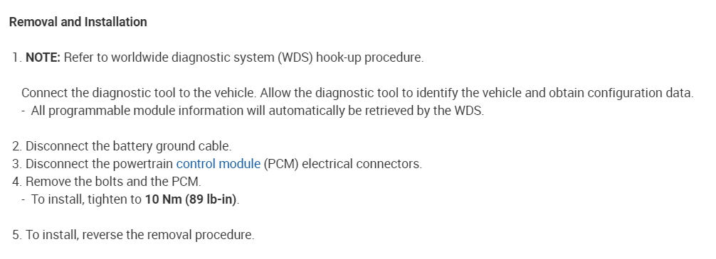

Yes, I have seen a bad PCM cause this as well, but I wanted to do the easy stuff first. You can try a used/rebuilt unit to see what happens. here is the location of the PCM. If you go for a rebuilt unit give your VIN so they can program it correctly for you. Check out the diagrams (below). Please let us know what happens.
