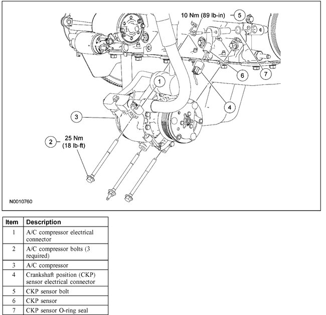

My car wont start at first it did every time. i put foot on gas it shuts off.what could this be? but now it wont start at all it just cranks. :(

Now, based on your description, it sounds like a fuel pressure issue or a bad crank sensor. Here is a link that describes a bad crank sensor and one that shows in general how one is replaced:
If you determine there is no spark to the plugs, this is my first suspect. Here is a link showing how to check spark:

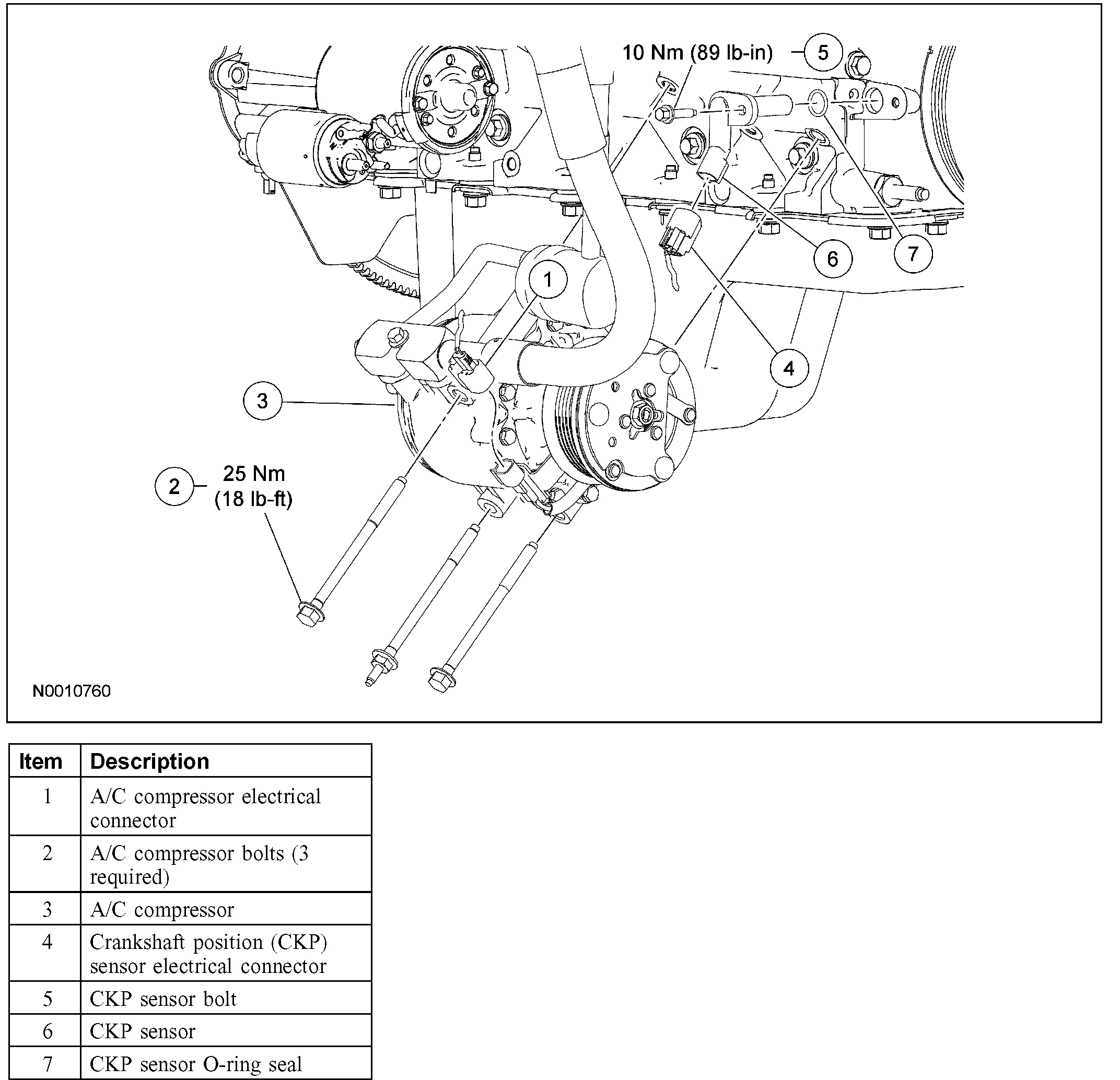

Here are the directions specific to your vehicle for sensor replacement
CRANKSHAFT POSITION (CKP) SENSOR
see pic 1
Removal and Installation
1. With the vehicle in NEUTRAL, position it on a hoist.
2. Disconnect the battery ground cable.
3. Remove the accessory drive belt.
4. Disconnect the A/C compressor electrical connector.
5. Remove the 3 bolts and position the A/C compressor aside.
- To install, tighten to 25 Nm (18 lb-ft).
6. Disconnect the crankshaft position (CKP) sensor electrical connector.
7. Remove the bolt and the CKP sensor. Discard the O-ring seal.
- To install, tighten to 10 Nm (89 lb-in).
- Lubricate the new O-ring seal with clean engine oil prior to installation.
8. To install, reverse the removal procedure.
