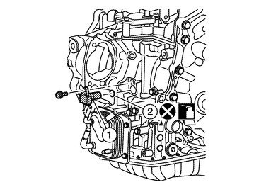

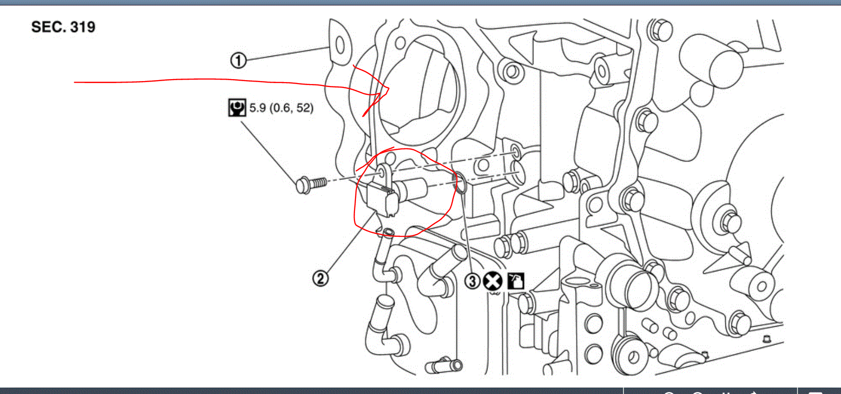

The input speed sensor is near the starter motor. If you look at pic 1, I circled the sensor and have an arrow pointing where the starter would be located.

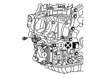

INPUT SPEED SENSOR - REMOVAL AND INSTALLATION
Removal and Installation
REMOVAL
Remove the battery tray. Refer to Removal and Installation.
Remove the starter motor. Refer to Removal and Installation.
Disconnect the harness connector from the input speed sensor (1).
pic 2
Remove the input speed sensor bolt, then the input speed sensor (1).
Remove the O-ring (2) from the input speed sensor (1).
CAUTION: Do not reuse O-ring.
INSTALLATION
Installation is in the reverse order of removal.
CAUTION:
Apply Genuine NISSAN CVT Fluid NS-3 to the O-ring.
Perform "ADDITIONAL SERVICE WHEN REPLACING ECM". Refer to Removal and Installation

When you reinstall the new sensor, lubricate the o-ring with a small amount of oil.

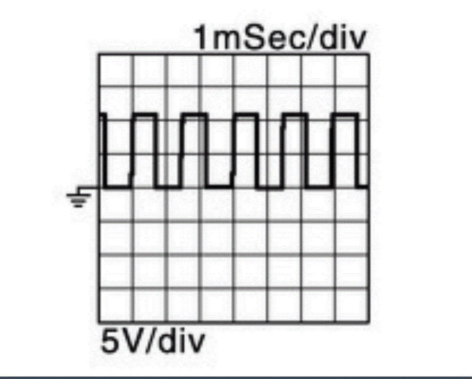

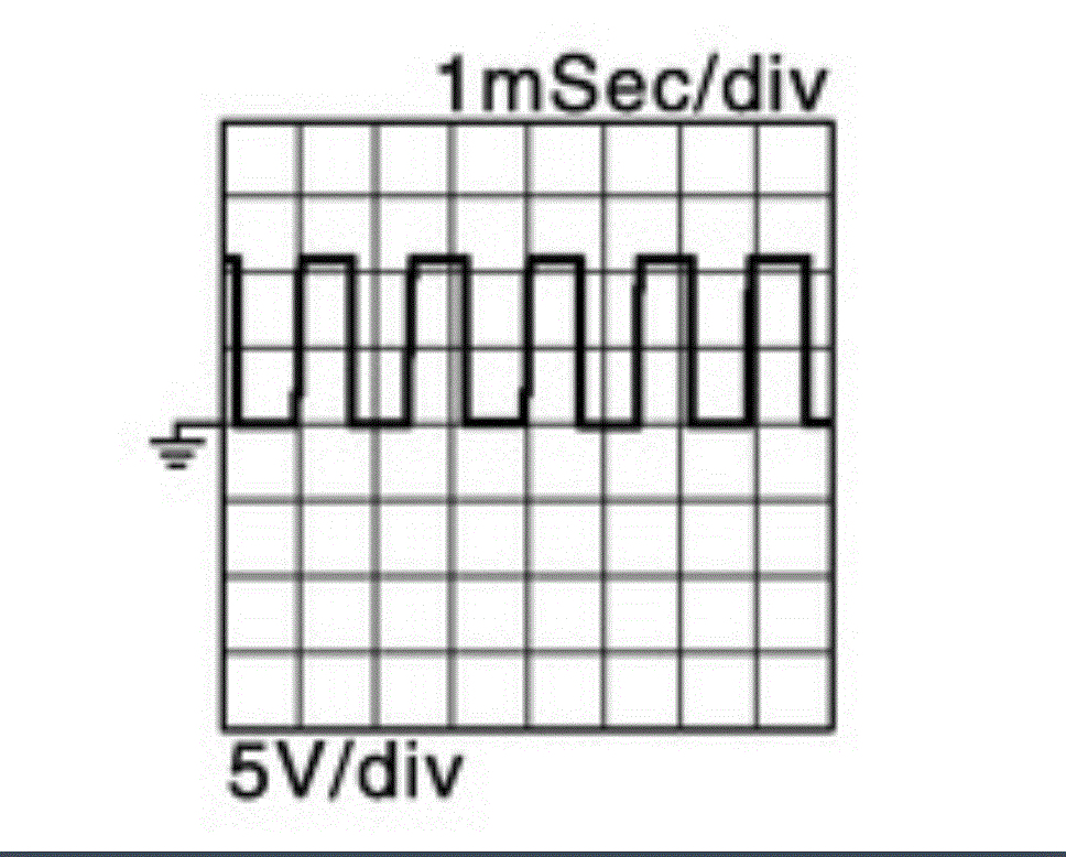

5. CHECK TCM INPUT SIGNALS
Connect all of disconnected connectors.
Lift the vehicle.
Start the engine.
Check frequency of primary speed sensor.
+ - Condition Standard
TCM
Connector Terminal
F16 35 Ground
Selector lever: "DS" position
Vehicle speed: 20 km/h (12 MPH)
Approx. 700 Hz
See pic 1 below.
Is the inspection result normal?
YES >> Check intermittent incident. Refer to Intermittent Incident.
NO >> Replace primary speed sensor. Refer to Removal and Installation.
