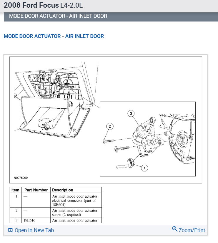

i would like to know the location of the blend door actuator and its access for replacement.
Aug 20, 2019 at 9:12 PM
  • 55,423 POSTS

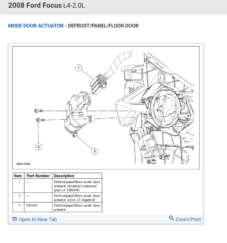

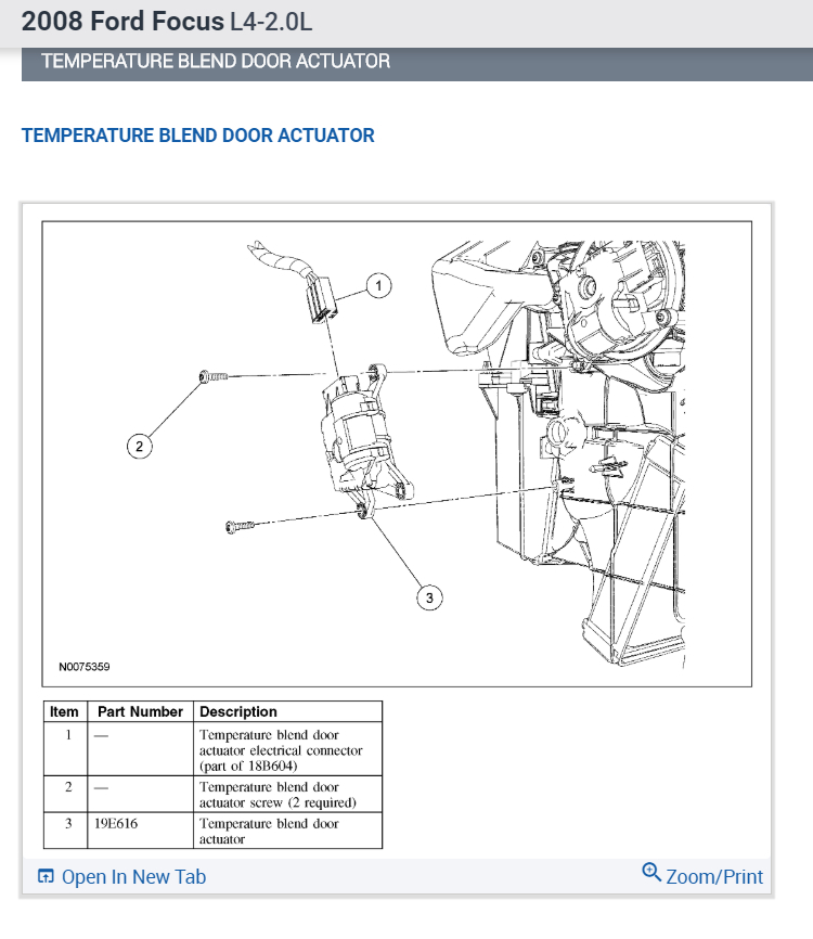

This guide will help walk you through the repair with instruction and locations of the blend door actuators for your car in the diagrams below.
Aug 22, 2019 at 6:26 AM

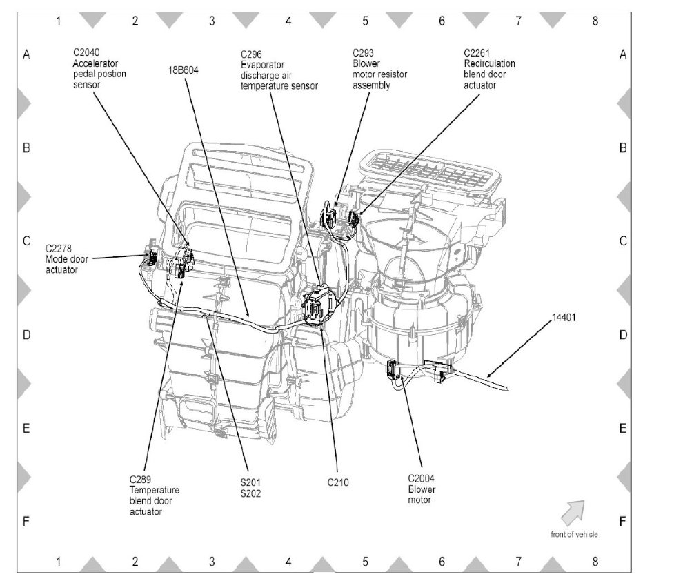

Hi Ken,
Thank you for your reply. yes i found the actuator but only one. am i right in assuming because i have climate control in my car that there is more than one actuator? if so, where are the others?
Regards,
Roger
Aug 23, 2019 at 10:29 PM
  • 55,423 POSTS
Nice work, if you click the diagrams I left you in the first post you will see all actuators. Can you please shoot a quick video with your phone so we can see what's going on, that would be great. You can upload it here with your response.
