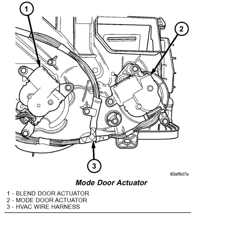

FCNOTA
Heater problem
2004 Chrysler Sebring six cylinder front wheel drive automatic 70,000 miles.
I have a no heat condition inside the car, any position. Radiator is full, engine at normal operating temperature, heater hoses to and from the heater core engine temperature hot (finger burning when hoses are touched). All blower speeds work, air conditioner works. Air from vents with A/C off just above outside air temperature (thermometer checked) with A/C on drops into the fifties (about seventy outside). Removed the knob control panel, disconnected and reconnected all wire looms (only two, one for fan speed, one for everything else). All positions switch (feet, vents, defroster and everything in between). Is it the knob control assembly or is there something else it could be? Car runs fine, just no heat.
Oct 7, 2017 at 4:51 AM (Merged)

If you do need to get back with me please tell me if your model is just the Sebring or the GTC or Limited and the engine size in liter.
Looks like you did a lot of troubleshooting I did read that you checked the heater hoses at the firewall where they go in and out and they are the same temperature?
The only thing I can think of right now looking at the manual is the Air Mix Damper door. Below is the directions for setting up it after removeal….it may be out of adjustment or the cable clip came off and the cable came off.

FCNOTA
Thank you for the reply!
The car is a Sebring Convertible Limited, V6 2.7 liter.
Both hoses going to and from the heater core are hot. I have bled the bleeder valve with little to no air coming out.
On which side of the dash would this control be located? I have pulled the glove box and lower panel on the passenger side, but saw nothing like the picture. Also, I have not found any cables going to any of the dash controls, its all wires.
I had to have the water pump replaced (to the tune of $1,100.00) in July. Is this no heat condition possibly a result of that? Could something have been left disconnected?
Thanks for the help. this is driving me crazy!

IMPALASS
  • 3,112 POSTS
Hello, Thanks for the information. Now that I have the information on your specific model, it appears it may be all electrical as you have indicated especially since you have done all the work and saw there were no cables great job! I would say it may be the blend door actuator. It is electrically controlled by a potentiometer in the actuator and allows the BCM to know the exact position of the blend door at all times. It appears there may be the mode actuator control right next to it. If it were me I would check with the parts department to see if they are the same part number. If so swap them and if it then works that is your problem. Here is the info below on it. DESCRIPTION: The blend door actuator is a motor/geartrain assembly which mechanically positions the blend door. The actuator is mounted to the bottom of the HVAC housing in the center. OPERATION: A potentiometer in the actuator allows the BCM to know the exact position of the blend door at all times. The blend door actuator is not serviceable and must be replaced if found to be defective. REMOVAL: 1. Disconnect negative battery cable. 2. Remove the passengerside hush panel. 3. Disconnect the electrical connection. 4. Remove actuator retaining screws and pull actuator straight down (Fig. 24 ). Note actuator shaft position for installation reference. Fig. 24: Identifying Blend Door Actuator Courtesy of DAIMLERCHRYSLER CORP.
https://images.2carpros.com/forum/automotive_pictures/248015_24_3.jpg
INSTALLATION: 1. Install blend door actuator on the housing, making sure the shaft spline is positioned properly with the cam (Fig. 25 ). Fig. 25: Identifying Blend Actuator Spline Courtesy of DAIMLERCHRYSLER CORP.
https://images.2carpros.com/forum/automotive_pictures/248015_25_2.jpg
2. Install tighten the actuator mounting. 3. Connect wire harness connector to the actuator. 4. Install the passengerside hush panel. 5. Connect the negative battery cable.

FCNOTA
You were right on the money!
Last night I tore the car apart looking for the cables and stuff and found the two actuators. One moved, one did not. Saw your email this am, went out and picked up the actuator, put it in the car this evening, heat! Was a pain, had to take the stereo, CD player, glove box and entire center and right side dash covering off to get one bolt off and on the actuator, but it was worth it.
It is very important to disconnect the negative cable. It resets the system or something. I did not remember to do it at first, and it did not work. I went back over the directions, disconnected the cable for about three minutes reconnected everything and it works fine.
Thank you for the help! I will be back again!
