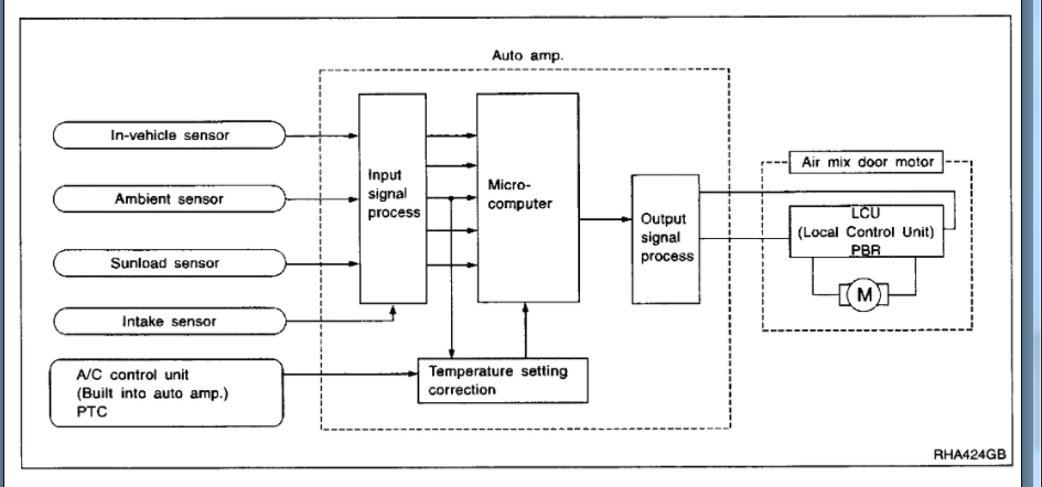

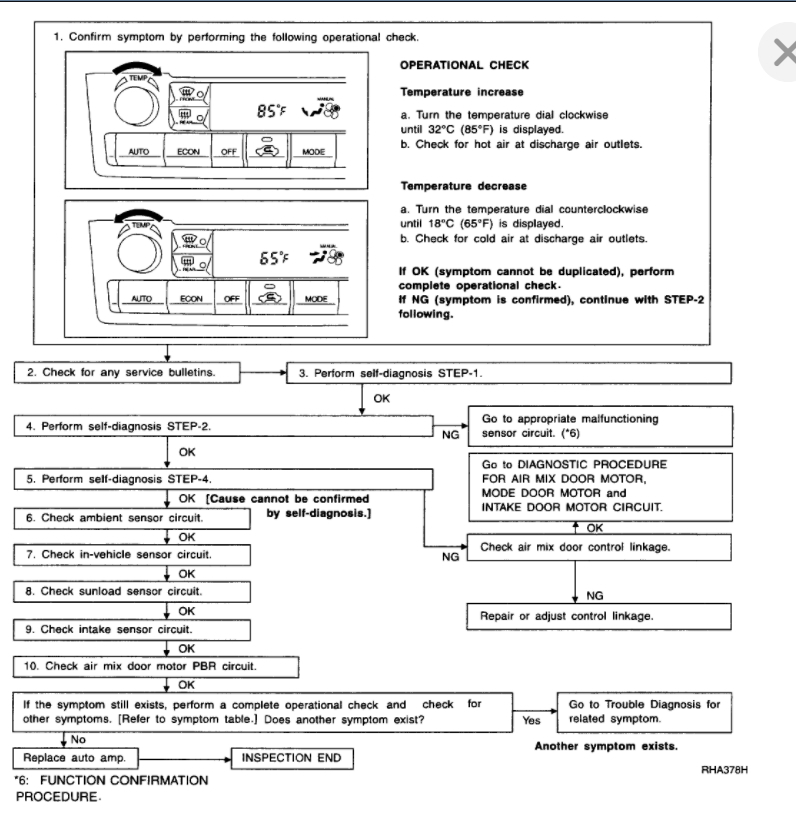

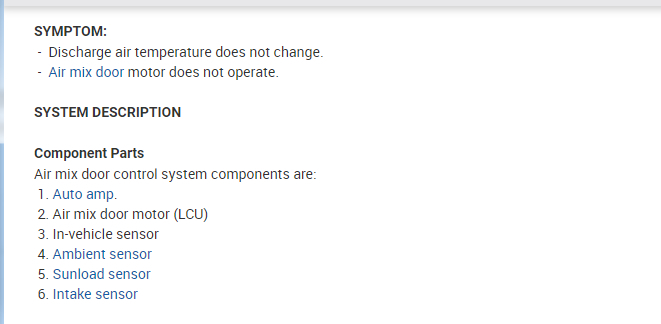

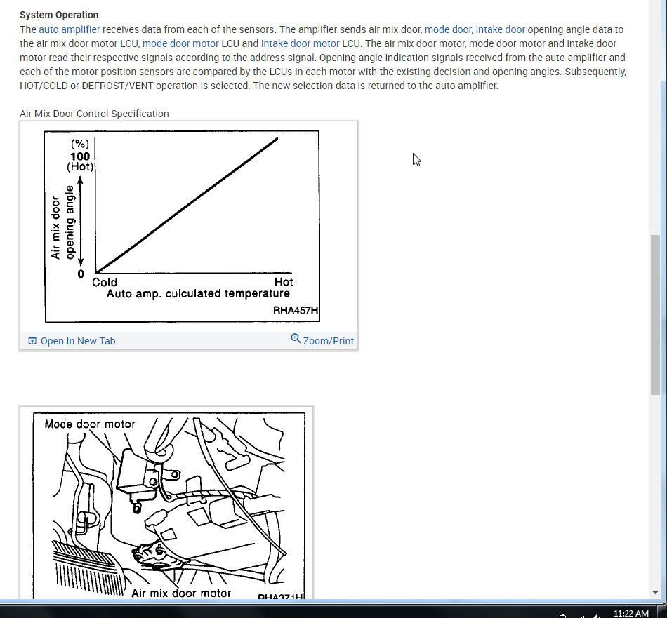

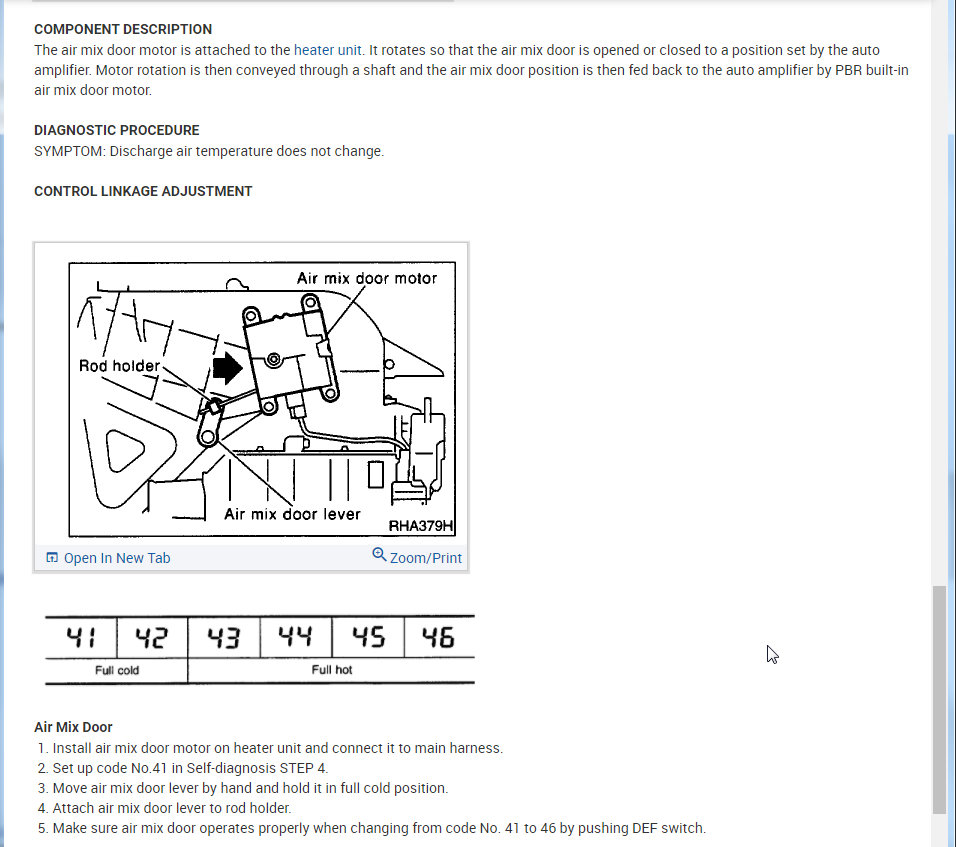

More then likely this is the blend door is not moving but we need to test this.
I attached below how to test it and then the location to replace it as well.
Here is a guide that will help with this:
This makes the most sense if you have auto temp control but let me know if you have manual temperature control and we can adjust as needed. Thanks
