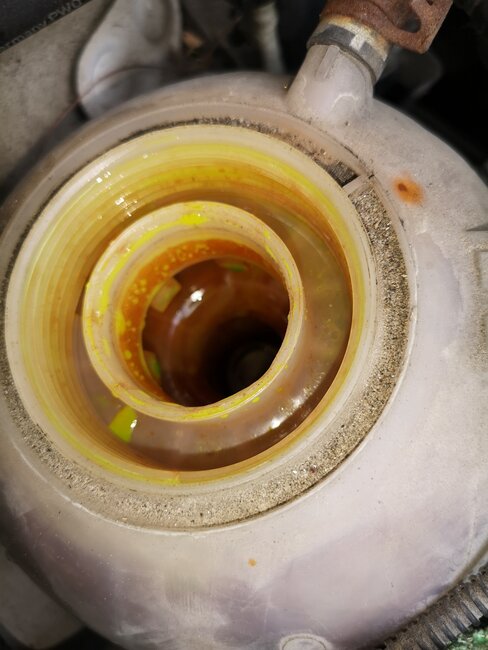

CHRIST CHEN
  • 36 POSTS
Hi Joe,
Sorry for the delay, I had a hard time finding proper material.
I did try the dye (see on photo), drove for about 70 miles and can't see any leaks (bright yellow dye spots) anywhere even under the timing belt cover, but the smell was still there only between radiator and engine (transmission side). no smell inside the car, so it's surely not the heater core at this point, I'm confused.
Can it be the radiator itself but doesn't show significant leaks?
Christian
Aug 25, 2024 at 12:51 PM
  • 110,194 POSTS
If you smell it but see no leaks, the only thing I can think of to do at this point would be a pressure test.

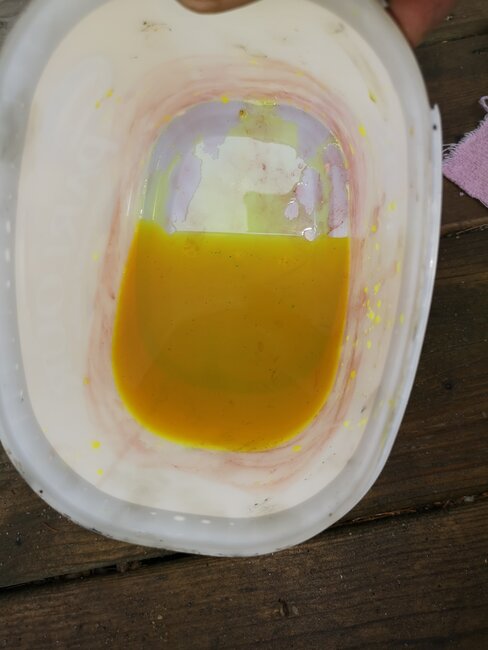

CHRIST CHEN
  • 36 POSTS
Hi Joe,
On the pic, it shows how much coolant there was in the heater core (i don't know how much there supposed to be) and there was no obstruction in heater core.
I used a garden hose to flush it both ways(inlet,outlet).
Still same issue.
I start to think it's the engine radiator itself or there is some exhaust getting in the system by head gasket.
Christian
Aug 31, 2024 at 8:35 AM
  • 110,194 POSTS
I would think there should be more, but anything is possible. Here is a link that explains how to flush the system. I don't know if you need it or not.
