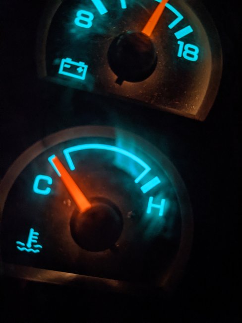

Going to check all of that now. Feel I should note the gauge did move after an hour of driving around. A tiny amount in the picture. There has to be some issue with the wiring between the gauge and the computer?
Jan 20, 2021 at 11:26 PM

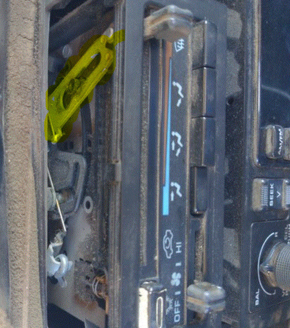

If the hoses are hot, then heat is getting into the vehicle. The problem is likely bad or misadjusted blend air door cable. Take a look at the attached pic. A cable from the controller on the dash runs to that lever on the HVAC box under the dash. Confirm it is moving when you adjust temperature. Also, make sure the shaft is moving on the lever.
Jan 21, 2021 at 1:12 PM

I did some testing on the wires for the temperature gauge problem. the connector to the temperature gauge switch on the passenger side of the radiator hose has almost no power to it when it's connected to a test light it barely shows but not bright like it should. Does this indicate that the gauge itself has gone bad or that the wire has gone bad or rather the connector at the wire in the engine bay? Please advise. Will be checking the blend door as soon as I can get the front panels off I spent most of the good part of the sun today painting the truck bed with bed liner.
I am referring to the yellow and violet/purple wire that I've seen on a couple of forum posts connects directly to the gauge, supposedly. Unsure I have a 96 v6 Magnum. and there's no post for that specifically I found one video set on the temperature gauge for an 88 v6 Magnum but it's a totally different connector.

After a small amount of silicone WD 40 the gauge reads maybe 20 percent better. Still not fully correctly but as though some of the excess resistance was at the connector (extremely dirty).
Still unsure but the heater issue was marginally better when the gauge read at a higher temperature. Are they systems connected? Next week I will be replacing thermostat (I think is stuck open) thermostat housing, and flushing the heater core while I'm in there. Can't hurt hoping that the thermostat being stuck open is part of my heater issue. I had read that it flows coolant too quickly through the heater core. Could be wrong. Could have a blockage, could be the gauge itself. Have to junkyard for a replacement in case.

The coolant has to be hot regardless of the gauge for heat to be created in the vehicle. The gauge and the heater are not dependent on each other.
A stuck thermostat can prevent the engine from reaching operating temp, so that can cause low heat. I would replace it and flush the heater core as well when it's apart. Here are a couple of links you may find helpful:

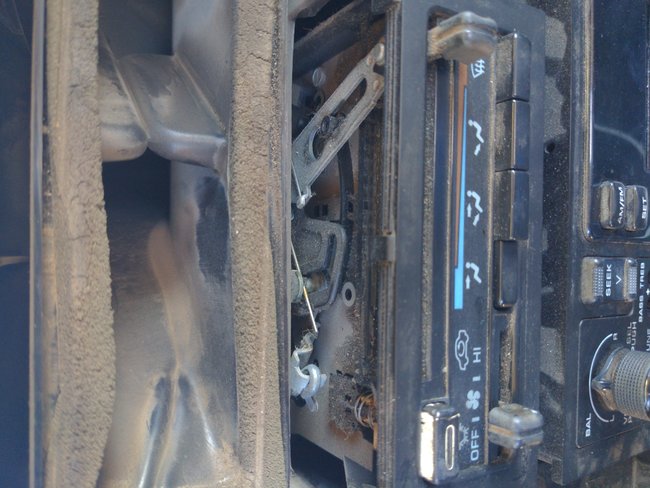

Shaft is moving can't locate the blend door actuator. unclear what need to be removed next.
This is the Console box and it's moving properly.

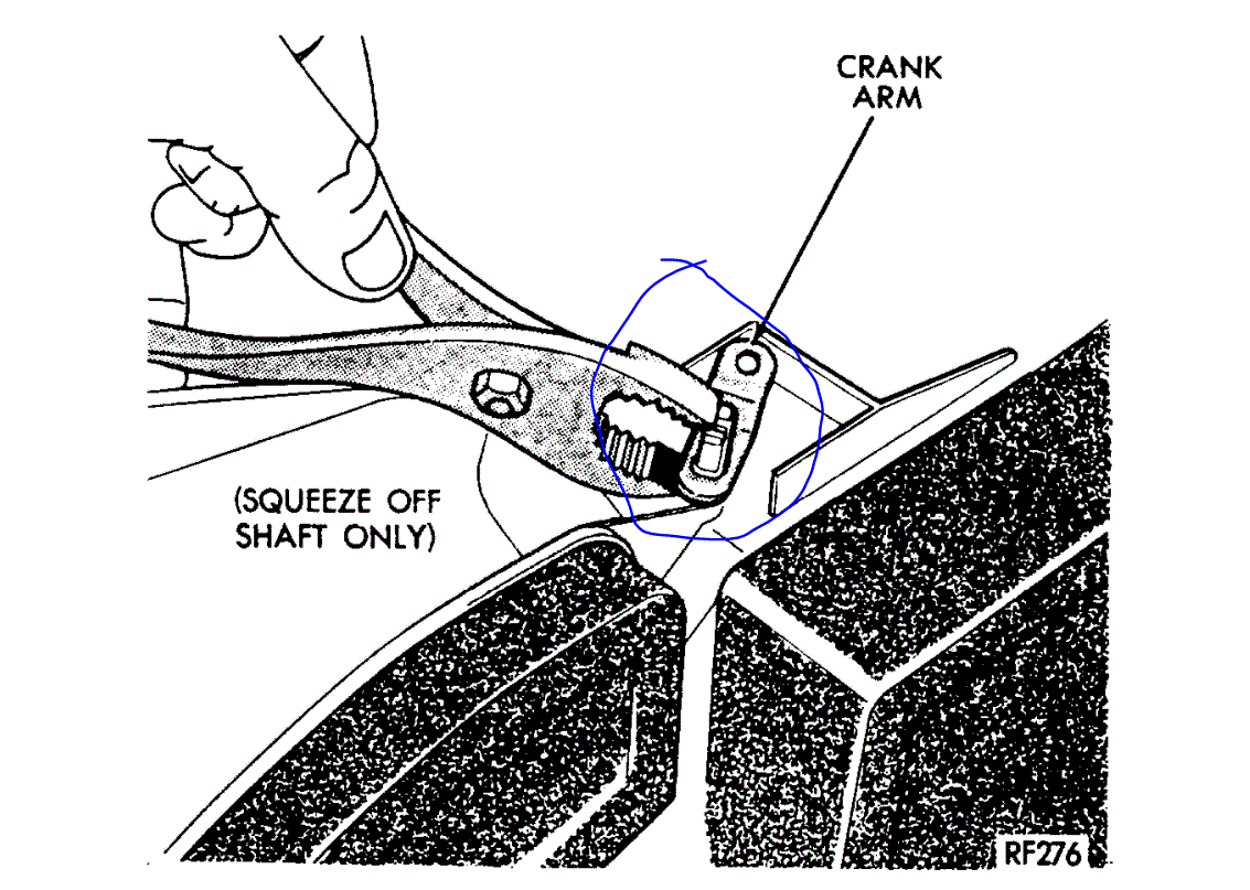

I attached a portion of your pic and highlighted the arm that will have a cable attached to it. If you follow that cable, it will take you to the blend door lever. That is what we need to confirm is moving.

So it isn't the black cable attached to the arm? I don't see a cable running from that piece in particular. Will I need to remove the box?
