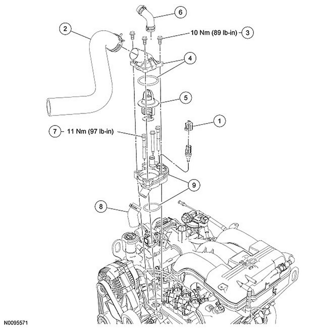

First, I live south of you in PA. Same thing here with temps. Tell me, how long does it take for the engine to warm up? If the thermostat is sticking slightly open, it will take an extended period of time before it warms up.
https://www.2carpros.com/articles/how-an-engine-thermostat-works
Pay attention tomorrow when you drive how long it takes to reach operating temp. Once I know what you find, I can better direct you.
There are two actuators which operate what are called blend air doors. There is one for each side. Their basic function is to allow heat or AC to enter the vehicle. If they are not working properly, they may be limiting the amount of heat entering the vehicle.
____________________________________________________

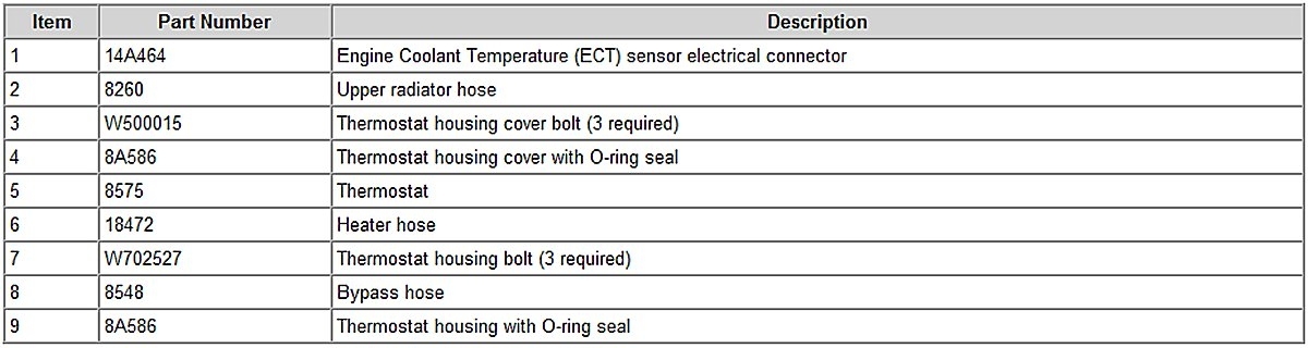

If you find the engine is taking an extended amount of time to heat up, here is a link that shows how to replace a thermostat.
Here are the directions specific to your vehicle.
Removal and Installation
1. Drain the engine cooling system.
2. Release the clamp and disconnect the upper radiator hose from the thermostat housing cover.
3. Remove the bolts and the thermostat housing cover.
- To install, tighten to 10 Nm (89 lb-in).
4. Remove the thermostat.
5. NOTE: Inspect the thermostat housing cover O-ring seal. Install a new O-ring seal if necessary.
To install, reverse the removal procedure.

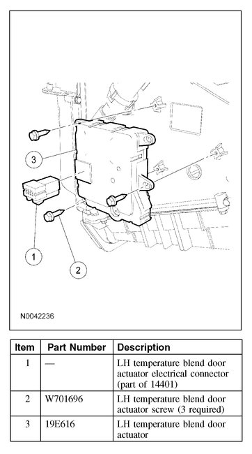

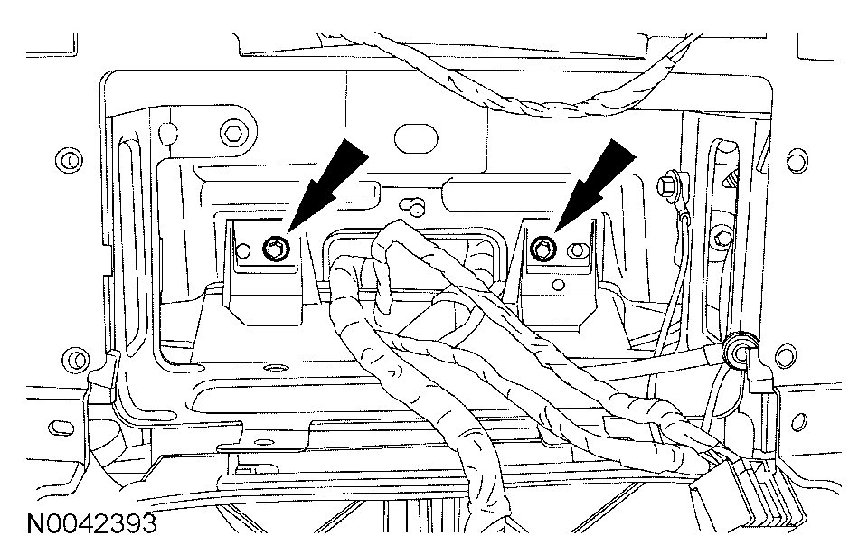

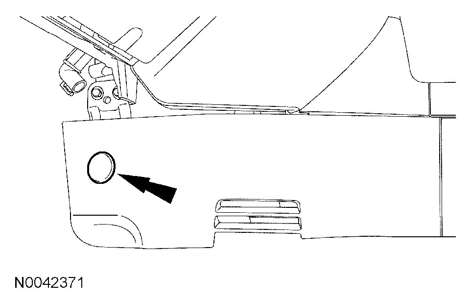

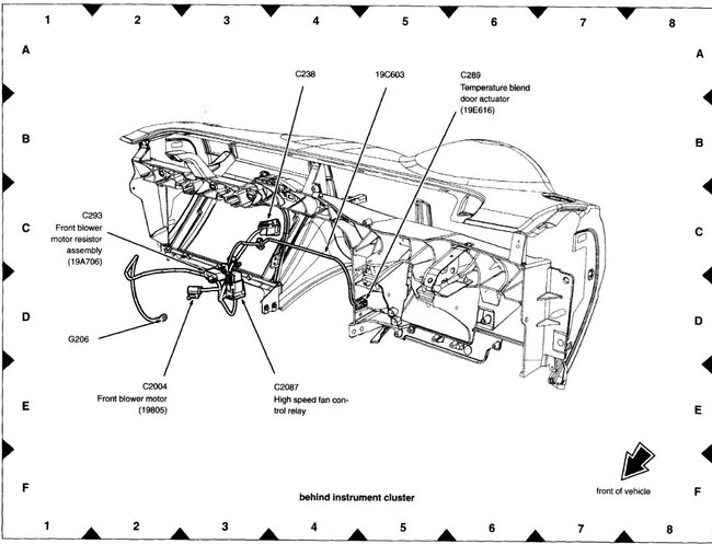

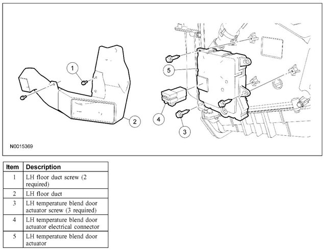

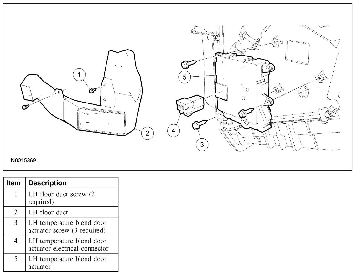

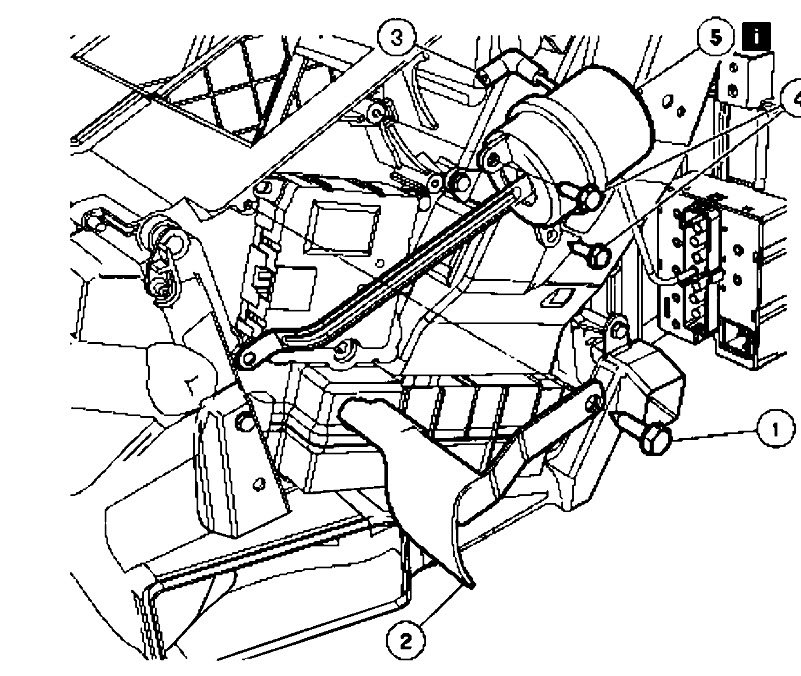

Here are the directions for the blend air door actuators. I will start with the driver's side.
TEMPERATURE BLEND DOOR ACTUATOR - LH
See Picture 3

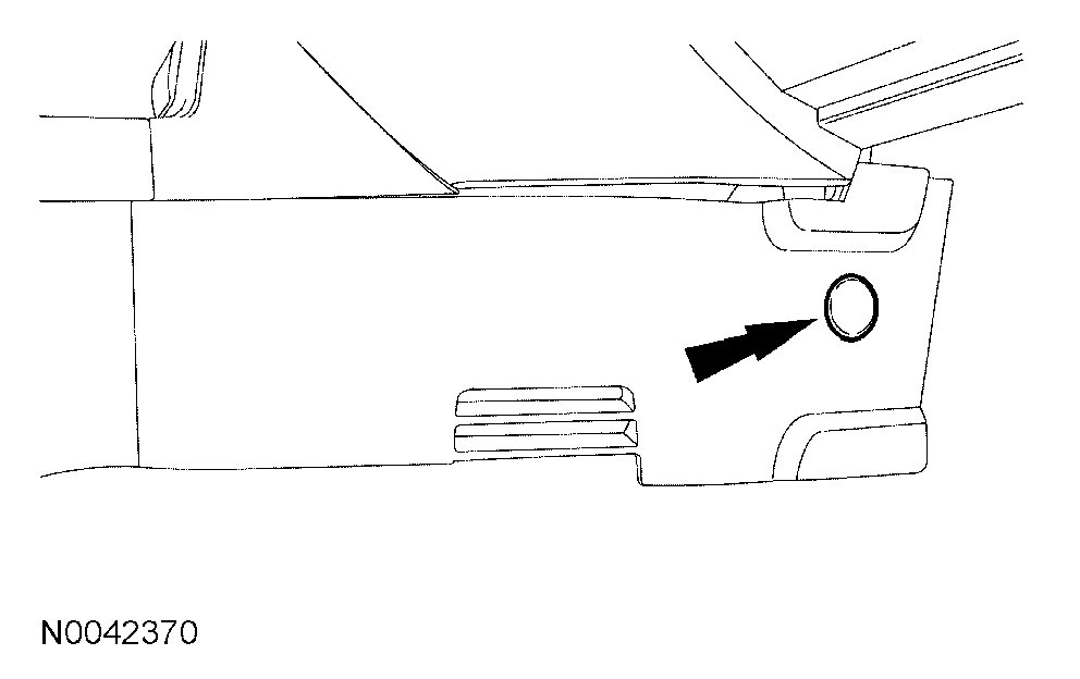

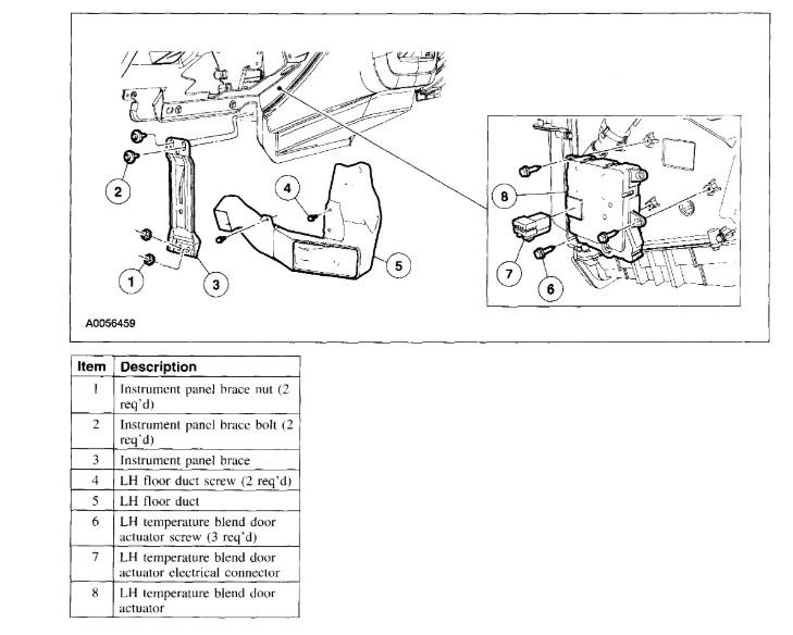

1. Remove the LH floor console finish panel. See: Console > Removal and Replacement
Picture 4
2. Position the in-vehicle temperature sensor aspirator hose away from the LH temperature blend door actuator.
3. Remove the 3 LH temperature blend door actuator screws.
4. Disconnect the LH temperature blend door actuator electrical connector.
5. Remove the LH temperature blend door actuator.
6. To install, reverse the removal procedure.

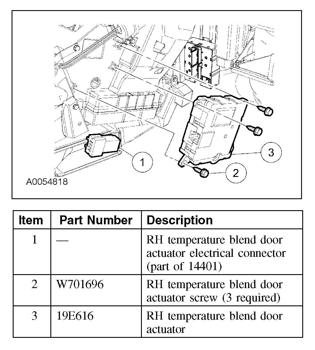

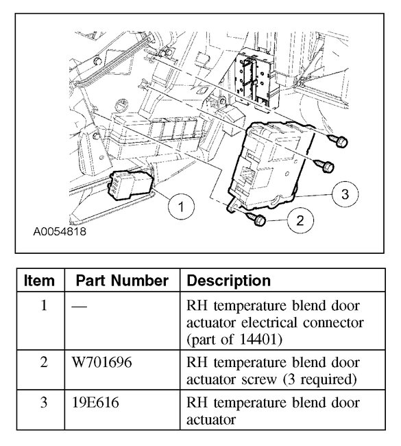

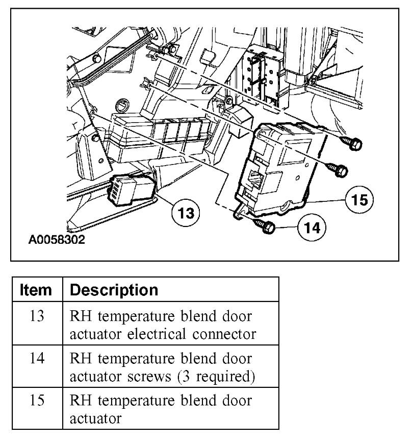

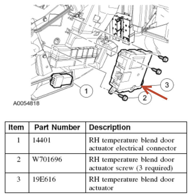

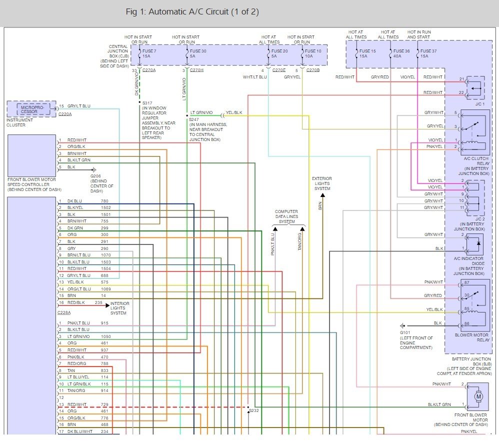

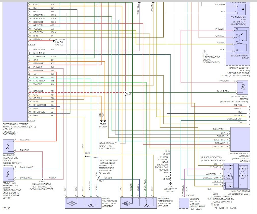

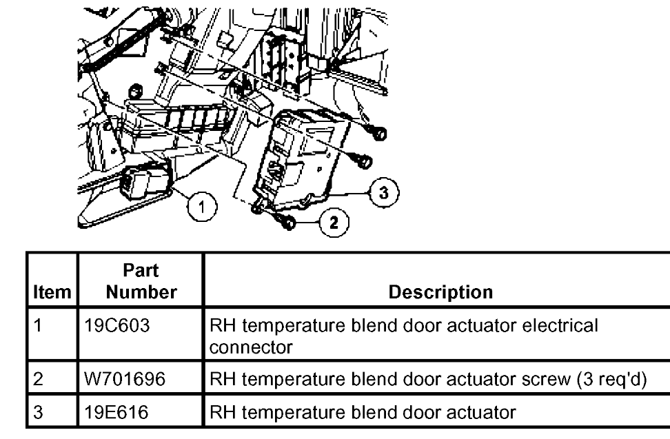

TEMPERATURE BLEND DOOR ACTUATOR - RH, EATC
Picture 5
1. Remove the RH floor console finish panel. See: Console > Removal and Replacement
Picture 6
2. Lower the glove compartment.
3. Disconnect the RH temperature blend door actuator electrical connector.
4. Remove the 3 RH temperature blend door actuator screws.
5. Remove the RH temperature blend door actuator.

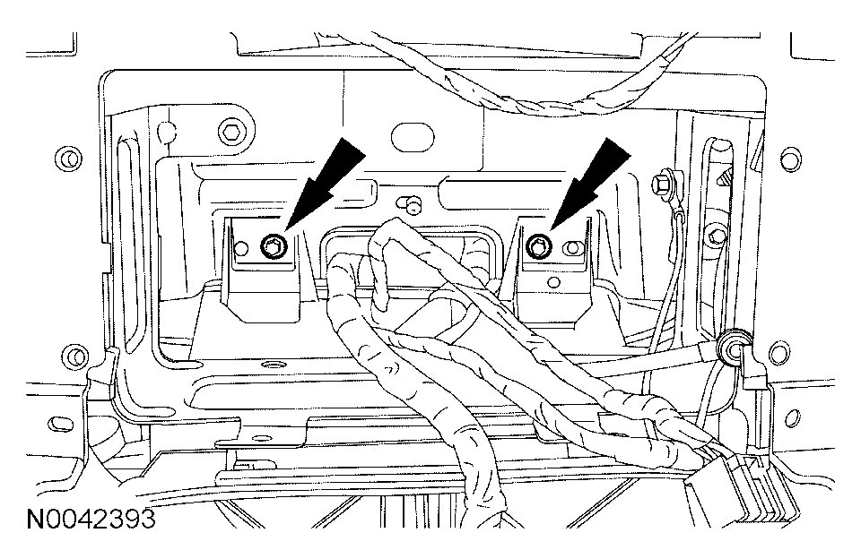

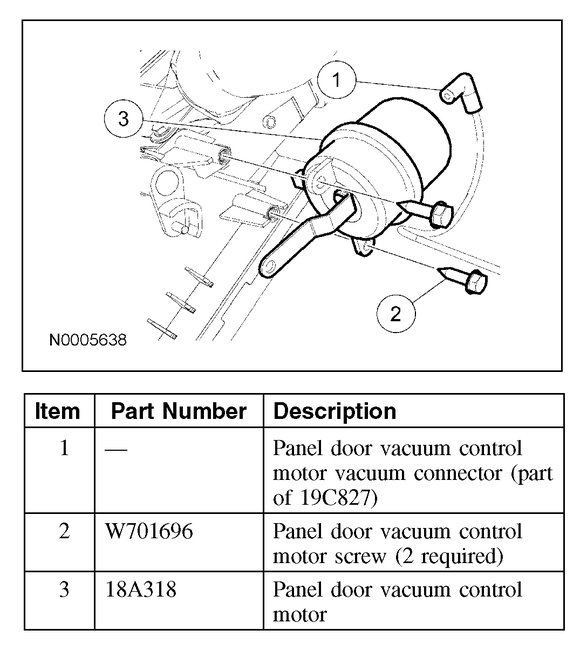

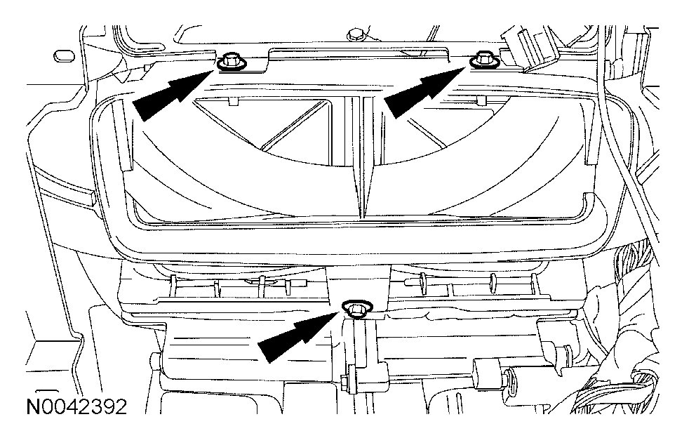

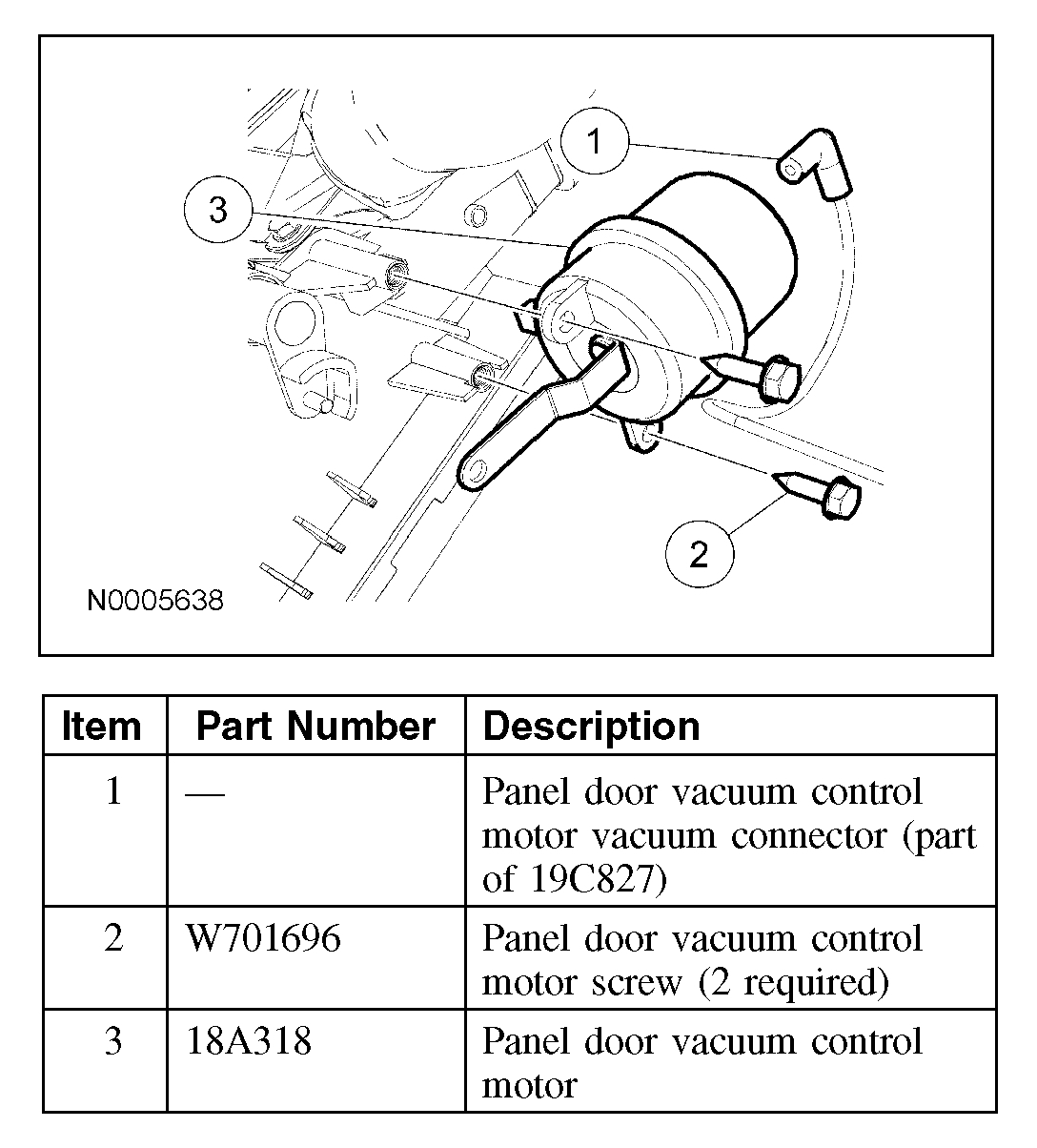

One last thing. You indicate the air flow is only defrost or lower. The air flow via the vents is controlled by a vacuum motor. Either there is no vacuum to it, something is disconnected, or the vacuum motor has failed.
Here are the directions for replacing it.
VACUUM CONTROL MOTOR - PANEL DOOR
Picture 7
1. Remove the audio control module (ACM).
3. Remove the 3 center panel duct screws and position the center panel duct aside.
Picture 8
4. Remove the 2 plenum chamber screws.
Picture 9
5. Disconnect the panel door vacuum control motor vacuum connector.
6. Remove the 2 panel door vacuum control motor screws.
7. NOTE: The plenum chamber must be slightly repositioned to allow the panel door vacuum control motor to be rotated far enough to clear the retaining arm.
Rotate the panel door vacuum control motor until it clears the retaining arm and remove the panel door vacuum control motor.
8. To install, reverse the removal procedure.

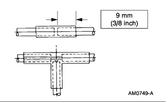

The vacuum tee is also called a mini-Tube. Here is the repair procedure if this is what you are talking about?
Measure the length of the damaged area of the mini-tube vacuum hose.
Cut a piece of standard 1/8 inch inner diameter vacuum hose approximately 25 mm (1 inch longer than the damaged area of the mini-tube vacuum hose).
Cut off the mini-tube vacuum hose on each side of the damaged area.
WARNING: Read the warning information on the product label to prevent possible personal injury.
Dip the mini-tube hose ends in commercially available paint thinner containing methyl ethyl ketone (MEK). This solvent will seal the mini-tube in the vacuum hose.
Insert the ends of the mini-tube vacuum hose approximately 9 mm (3/8 inch) into the ends of the standard 1/8 inch repair vacuum hose.
Shake the repair joint after assembly to make sure the solvent is dispersed and the vacuum line is not plugged.
Test the system for a vacuum leak in the repair area.
Use the Vacuum Pump or equivalent.

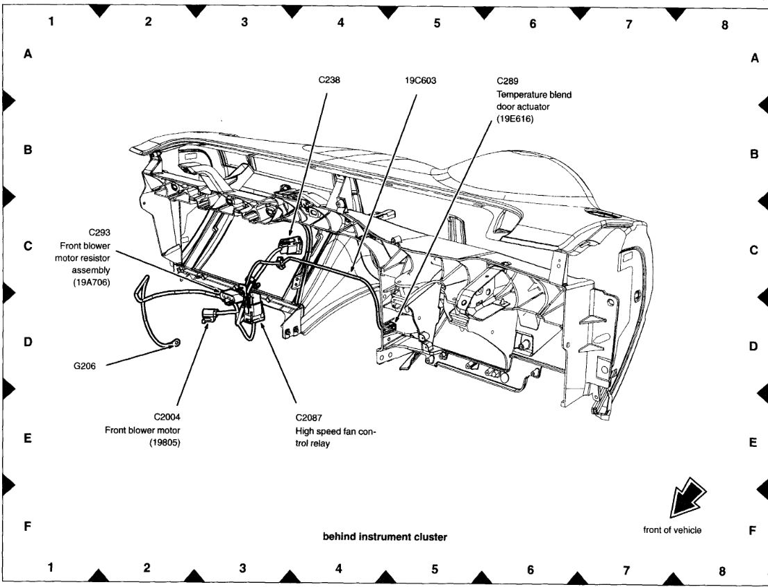

  • 55,399 POSTS
Hey JGAULIEN,
There is a blower motor speed controller that has probably gone out, here is a wiring diagram and guide so you can do some testing.
and
Please run some tests and get back to us so we can continue helping you.
Best, Ken

The heat is not working it makes a clicking sound when u turn it on. And the clicking sound is coming from the middle blower in the front in between the driver and passager. The one's that r by the radio
Jul 21, 2020 at 4:52 AM (Merged)
HMAC300
  • 48,601 POSTS
it's probably the actuator is broken or not moivng the piece inside the heater box. you'll have to check to see if it's working. if the actuator works then tehheater box has to be torn apart to fix the broken vent piece. chek c number 1 on chart.
