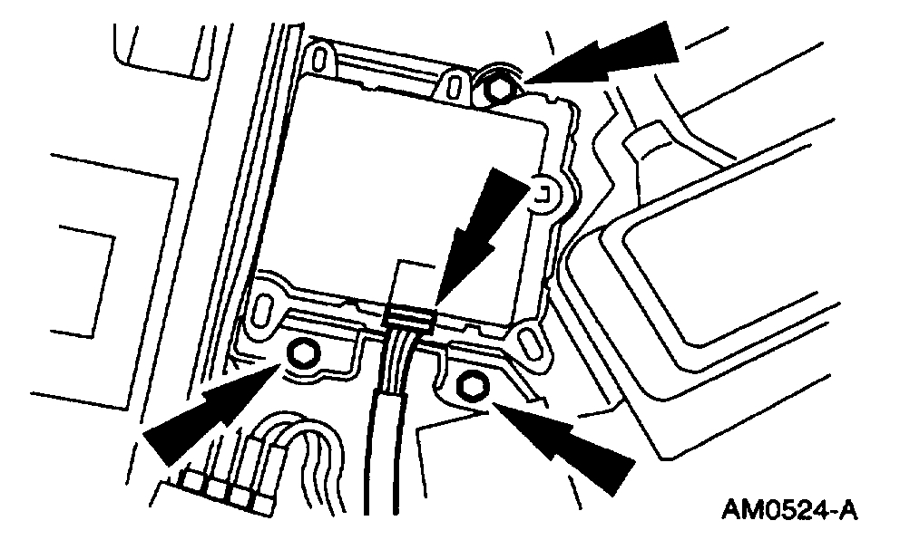

Here are the directions for replacing it. Before you just replace it, confirm it isn't moving when you change from cold to hot. The attached pics correlate with the directions.
__________________________________________________
1999 Ford Truck Ranger 4WD V6-3.0L VIN U
Blend Door Motor
Vehicle Heating and Air Conditioning Air Door Actuator / Motor Service and Repair Procedures Blend Door Motor
BLEND DOOR MOTOR
REMOVAL
1. Remove the instrument panel (dash board).
pic 1
2. Remove the A/C electronic door actuator motor.
- Remove the screws.
- Disconnect the harness connector and remove the A/C electronic door actuator motor.

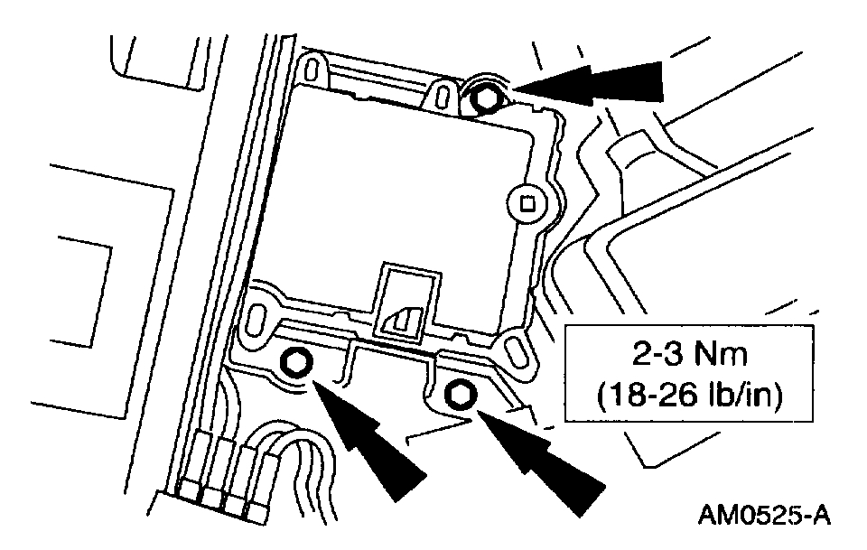

INSTALLATION
pic 2
1. Follow the removal procedure in reverse order.

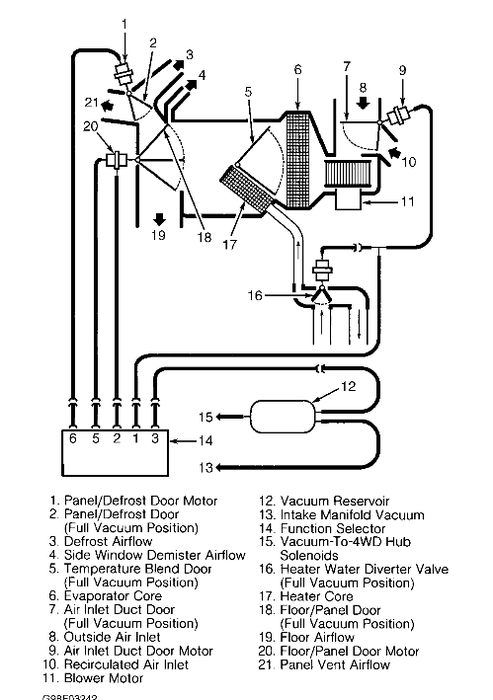

check both hoses for being hot if they are check actutator in heater also check for vacuum leaks, diagram attached
