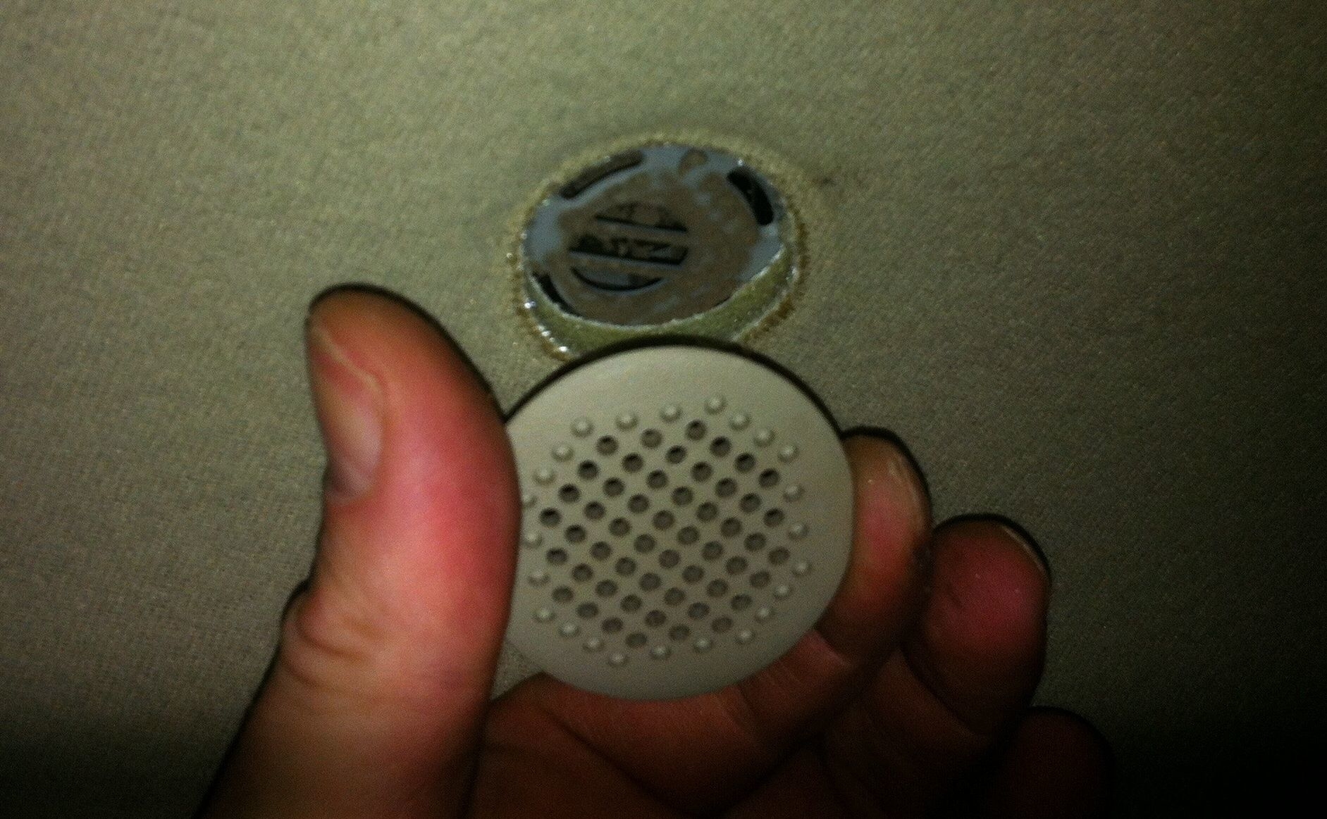

Actually the problem is likely a failed sensor. It is telling the HVAC controller that the interior temperature of your truck is already over 86 degrees.
One of the common ones that fail and cause this is the internal cabin temperature sensor, it is the thing that looks like a speaker in the headliner over the drivers door.
It has a tiny fan and a thermister inside. They suck in crud and it makes them fail.
You replace it by removing the interior windshield trim on the left side, the center pillar trim and handle and then the left side sunshade. Then you gently pull the headliner down. You will see the sensor. Disconnect the wiring connector and then the interior grill comes off.
ACDELCO # 22834330

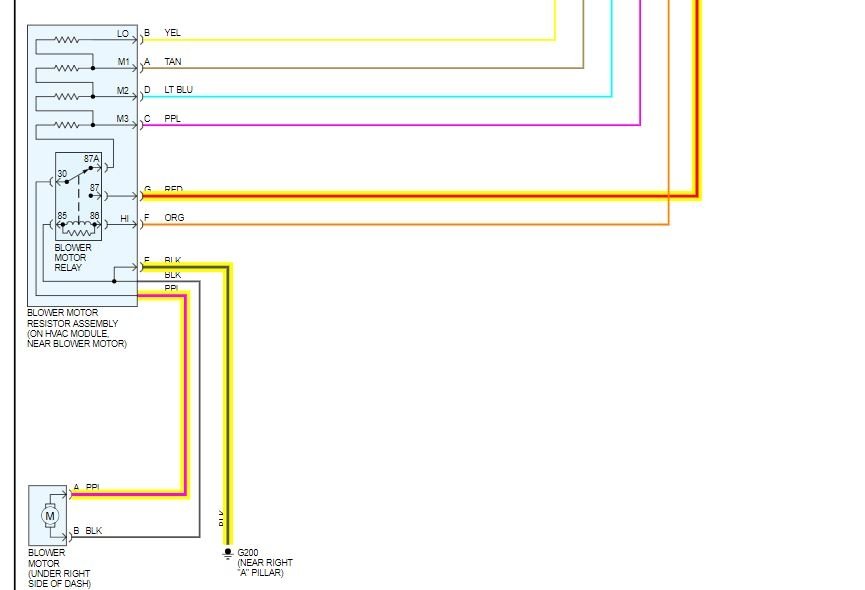

BILL REAVER
Joe,
Thank you for your quick reply.

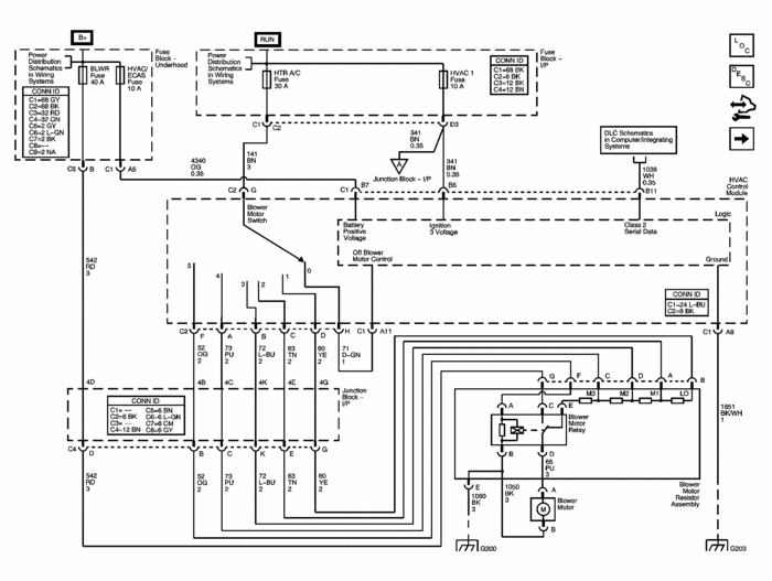

Where would I look for the vacuum lines under the dash? When I look under the dash no vacuum lines are visable. If it was a vacuum leak wouldent the the engine be running rough? There's no roughness that I notice.
Also a few monthe ago I was running the a/c heater blower on high speed when I started noticing a (electrical) burning smell, then it quit. The blower works on all other ranges but just not on the high speed. Could this be the resistor? where would I find the resistor.
Bill
Dec 26, 2020 at 6:39 AM (Merged)
  • 110,244 POSTS

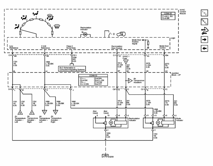

I have attached schematics for you to review. The GMC model uses electric and not vacuum for some reason. Review the schematics to see if you can identify where to check under the dash. Also, as far as the high speed, it believe it is a relay rather than the resister. See schematic.

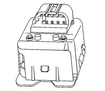

check to see if your actuators are getting power or not. you may have a control head going bad. Also cleant eh battery cable ends as it may be making poor contact until you get more revs going to put a better charge int ehbattery. You might also check your battery , most auto parts stores can do this for free. i've included a generic pic of actuators.

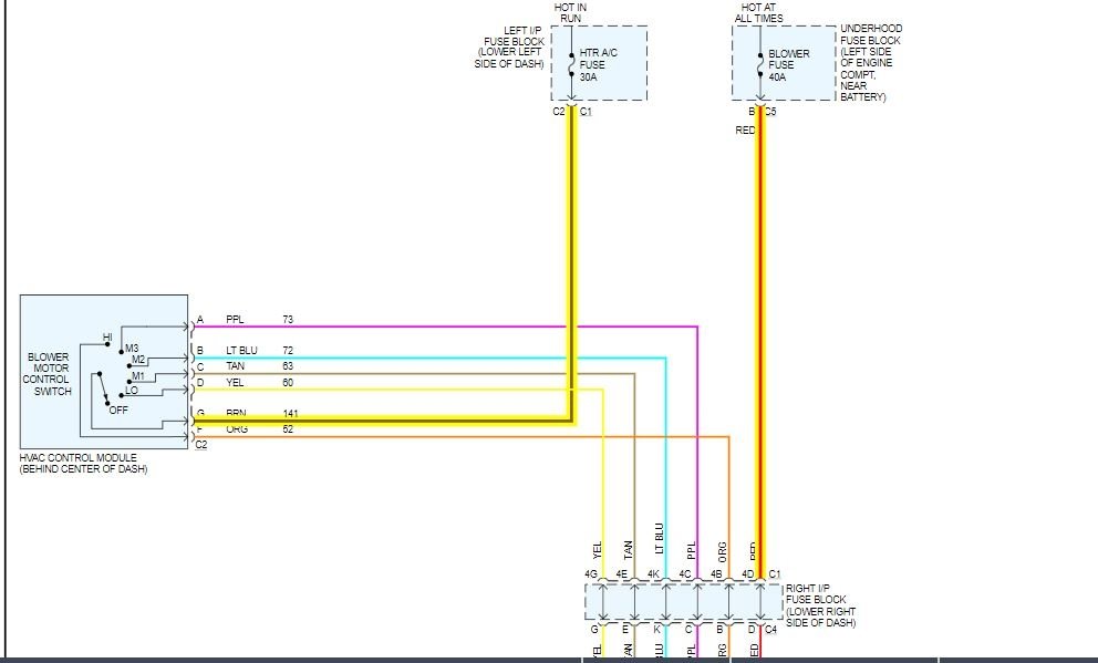

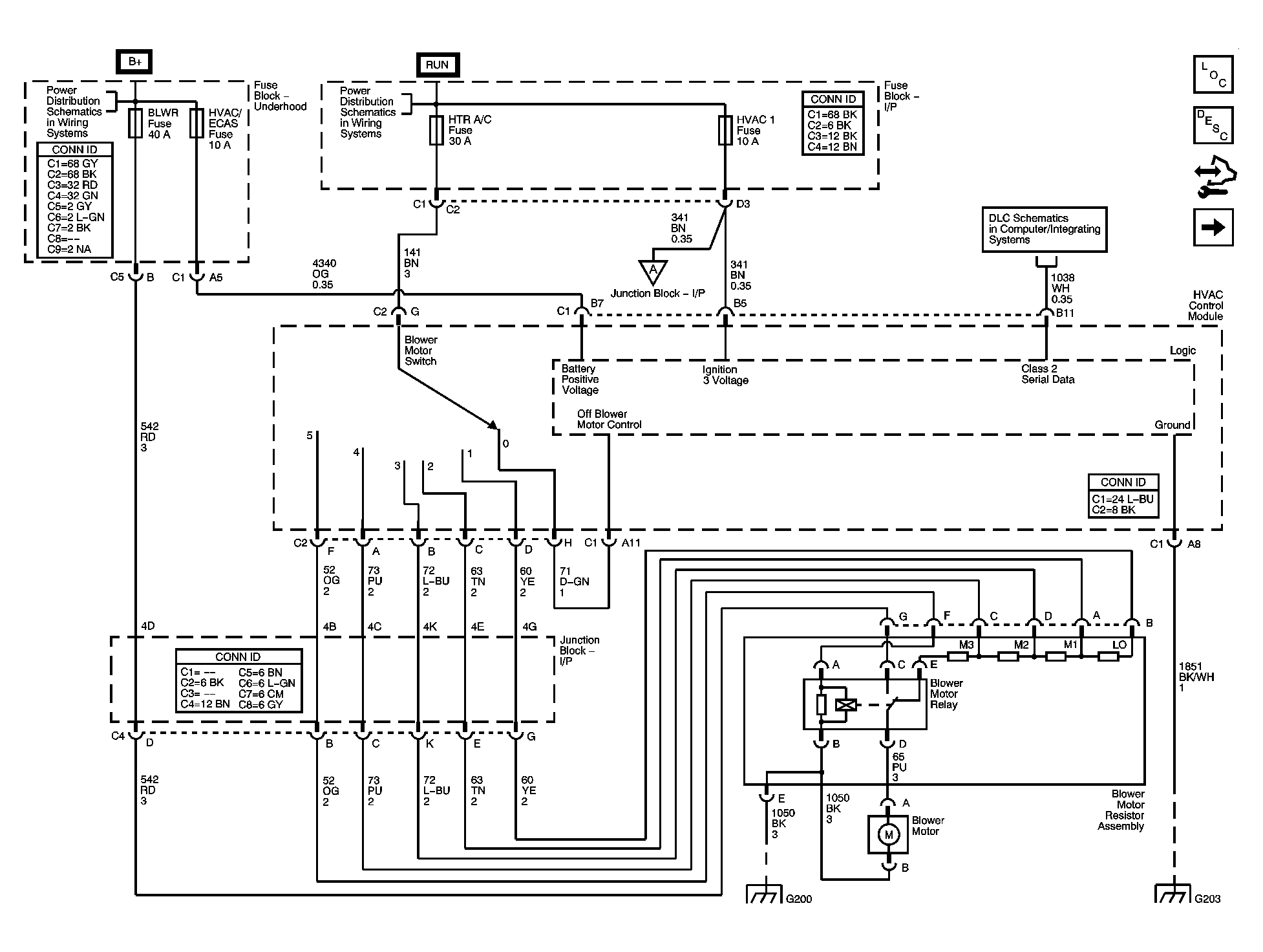

RAYRAY66SIX

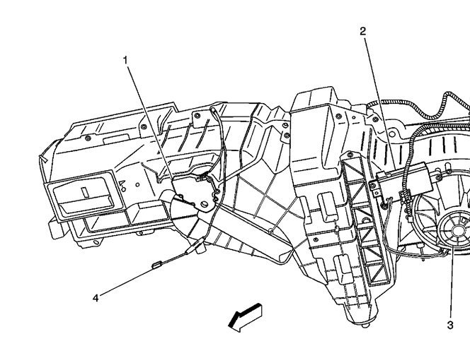

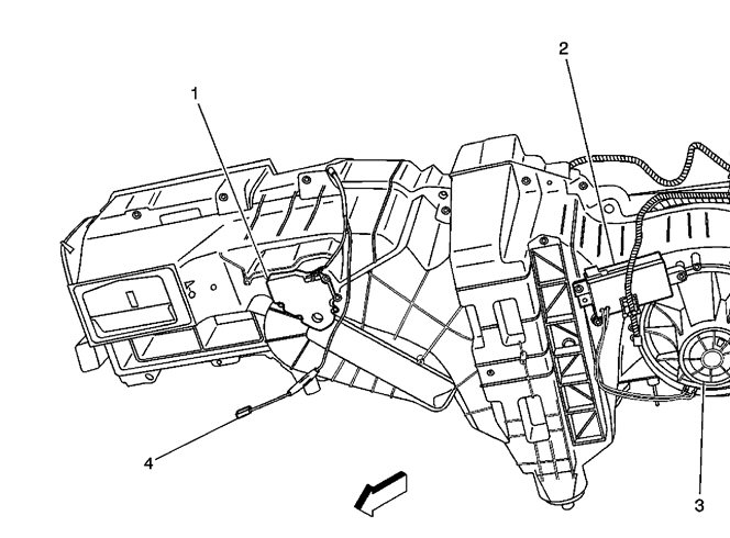

I have no heat and no blowing from the vents at all in my truck. changed the blower motor, still nothing. checked all the fuses and stuff, still nothing. got a brand new control module still nothing. got a new blower motor resistor still nothing, thought maybe the new resistor was faulty exchanged it for another, still nothing. There is power at the plug that plugs into the resistor, but it doesn't seem to be traveling through the resistor to the blower motor. like when i would test the resister plug there is no power, but the plug that plugs into the resistor has 11.8 volts power. anyone have some idea of what could be happening?
Dec 26, 2020 at 6:41 AM (Merged)
Good morning,

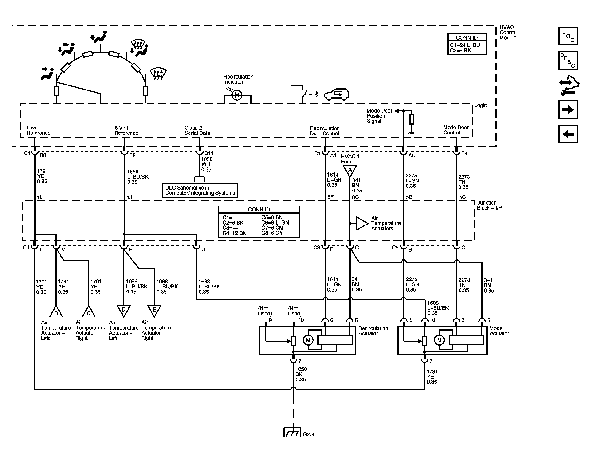

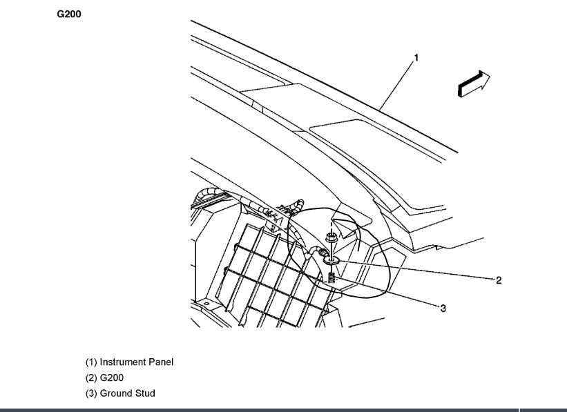

I attached a wiring diagram for you. Check the second fuse for power to the fan switch.
Then go to the resistor and see if you have power when commanding fan speeds. You should have power in each fan speed selection. If you have it, then check the ground for the resistor. I attached the location of the ground.
If you do not have power, then the fan switch is bad.
