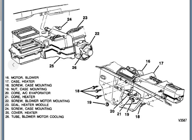

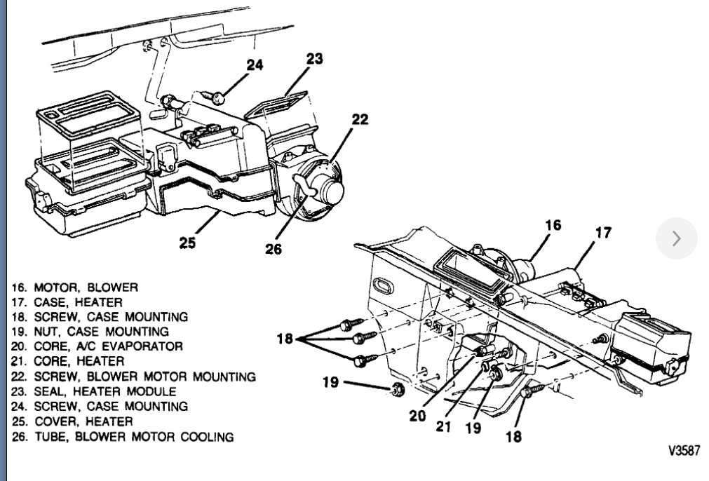

hello, i was wondering where my heater core is located and how to change it out?
Jan 11, 2010 at 9:45 AM

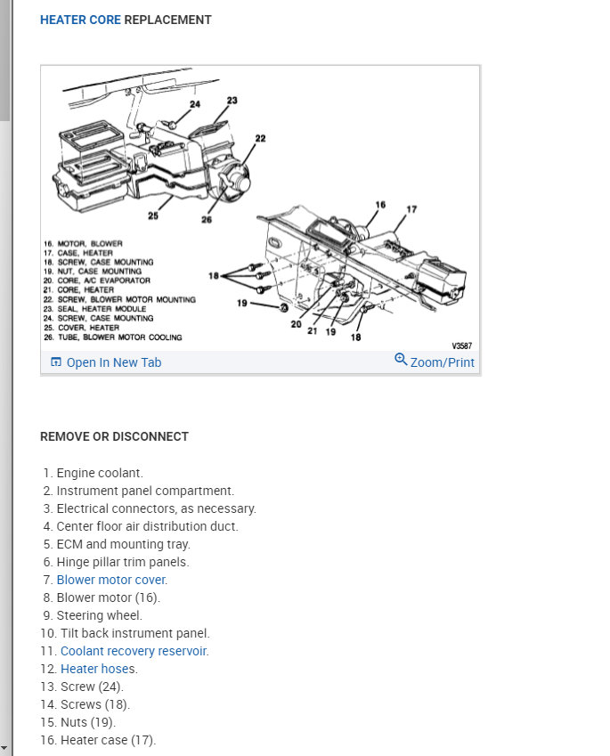

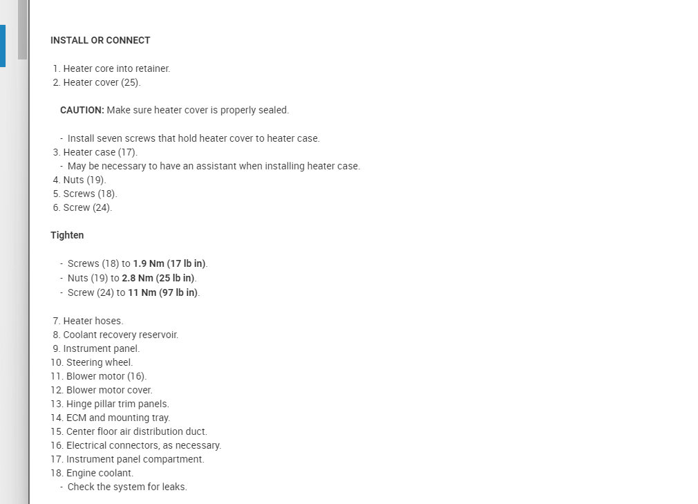

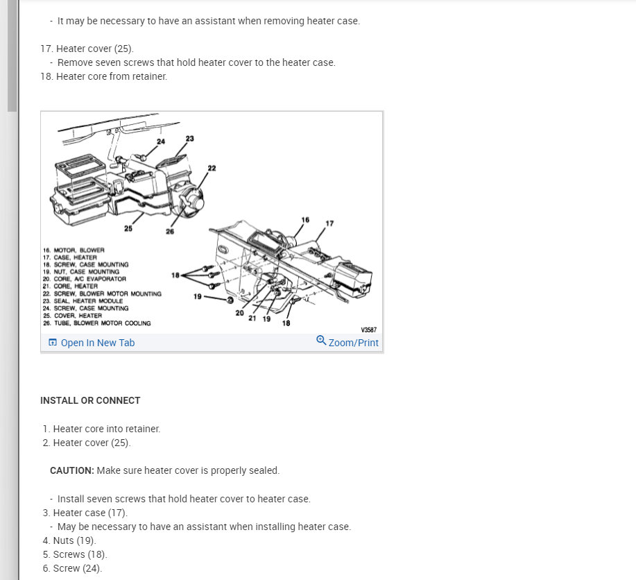

The heater core is located in the dash, and I am going to attach the detail on how to replace this.
Here is a guide that will help with this as well since the manual is not that detailed:
https://www.2carpros.com/articles/replace-heater-core
Please run through this info and let us know what questions you have, and we can go from there. Thanks
