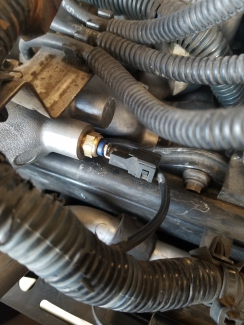

I had my water pump changed out last fall, then in the spring all of sudden the heater gauge started to go right up to high when I have only had truck running a short time. I have now changed the thermostat, the coolant sensor. I drove for a few days and the gauge keeps going up to max and then eventually will come back to normal. I finally took it in for coolant flush thinking I must have a blockage but shortly after driving away from garage the gauge went to high again. It seems when I shut off truck then restart the gauge goes right up to hot but will eventually come back to normal. Does anyone else have suggestions on what is going on?

Hey piperjerky,
So it looks like there are separate temperature sensors for the engine management and the instrument cluster.
On the sensor you replaced were there two wires or one?
The one for the gauge has just a yellow/red wire to it. It grounds through the engine.
Where as the coolant temperature sensor for the ECM has two wires. One black and one light green/red. It has its own ground.
Let me know which one you replaced and try and locate the single wire sensor if you changed the other one.
Should be at the top of the engine on the front.
Regards, Joe

This is the sensor I have replaced:

Hey piperjerky,
That does look like a single wire going to that sensor.
To be sure, can you pull back that outer wiring casing and tell me how many wires and what color they are please.

Yes it is only one wire going to that sensor.
