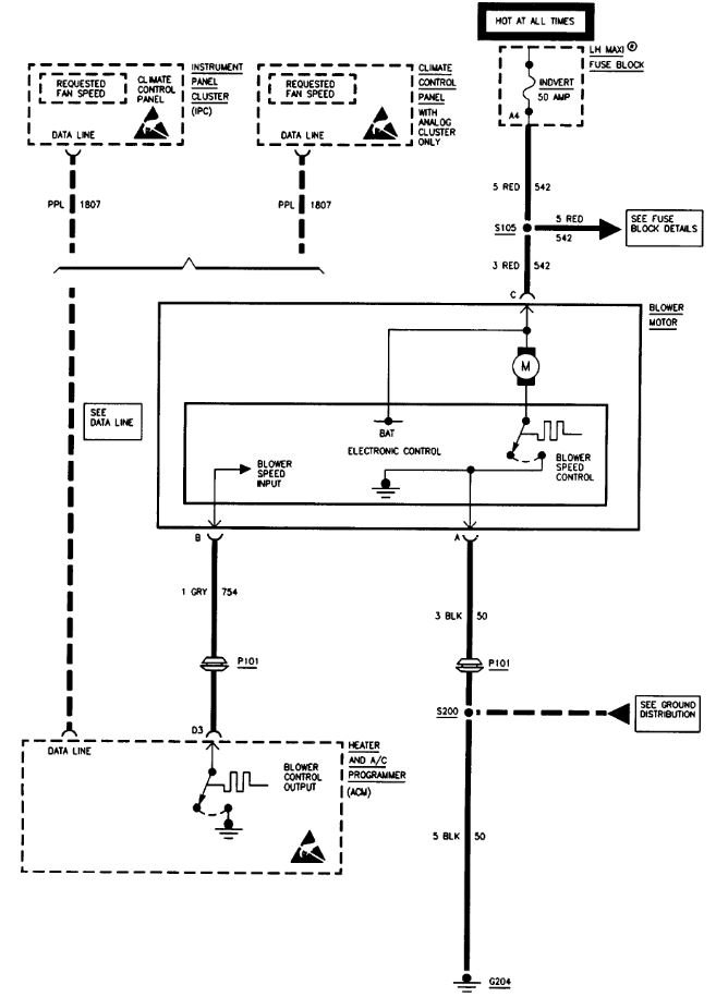

The heater fan runs all the time even when the key is removed. i looked for a heater fan relay, but could not find one. had to unplug the fan motor to keep it from running the battery down. any help or fixes would be great.

Hello, There is no relay or individual blower fuse on that model. The blower itself has the control module built into it and just has a power a ground and the control wire in the connection. To determine if it is the control head or the blower motor at fault requires a scan tool that can control the fan and command it to the various speeds.
Current dealer pricing on that motor is about $300.00 to $500.00 while you can get an aftermarket for under $100.00. GM 52494108. So a used or new unit might be cheaper to use for testing than a shop. You can just plug it in and see if it works, if so it's the blower electronics. If not then it is the control head.
