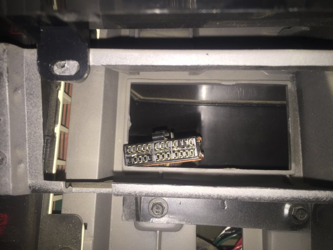

The other day I was driving around when I went to switch my heater from defrost to feet and body then switch it to high and as soon as I hit the high button the whole display shut off. I have checked the fuse and that is okay, but I was told by a friend it might be a control box kind of deal that went out. I am just trying to find somebody that has had this problem and knows the fix.
Additional information:
The heater has always seemed weak in low and medium setting I have not owned this truck long so this is my first winter with it.
I have also tried disconnecting the battery to try to reset the controller still no power to the unit.

Check instrument panel fuse. Do the dash lights operate?

yes, lights work and fuse is good.

I found something I did not see before. The fuses in my instrument panel are not all the right sizes. I have a thirty in the heater/air conditioner spot instead of a twenty five and others are the same, I am going to get those corrected now.

No still no display on the heater unit

Do you have a DVOM? Can you remove control head and do some voltage tests. I can help through it

I've got the meter and control disconnected

The 3 on the top left and the top and bottom far right are hot

Then it is not an electrical issue so looks like control module is faulty
