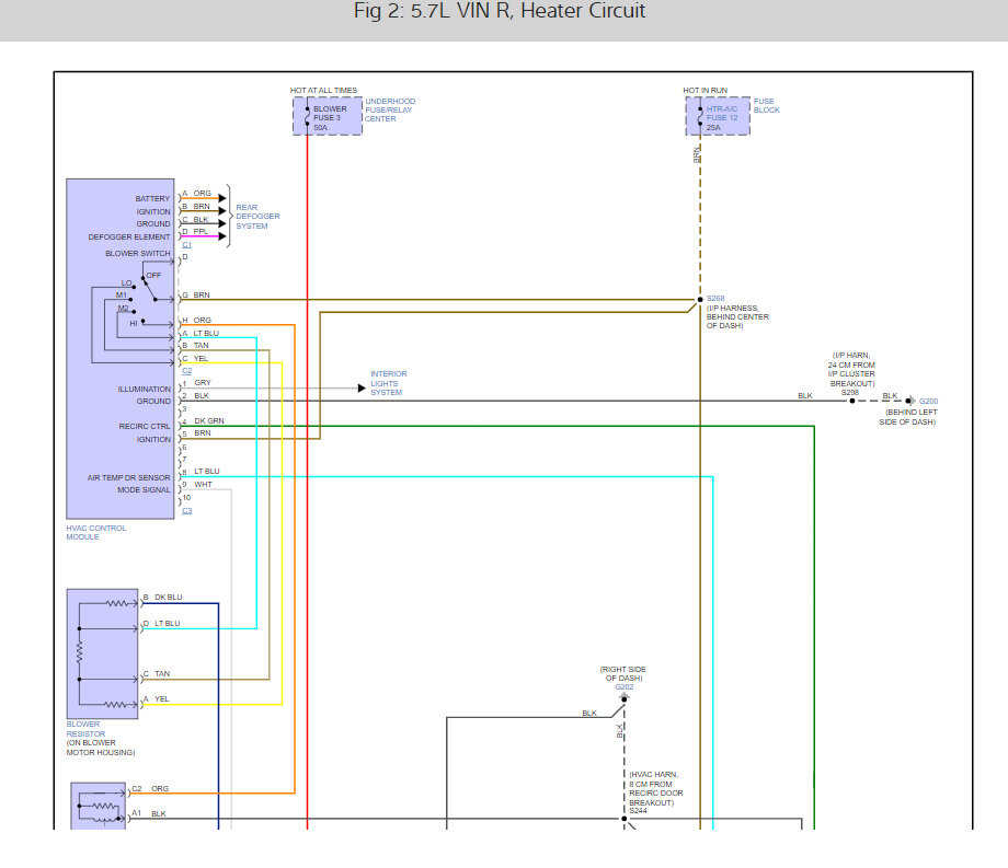

Heater Control not working?
1999 GMC YUKON
126,000 MILES • 5.7L • V8 • 4WD • AUTOMATIC
YOURMAMA1975
I just recently had my dash apart for a separate reason. The vehicle listed above is an SLT. I replaced the heater core and heater fan because they were bad. All wires plugged in. The problem is, my blend and heat/cold control knobs, recirculating button and A/C buttons do not work. The fan control does work. It feels like it is blowing about 60° to 70°when on and engine is warm. Could this be the heater control panel itself? I'm getting ready to order one, but I would like an expert's advice because I can always return it if it's something else. Any help would be greatly appreciated. Thank you

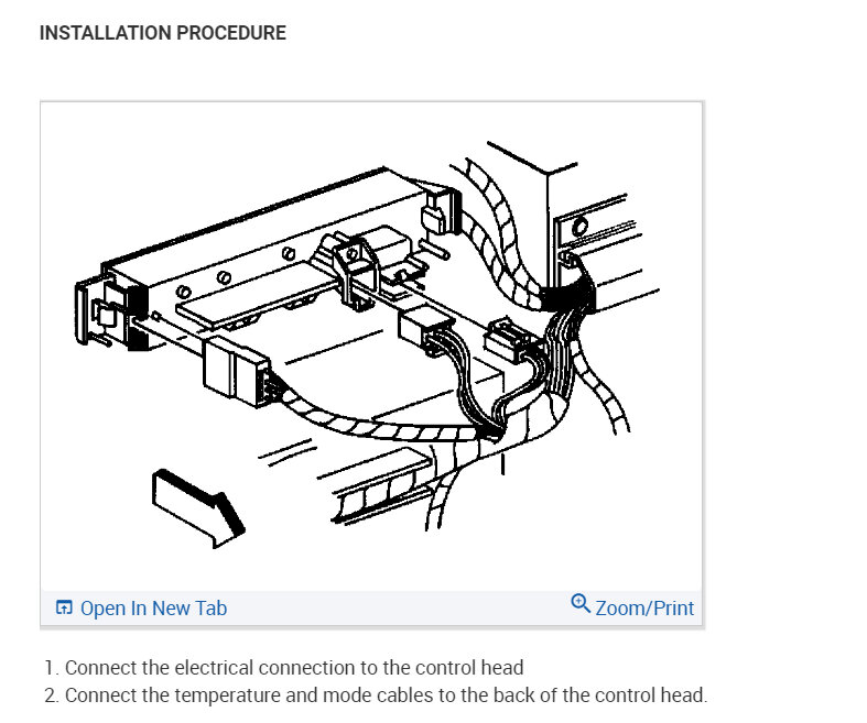

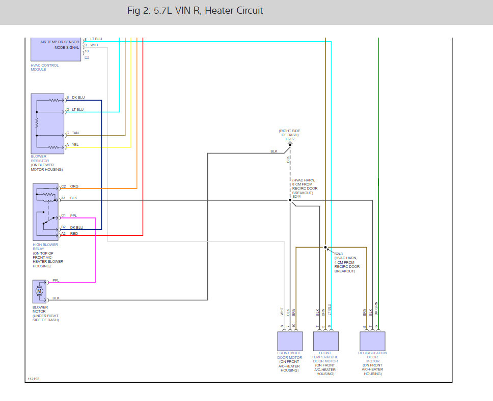

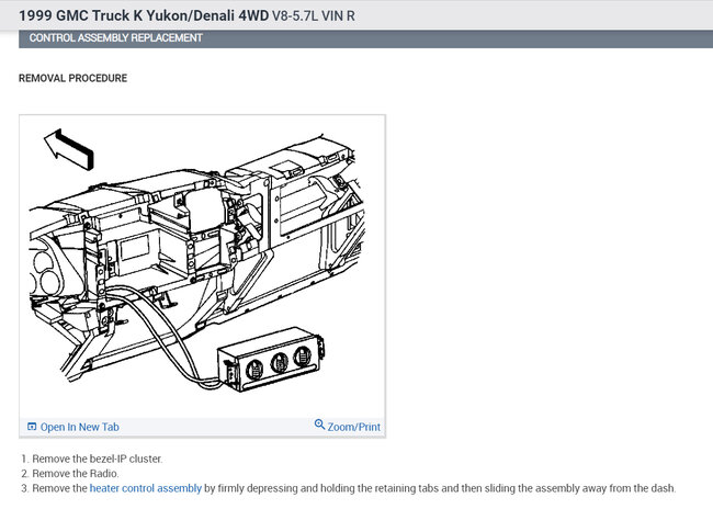

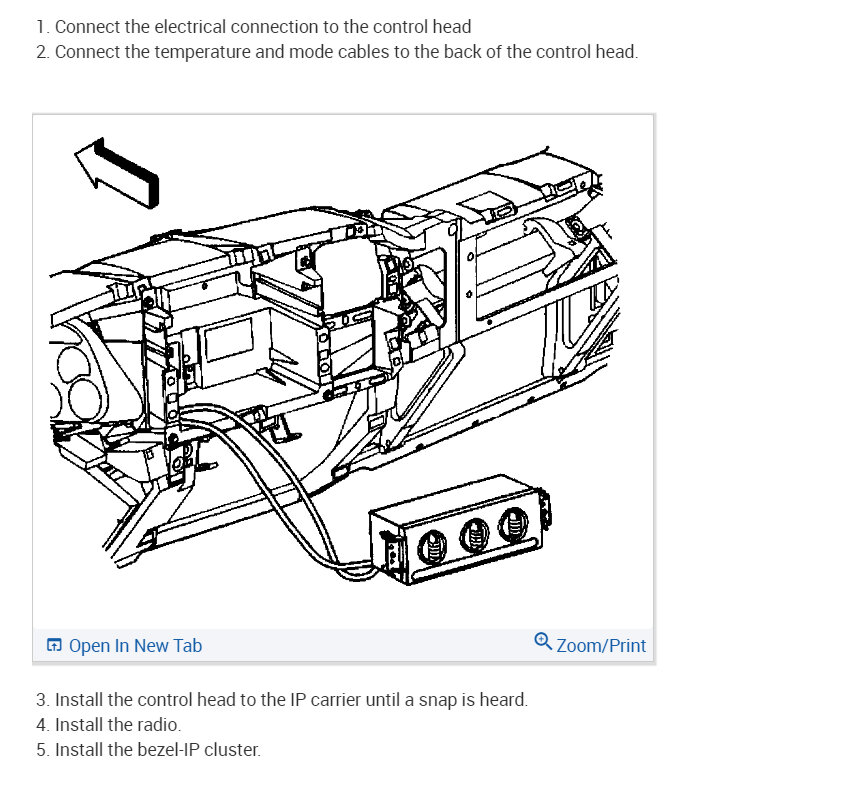

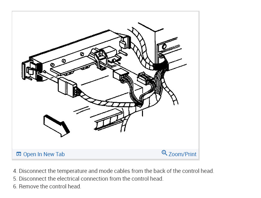

It could be the HVAC control module, but we should check the G202 ground on the right side of the dash. Also check the fuse #12 for power. here is a guide to help and the climate control wiring diagrams so you can see how the system works:
Also included is how to change out the HVAC controller in case you need it. Check out the images (below). Please let us know what happens.
