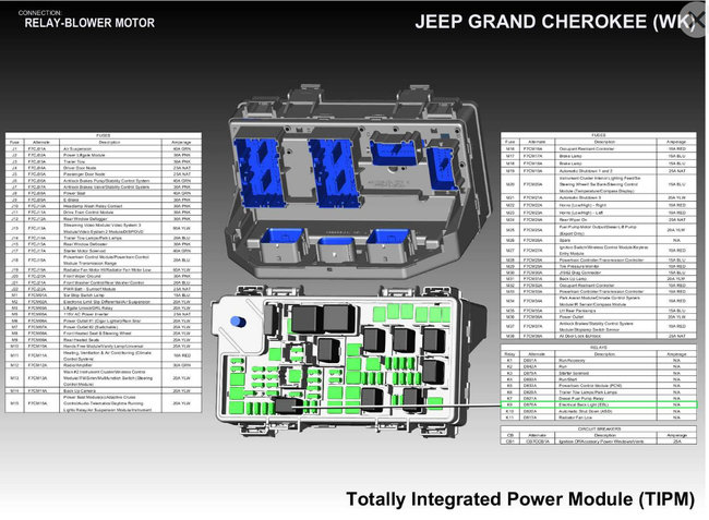

No power to the resistor and no power to the blower motor. I replaced the resistor, that wasn't it.
Sep 11, 2021 at 3:44 AM
SQM
  • 6,383 POSTS
Have you checked the blower relay under the hood in the fuse box (TIPM)?
Since you are not getting power to the motor then you either have a bad relay or wiring or faulty switch.
Do a visual inspection of the relay for nay corrosion or burnt pin(s).
You can also test it as well.
Please let me know what you find.
