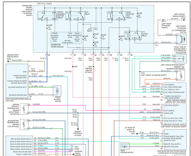

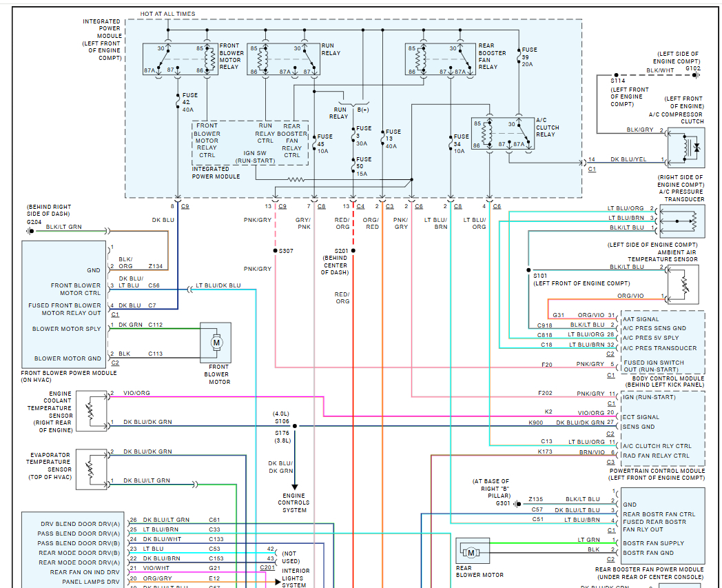

Heater/ac display not working blower not working fuse are good and the relays are good I am out of ideas?

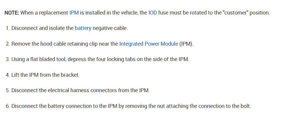

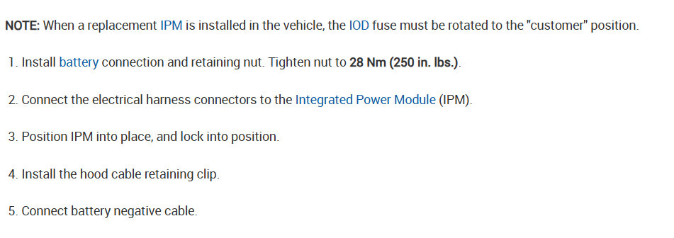

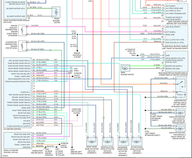

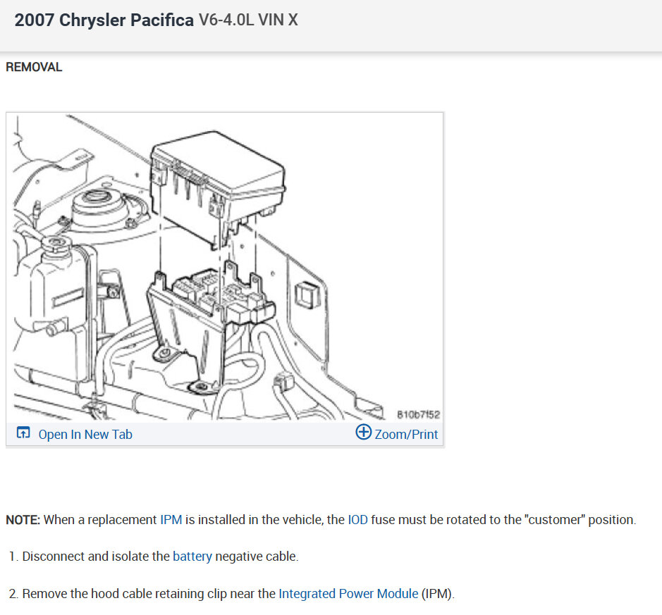

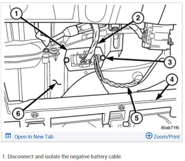

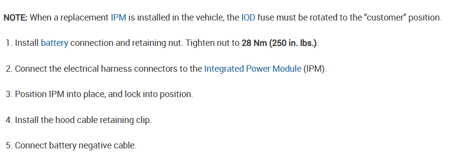

It sounds like the IPM has gone out (integrated power module) to be sure here is the wiring diagrams for the system, I would check for power at the Dr/Blu wire going to the front blower control module with the system on high fan speed and if not power is present I would replace the IPM which is a common problem with these cars. Here is a guide so you can check for power, and I have included how to change out the IPM as well which is easy because it-self learns so there is no programming.
