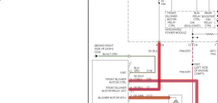

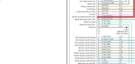

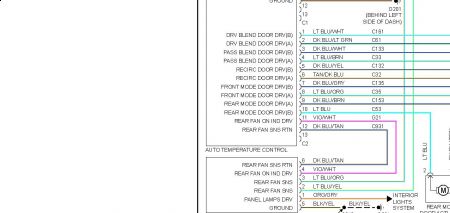

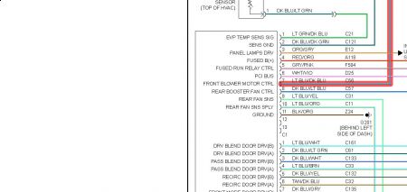

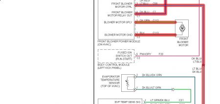

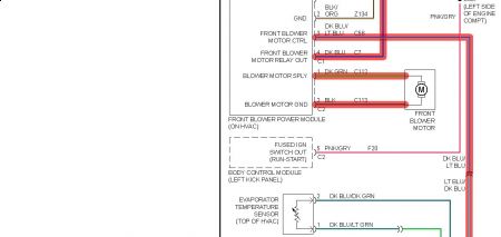

The front fan blower doesn't work on any of the speeds. The "hi auto" or "lo auto" don't work when selected. The fuse fan blower fuse is good. Different temperatures can be selected.
Jan 29, 2010 at 3:53 PM
  • 75,992 POSTS
Hi winnie5851, Welcome to 2carpros and TY for the donation Check fuse no.42 40amp in the integrated power module in left front of engine compartment if okay swap or test the front blower motor relay the same location. If both above okay -test the front blower module and the automatic temperature control. See below front blower circuitry EWD
