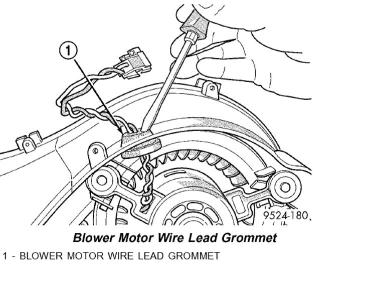

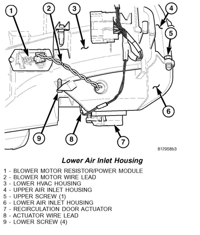

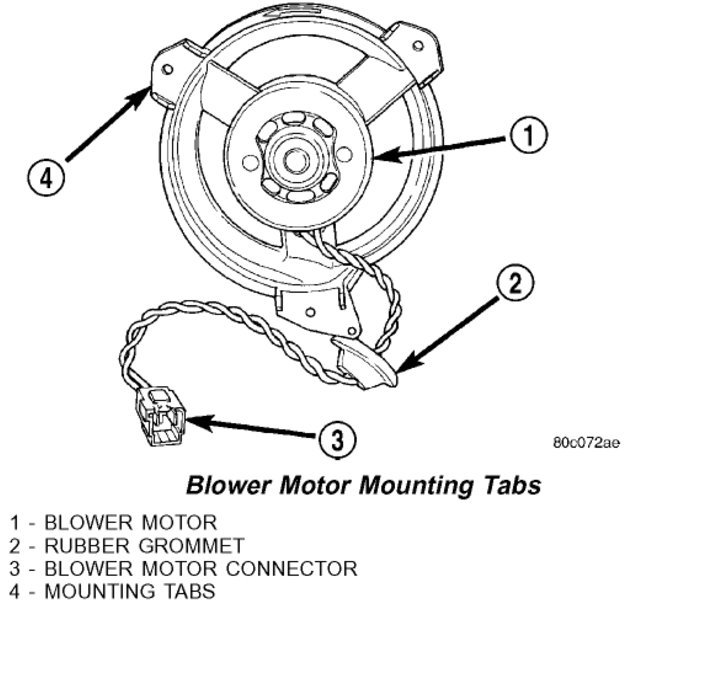

fan makes very loud squealing sometimes. How do I access it to grease or replace?
Jun 8, 2017 at 11:55 AM
  • 55,433 POSTS
Its best to replace the motor once is starts making noise but you can try to lubricate it. Here is a guide that will show you what you are in for when doing the job and some diagrams (below) to help you get the job done.
