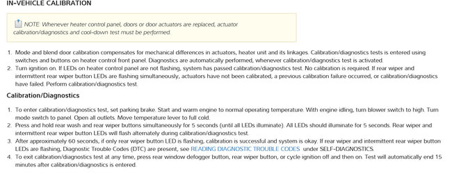

Takes for ever for the heater to heat up even when the engine is warm.
Mar 23, 2017 at 9:35 PM
HMAC300
  • 48,601 POSTS
do what is in the pic to try to re-calibrate the temperature actuator otherwise it may be bad causing the no heat problem.

well guys i figured it out, it was a combination of a couple things, after taking a good look under the hood touching hoses for heat i noticed little rusty splashes down by the lower radiator hose so i checked radiator level by removing the cap- even though the reservoir was full of pure green coolant and had never moved above the half way mark on the temp gauge i seen no water in radiator so i filled radiator and of course heater worked perfect so further investigation i disconnected over flow tube at the cap and blew through it or at least tried to ha it was pinched off behind the grill so i straightened it out and whoola the flow was clear , now i i checked for leaks and the radiator is the culprit its leaking around the tank at the cores barely a noticeable seepage. going to purchase a radiator now , thanks for all the input it did get me under the hood again which put me in the right direction, thanks again for your help.

It was the first thing we say in this guide.
Maybe we can get this guide to you sooner next time.
