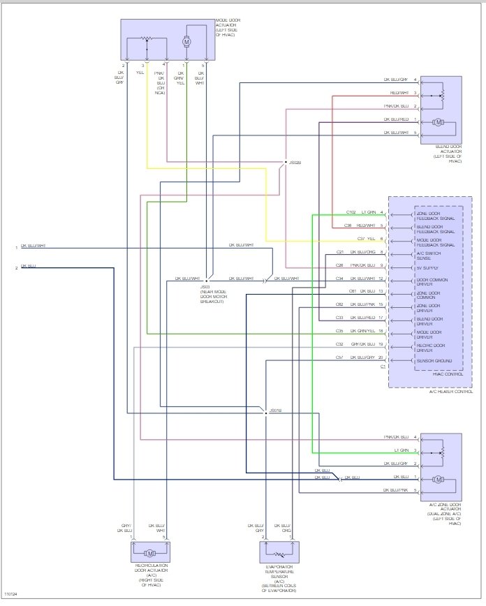

Air only comes out at the defrost vents. No change with replacement of control panel or recalibration of unit.

Is there engine vacuum to the control panel? The defroster is the default if there is an issue. If engine vacuum is not getting to the system, the vents cannot change air flow direction.

It sounds like a blend door actuator is bad on the left side of the heater box, here is a diagram and guide to help you
Let me know what you find
