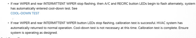

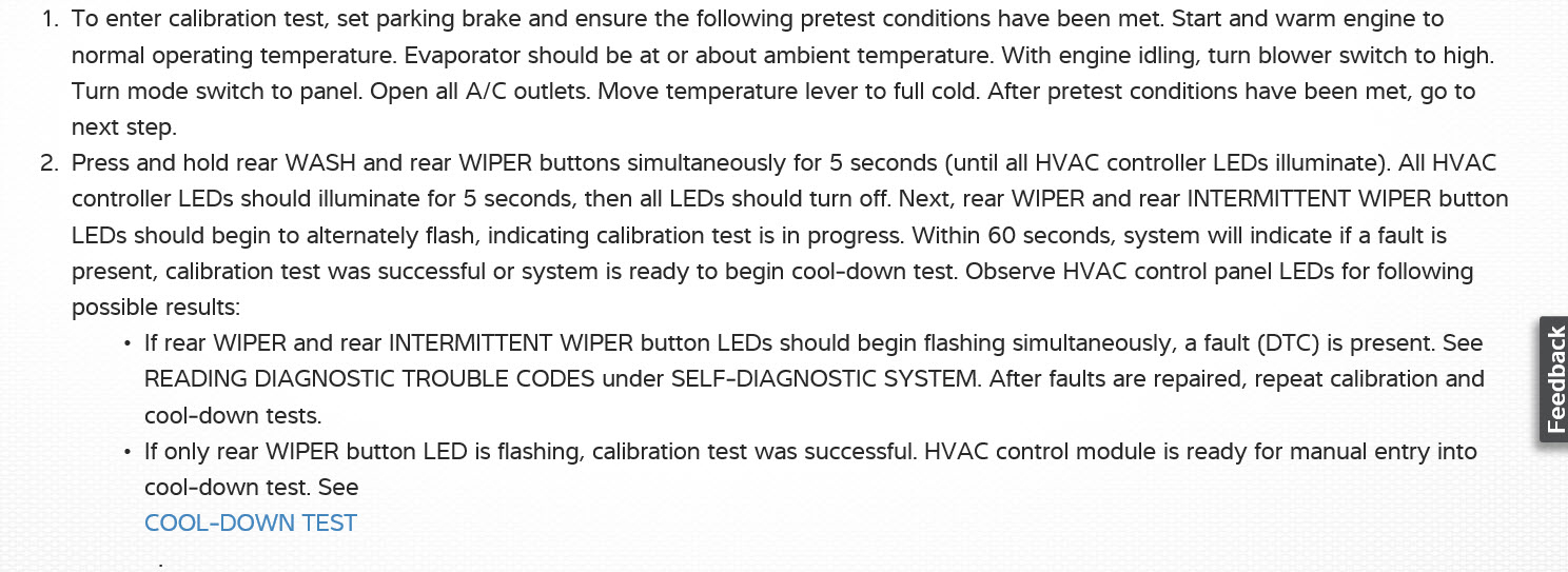

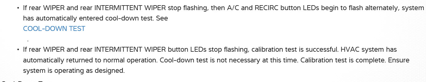

Air only comes out at the defrost vents. No change with replacement of control panel or re-calibration of unit.

you can try reprogramming but you may have a bad mode door actuator or broken door. to fix the actuator the dash must be pulled. see pictures for calibration since you replaced control panel.
