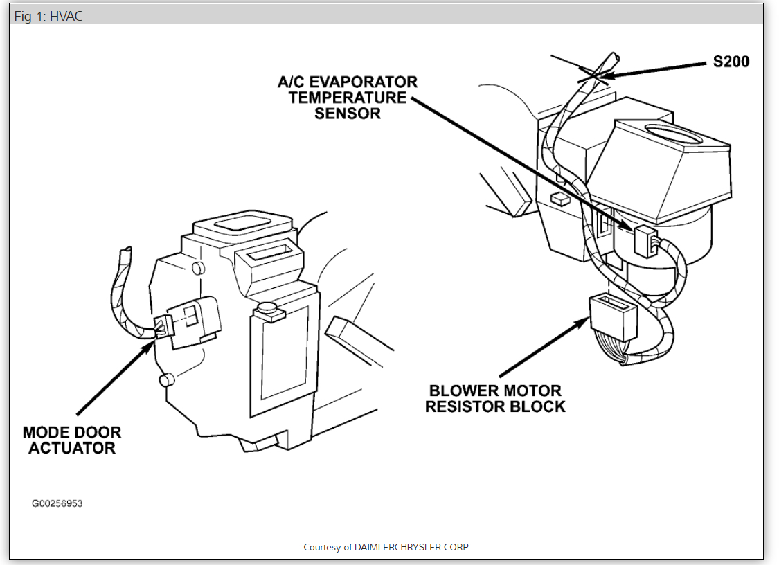

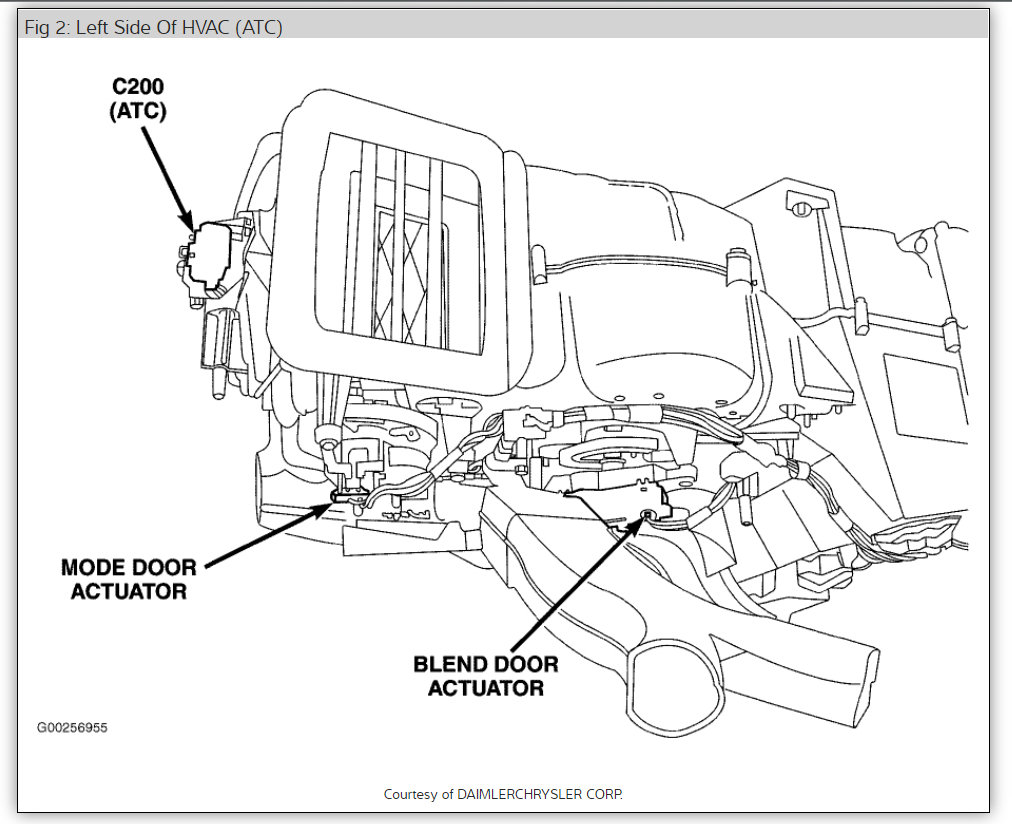

Heat only comes out of defrost vents only.
Feb 14, 2018 at 11:11 AM
  • 54,832 POSTS
It sounds like you have a mode actuator that is not working. Here is a guide to help you see what you are in for when replacing the part:
Here is the location of the mode door actuator on your car. Try Amazon or Rock Auto for the part.
