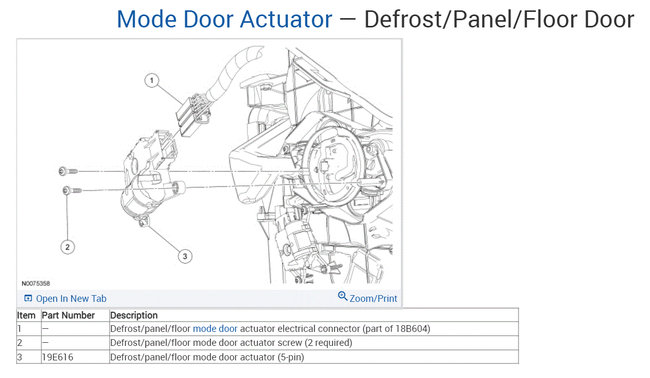

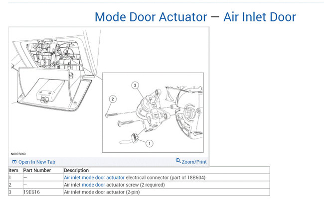

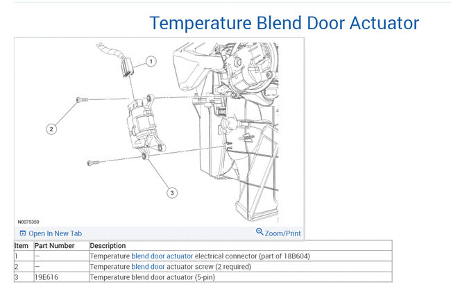

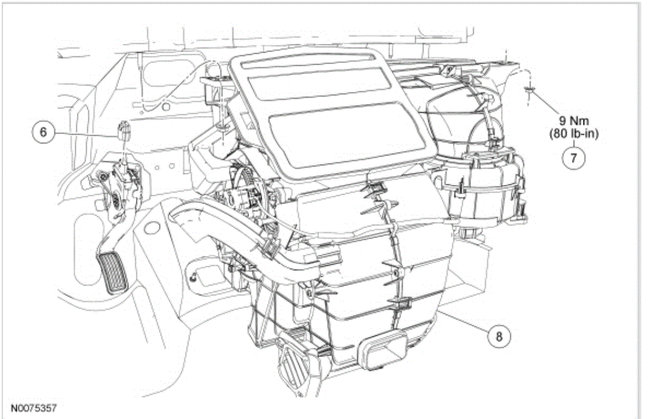

  • 109,921 POSTS
There are a total of three actuators. One is for the temperature, one for airflow direction, and one is a fresh air actuator. I attached pics below of their locations.
Since the airflow actuator is working properly, pull the fresh air door and see if manually moving the door changes the temperature in any way.
Monday, March 7th, 2022 AT 5:46 PM
JB140CENTRAL
  • 8 POSTS
I will check the air inlet door actuator because the other doors seem to be working. Thanks, I will let you know.
