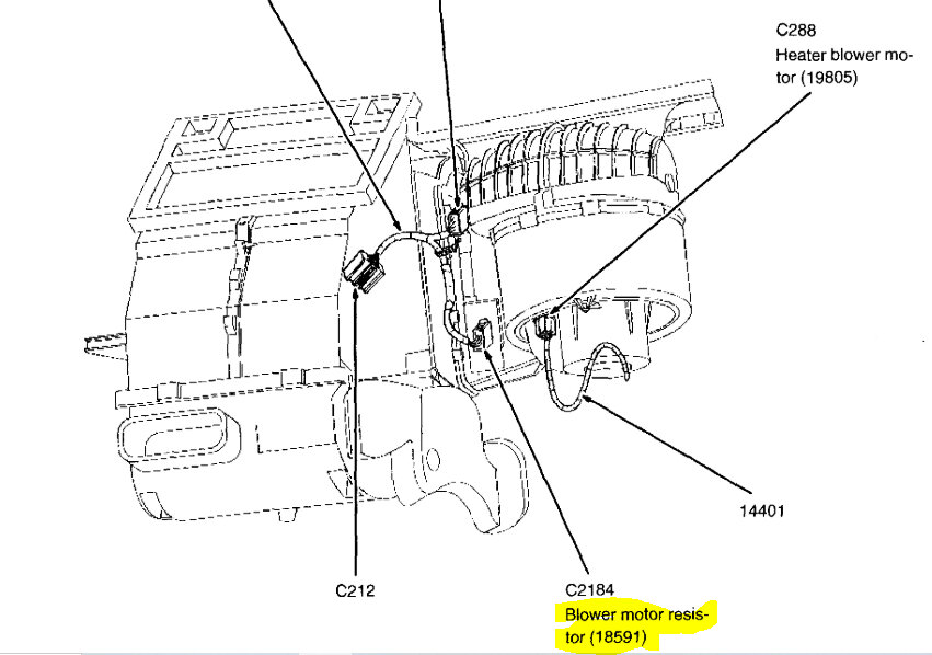

my vehicle fan only comes on when on No4. is this a motor problem or switch problem and how do I remedy it?

If the blower motor only operates in the highest position, in most cases the blower motor resister has failed. First, take a look through this link. If it mirrors what you are experiencing, I would replace the resister. I attached a picture below showing its location. Also, link two below will explain in general how to replace it. Note: It will be located under the dash on the passenger side of the vehicle.
https://www.2carpros.com/articles/blower-fan-motor-works-on-high-speed-only
https://www.2carpros.com/articles/replacing-an-automotive-hvac-blower-fan-motor-speed-controller-resistor
Let me know if this helps or if you have questions,
See pic below
