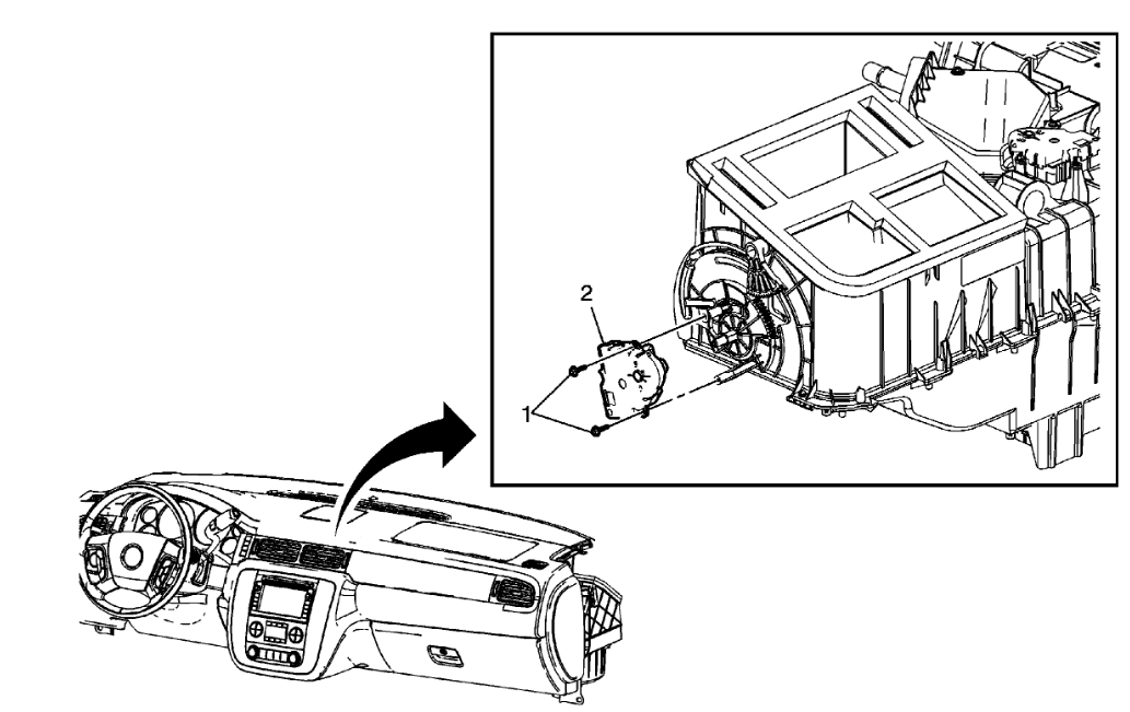

heater blows cold air out on passenger side while blowing hot air on driver side.

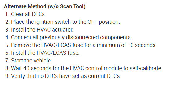

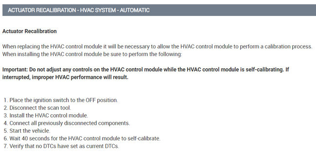

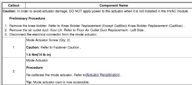

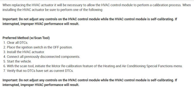

It sounds like you are having an issue with the mode-blend door actuator. It is a small small electric motor that opens a door to send air flow throughout the HVAC unit to direct airflow. Here is a tutorial showing what is involved for its replacement:
I've attached picture steps below for your vehicle. This is based on the automatic HVAC system since you didn't specify in in your post. I've also included the steps to recalibrate the actuator after installation. Hope this helps and thanks for using 2CarPros.
