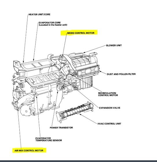

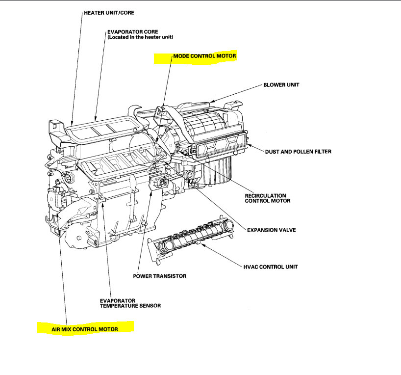

This is an interesting issue because the when you increase the temp, the blend air door actuator is what should react. When you change direction of air flow, there is a different actuator which should respond, the mode door actuator. I think what we should start with is the mode door actuator. What I would like you to do is disconnect it and see if changing the temperature still has an affect on air flow direction. If it does, then we will need to inspect the mode door itself.
The mode actuator is located on the HVAC box under the dash. If you look at the attached picture, I highlighted both the mode door actuator and blend air door (air mix) actuator. You can see they are not close. That is what is causing me confusion.
Regardless, if we find air flow changes after the mode is disconnected, we will have to inspect the door and make sure nothing is loose or disconnected.

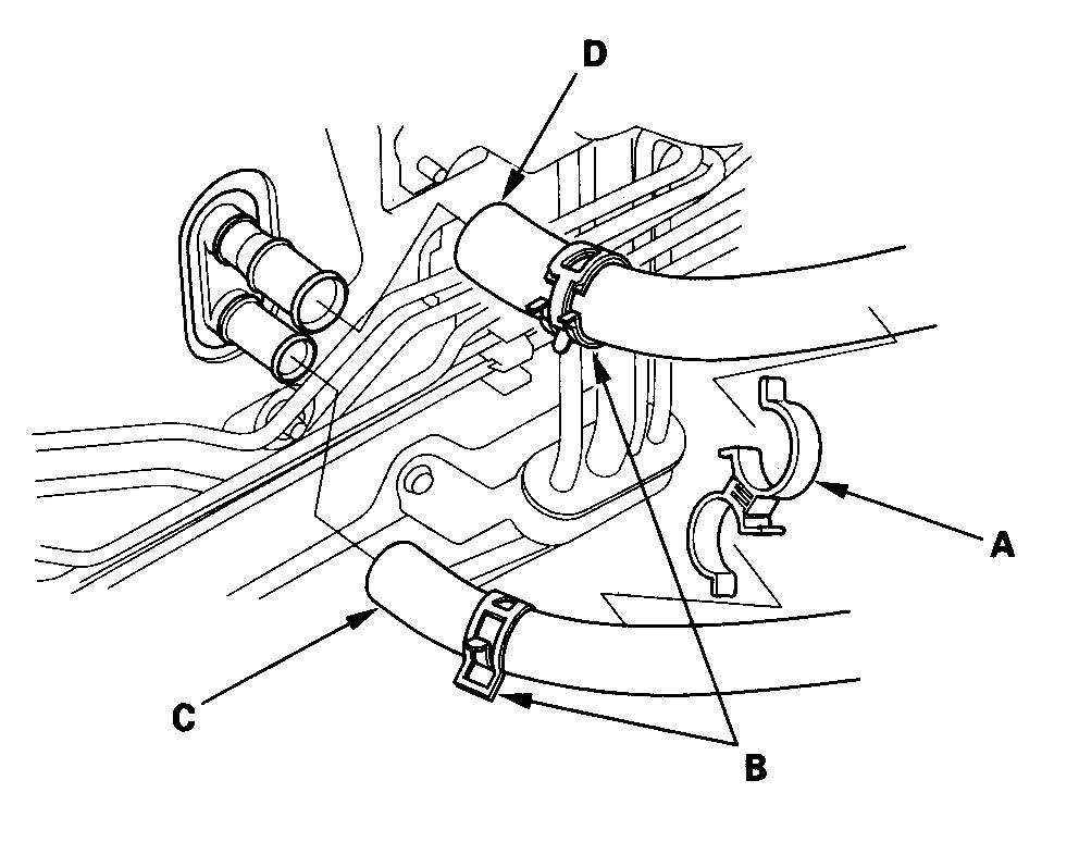

I can't quite read the RO. Are they replacing the heater core or are they going to flush it? I would try flushing it first.

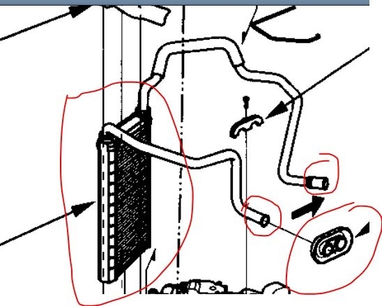

If it is a flush, you can do it. I attached two pictures below. The first one shows the heater hoses and how they connect to the core under the hood at the fire wall. The second pic is an exploded view of the heater core. I circled the core, and the steel hoses which come through the firewall into the engine compartment.
In pic 1, you will see the hoses disconnected. That it the what you have to do, disconnect the hoses. However, you will need to drain the cooling system partially to prevent coolant from leaking when you remove the hoses. You will still have some loss at the hoses, but it should be minimum.
Once coolant is drained in the radiator (about half way down), remove the hoses. At that point, take your garden hose and spray water through one of the two steel lines. Water will come out the other steel hose. Do this until the water is clear.
Next, reverse flush it. Basically, spray the water into the other tube until it is clean. If water comes out easily and is clean, you're done.
Reconnect the hoses and refill the coolant. Once the coolant is full, turn the heater on high and start the engine. Allow it to warm up. It should bleed the air from the system itself. If it doesn't, let me know.
Please let me know if you have questions or need help. Also, let me know if this takes care of the problem. One more thought, I find it a lot easier if I have a piece of heater hose long enough to push on to one of the steel heater core tubes so I can just spray the water into that. It's easier because first, you aren't trying to reach for the heater core tube with your garden hose, and second, it's rubber so it's easier to spray water into it.
If you decide to get the hose, get about a 3 foot section from any parts store. While at the parts store, see if they have any flush products specifically for heater cores. They will have radiator flush, but I question if that will work for this.
Take care and let me know how it goes.

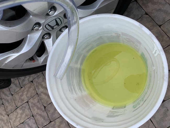

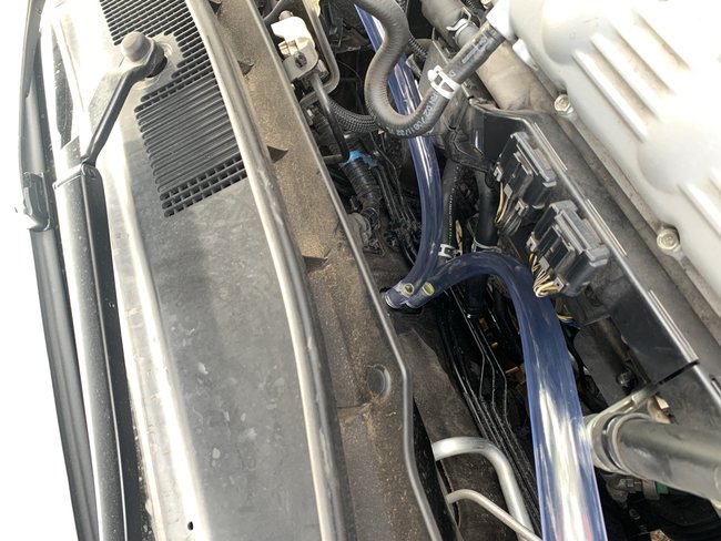

Hey there,
Finally got around to attempt to fix this issue of mine. Bought some clear rubber hose from Lowe's, got some fresh coolant and got started. Man was it a pain in the ass to remove these two heater hoses after removing the clamps, I had to remove that long stabilizer bar on top of the engine in order to have more room for my arms and hands, along with more leverage. As soon as I started flushing the core with my garden hose, I noticed a faint amount of particles flowing out but mostly really light green coolant coming out. I sealed it all up, started the car with the heat on high, and drove around for a bit, I still have no heat.
What gives?
Dec 1, 2020 at 2:46 AM
  • 110,248 POSTS
Wow, that looks really clean. And you have no heat? Were you able to bleed the air from the system? Do both heater core hoses get hot when the engine is warmed up and the heater is on high?
As clean as that is, the core most certainly isn't plugged.

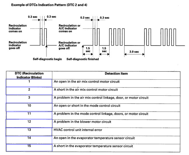

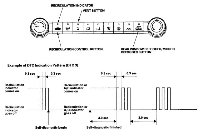

Something has come apart. If you have full air flow and control over the mode door, something isn't allowing the heat to enter. There is only one heater core. If you have heat on one and not the others, it's not a core issue. You have replaced the air temp actuator. I have one more suggestion. Try this self diagnostic test and see if any codes show up.
_______________________________
2008 Honda Accord V6-3.5L
Heating/Air Conditioning
Vehicle Heating and Air Conditioning Testing and Inspection Reading and Clearing Diagnostic Trouble Codes Heating/Air Conditioning
HEATING/AIR CONDITIONING
General Troubleshooting Information
How to Use the Self-diagnostic Function
The HVAC control unit has a self-diagnostic function for heating, ventilation, and air conditioning system. To run the self-diagnostic function, do the following:
1. Turn the ignition switch to LOCK (0) and then to ON (II).
2. Set the FAN CONTROL dial to OFF, the TEMPERATURE CONTROL dial on Max Cool, and select the VENT mode.
3. Turn the ignition switch to LOCK (0) and then to ON (II).
4. Press and hold the RECIRCULATION CONTROL button, then within 10 seconds press and release the REAR WINDOW DEFOGGER/MIRROR DEFOGGER button five times. Release the RECIRCULATION CONTROL button; the recirculation indicator blinks two times, then the self-diagnostic begins.
NOTE:
- The blower motor will run at various speeds when in the self-diagnostic mode.
- If there is any problem in the system after the self-diagnostic function is finished, the recirculation indicator blinks Diagnostic Trouble Code (DTC) 1 through 15. In the case of multiple problems, the recirculation indicator blinks in order with the lowest number DTC repeatedly.
- If no DTCs are found, the indicator does not blink.
pic 1
1 - 15
pic 2
Clear the DTCs
When the problem is repaired, DTCs will automatically clear.
Max Cool Position Function
When the mode control button is in the MAX A/C position, the HVAC control unit will automatically select the recirculation mode and turn the A/C on. If the recirculation switch is pressed when in MAX A/C, MAX A/C turns off. If A/C is pressed when in MAX A/C, the A/C turns off.
_____________________________________________
Let me know what you find

If you had 92 degrees at one point, something is going on in the HVAC box. I want to say mode actuator, but at this point, I would have to remove the assembly and check to see if something is broken, disconnected, not getting power and so on.
Take a look at the pic I attached. It shows both actuators that have been in question. One is the mode door actuator which directs air flow direction. The other is the air temp actuator. At this point, I hate to ask again, but is the manual HVAC or automatic?
If you had 93 degrees at one point, the heater core isn't plugged. You wouldn't be getting heat if it was. Interestingly, if you had them replace the heater core, they would have to remove the HVAC box.
Let me know if you have confirmed both of these actuators are working.

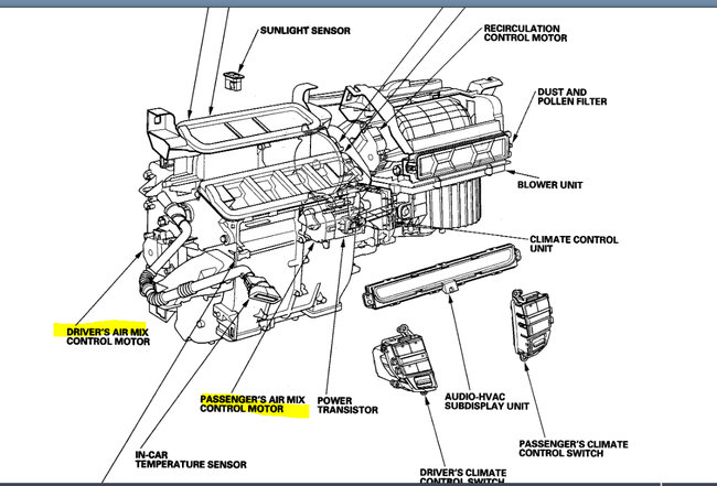

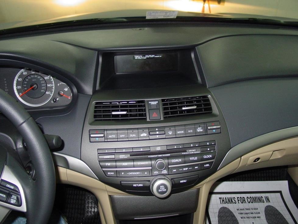

Automatic VS Manual is simple. With an automatic system, you pick a temp and the system maintains that temp. With a manual, the air temp coming into the vehicle is controlled by the driver via the blend air door.
I attached a pic showing both actuators.
JGONZO2398
  • 374 POSTS
I have this setup:
  • 110,248 POSTS
If I can tell, it looks like the one button indicates auto, which would be the automatic climate control.
You know, a thought just came into my mind. If I remember (and bear with me. It's 2:11am here) there was an issue with a sand like material in the engine block cooling system from when these were new. I wonder it that is blocking parts of the heater core and hasn't come out when you flushed it.
It's just a thought. I'm a bit tired at this point. LOL
