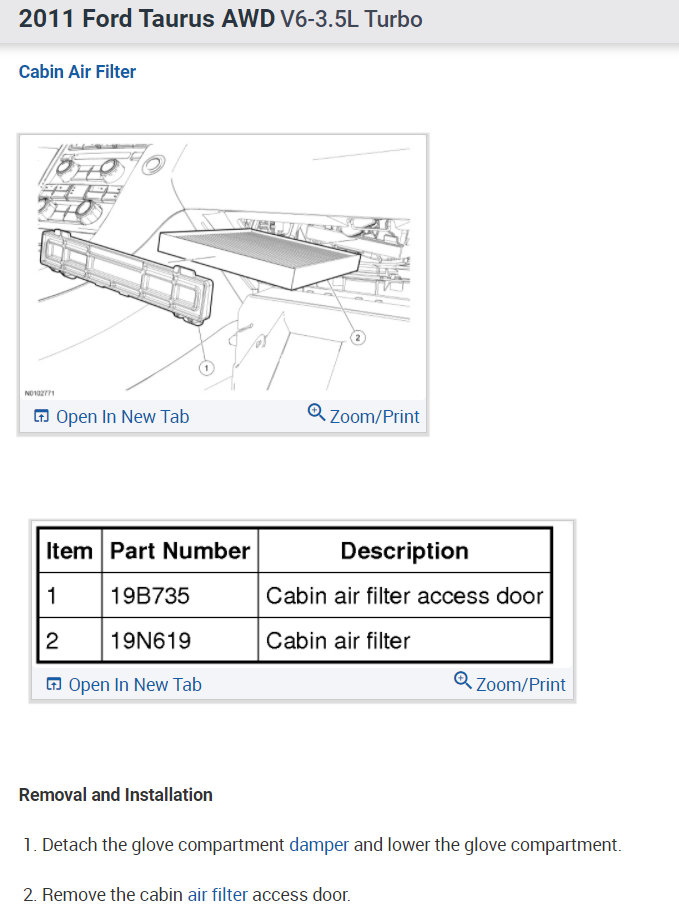

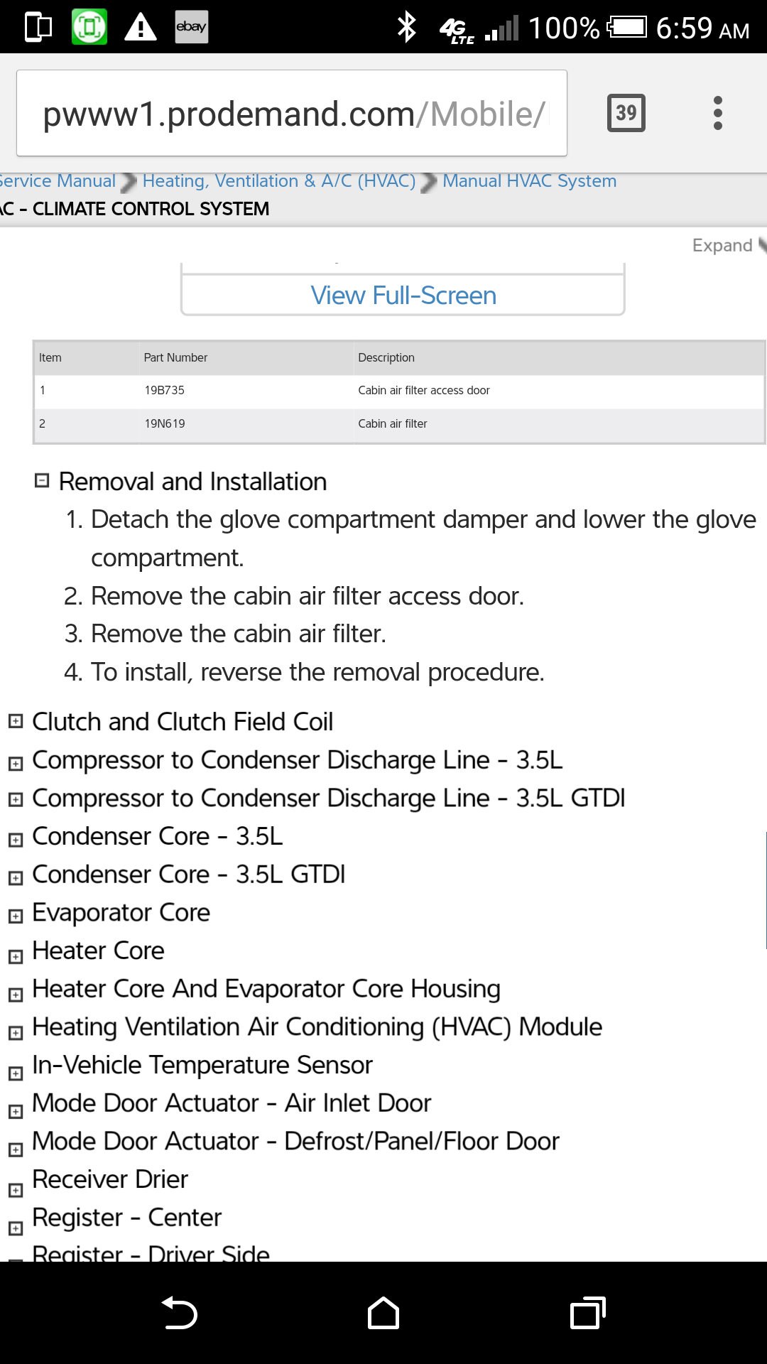

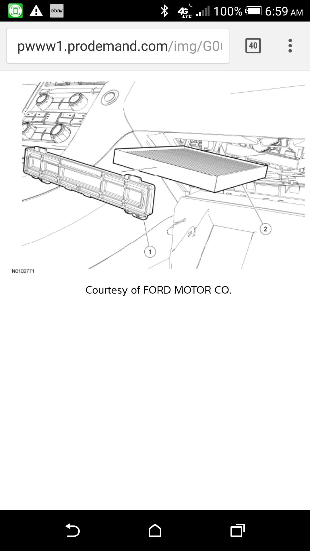

Jan 13, 2017 at 10:55 PM
SATURNTECH9
  • 30,869 POSTS
I posted the instructions and diagram for the pollen filter removal.Just make sure you pay attention to which way the arrow on the pollen filter is going.So when you put one back in you know the new one is installed correctly.

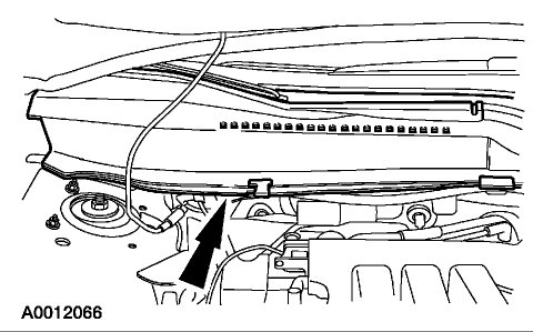

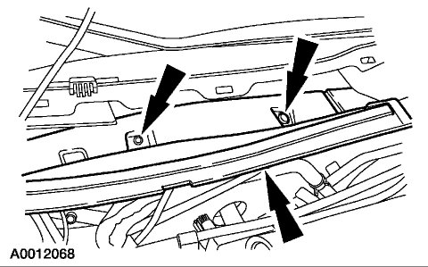

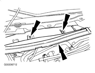

BMRFIXIT
  • 19,053 POSTS
Remove the right side cowl vent screen. Remove the screws and the water shield. Remove the pollen filter. To install filter, reverse removal procedure.
https://images.2carpros.com/forum/automotive_pictures/99387_Graphic1_387.jpg
good luck
Jun 22, 2021 at 4:21 AM (Merged)

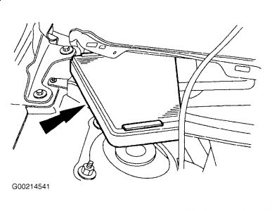

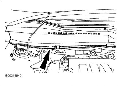

STEVE W.
  • 15,345 POSTS
If it has one (LX trim level didn't) it is outside the cabin under the cowl trim piece at the base of the windshield on the passenger side. You remove the clips and gently remove the rubber seal, then the screws. Under that you will find a water shield, remove it and the filter is under it.

BMRFIXIT
  • 19,053 POSTS
under hood right side Removal & Installation open hood Remove the right side cowl vent screen.. Remove the screws and the water shield. Remove the pollen filter. To install filter, reverse removal procedure.

TRLH4
My manual says the cabin air filter is located just in front of the windshield under the cowl grille. Is this on the dash by the windshield or under the hool by the windshield. I took off what i thought was the cowl grille on the dash but could not find it.
BMRFIXIT
  • 19,053 POSTS
(2000-2007) Open hood Remove the right side cowl vent screen. Remove the screws and the water shield. Remove the pollen filter. To install filter, reverse removal procedure.

TAURUSWHEEL
  • 718 POSTS
Pop the hood, look at the passenger-side cowl, there should be some clips.. pop these off, drop down the housing you should be able to see the filter.. I sugggest buying yourself a Chilton, or some such, type of book for your model year.. it has a lot of info such as what you're looking for,, relatively not much $$$$ also, no be-all end-all but some good info regardless.
