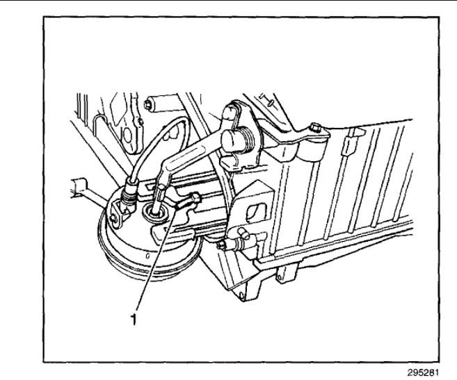

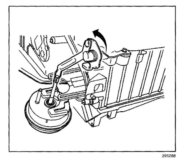

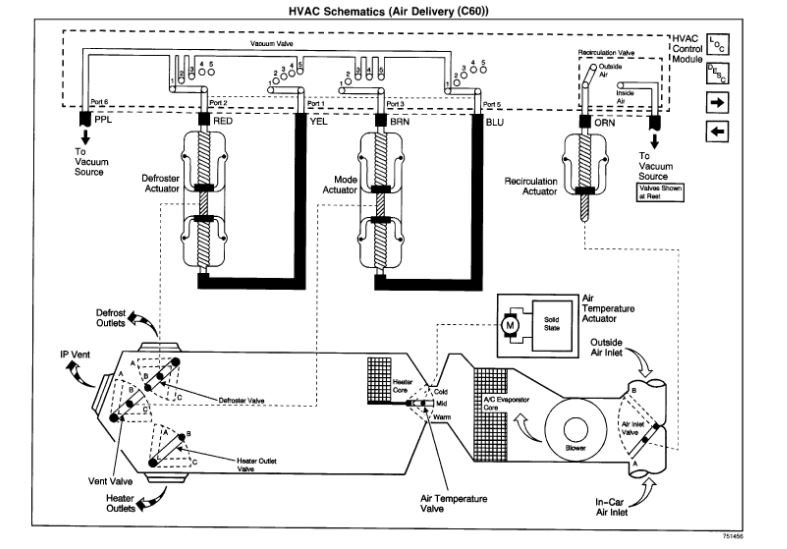

The mode door control is vacuum operated. The control head sends a vacuum to the actuator to move it to the correct position.
I attached the procedure for replacing the actuator but you also need to verify the vacuum to the actuator for it to work.
REMOVAL PROCEDURE
1. Remove the left instrument panel insulator.
2. Remove the instrument panel knee bolster bracket.
3. Disconnect the vacuum lines from the mode actuator.
4. Carefully rotate the mode actuator toward the front of the vehicle until the actuator is released from the mounting pins on the HVAC module.
5. Disconnect the vacuum actuator pushrod and remove the actuator.
