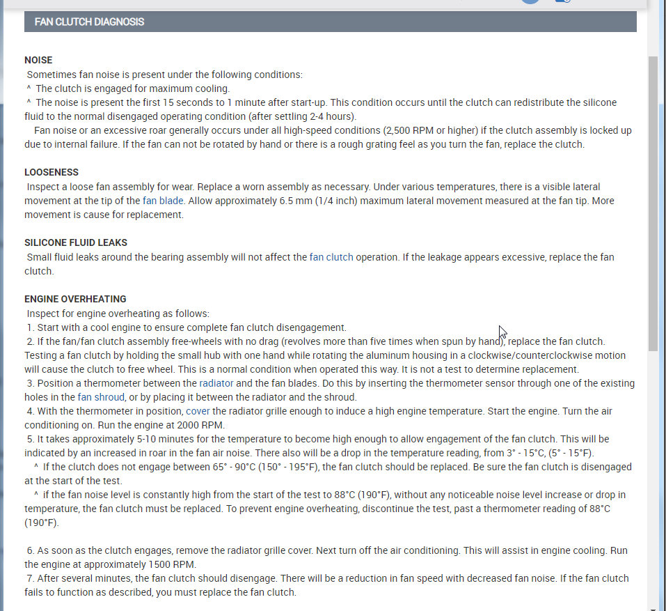

First of all the owners manual says 1998 but the door jamb sticker says 9 of 1999. Anyways, the temperature gauge on the dash only reaches about a hundred and twenty degrees which is actually accurate to the infrared reading I took off the engine after running it 20 minutes. I tested the thermostat in boiling water and it seemed to be closed and then open up when the water got hot whether it was exactly a hundred 85 degrees when it opened I don't know but it did appear to open. I cannot see coolant circulating in the radiator when the cap is off and the engine is warm. Several questions could I still have a faulty thermostat? Could I have a faulty water pump. Third could I have a clogged radiator? If you have other suggestions I'm all ears. Thank you for your assistance as always.

The engine is not overheating. The engine won't rise above 150 to 160 degrees after driving it. This is below the normal operating temperature. The radiator seems to be very clean inside I just flushed it and change the coolant. When I start the truck and it's cold the fan is even running back to me doesn't seem right could I be having a problem with the fan running too much.

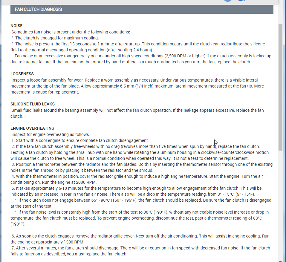

Okay. I understand now. Just to confirm the fan runs all the time? If this is the case, your fan clutch is stuck and causes the fan to run when the engine runs and this is not going to allow your coolant to come up to temperature.
https://www.2carpros.com/articles/fan-clutch-symptoms
https://www.2carpros.com/articles/fan-clutch-removal
Below is some more info on this but it sounds like it needs to be replaced.
Let me know if I am still missing something. Thanks
