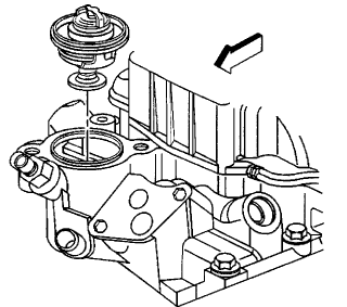

where is thermostat located on the car
Sep 11, 2020 at 8:26 AM (Merged)
MASTERTECHTIM
  • 4,750 POSTS
follow the upper radiator hose to the engine. where it connects is the thermostat housing on the intake manifold. Here is a guide that will walk you through the repair with instructions in the diagrams below to show you how on your car.

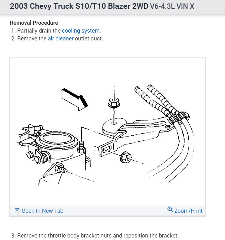

MUNROFAMILY
2003 Chevy Blazer 6 cyl Two Wheel Drive Automatic
How do you drain the radiator (below thermostat housing) as this is step one to replace thermostat. I have not a drain on the bottom of the radiator have i missed it.
BLUELIGHTNIN6
  • 16,542 POSTS
it is located on the passenger side of the radiator near the bottom edge, on the engine side. you might have a small black rubber hose coming off of the area of the drain. The drain is plastic and should look kind of like a wing nut. You also get the best access to it from inside the wheel well by removing the pastic fender well cover.

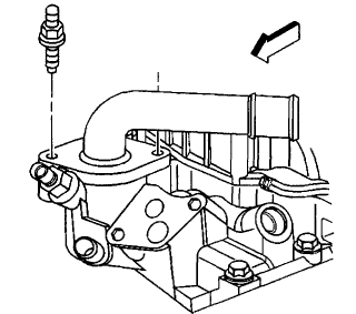

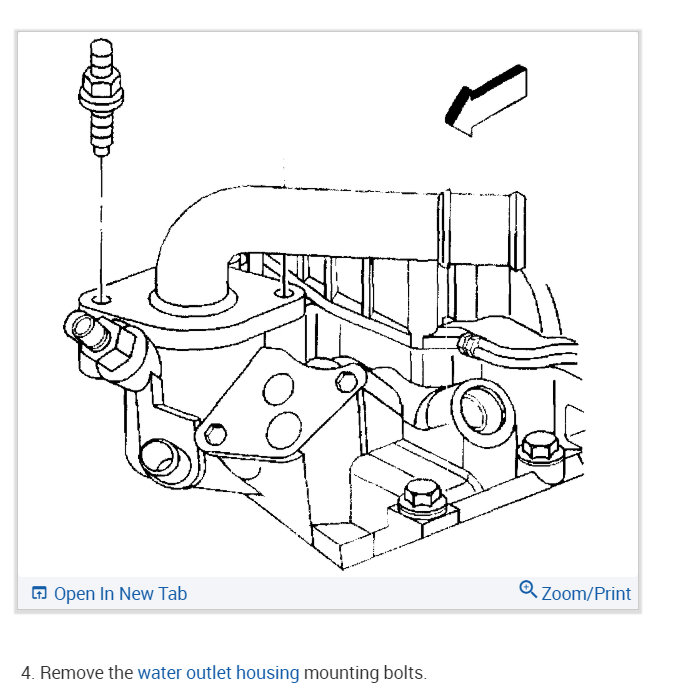

DENNYP
  • 1,824 POSTS

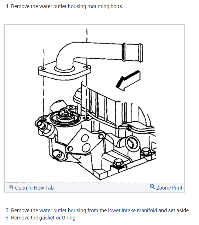

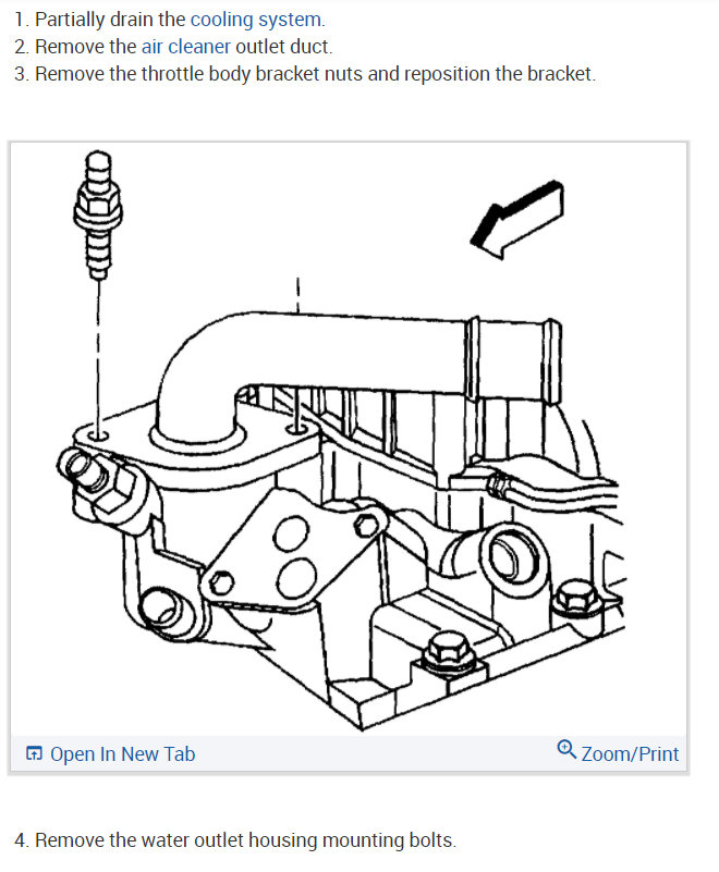

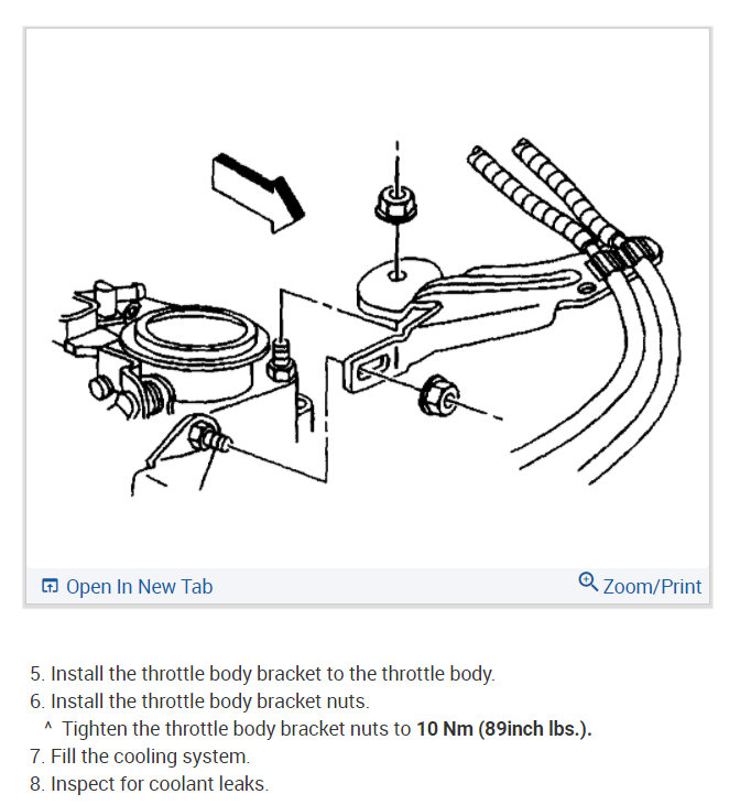

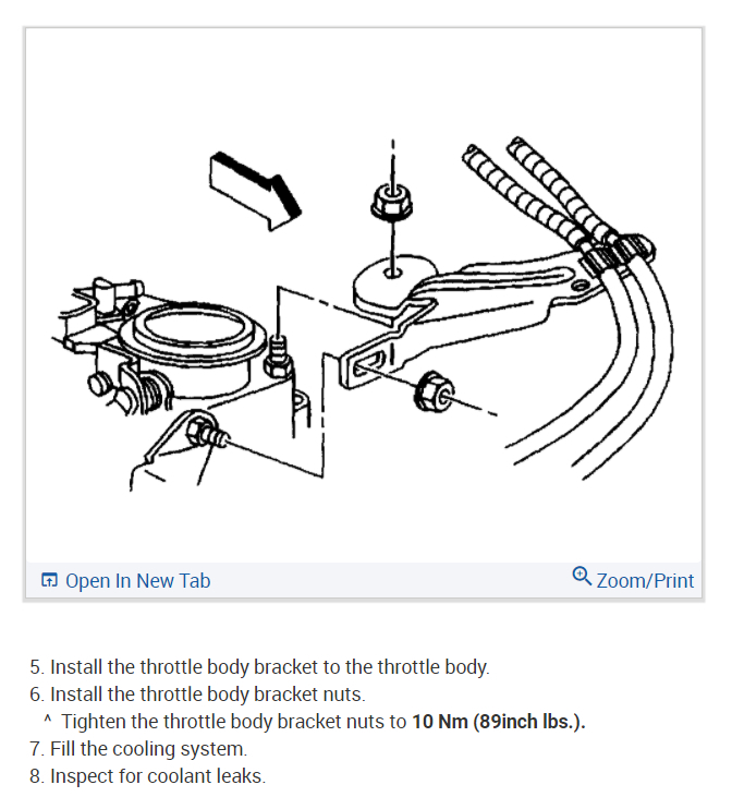

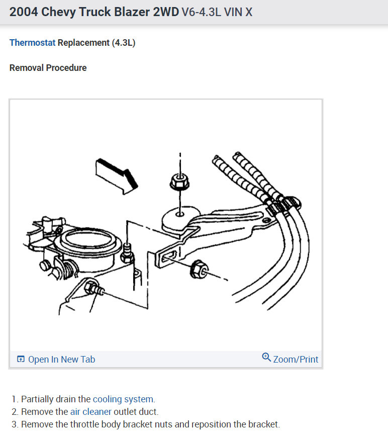

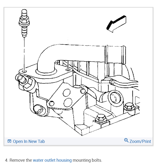

Engine Coolant Thermostat Replacement (4.3 L) Removal Procedure Partially drain the cooling system. Refer to Cooling System Draining and Filling . Remove the air cleaner outlet duct. Air Cleaner Outlet Resonator Replacement in Engine Controls - 4.3 L. Remove the throttle body bracket nuts and reposition the bracket. Remove the water outlet housing mounting bolts. Remove the water outlet housing from the lower intake manifold and set aside. Remove the gasket or O-ring. Remove the thermostat. Clean all the sealing surfaces of the water outlet housing. Clean the sealing surface on the lower intake manifold. Installation Procedure Important: In order to prevent leakage, thoroughly clean all parts and sealing surfaces. Install the thermostat. Install a new gasket or O-ring. Install the water outlet housing to the lower intake manifold. Notice: Use the correct fastener in the correct location. Replacement fasteners must be the correct part number for that application. Fasteners requiring replacement or fasteners requiring the use of thread locking compound or sealant are identified in the service procedure. Do not use paints, lubricants, or corrosion inhibitors on fasteners or fastener joint surfaces unless specified. These coatings affect fastener torque and joint clamping force and may damage the fastener. Use the correct tightening sequence and specifications when installing fasteners in order to avoid damage to parts and systems. Install the water outlet housing mounting bolts. Tighten Tighten water outlet housing mounting bolts to 19 N·m (14 lb ft). Install the throttle body bracket to the throttle body. Install the throttle body bracket nuts. Tighten Tighten the throttle body bracket nuts to 10 N·m (89 in lb). Fill the cooling system. Refer to Cooling System Draining and Filling . Inspect for coollant leaks.
https://images.2carpros.com/forum/automotive_pictures/102900_1_3.jpg
https://images.2carpros.com/forum/automotive_pictures/102900_2_3.jpg
https://images.2carpros.com/forum/automotive_pictures/102900_3_3.jpg
https://images.2carpros.com/forum/automotive_pictures/102900_4_3.jpg

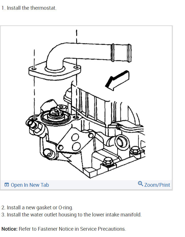

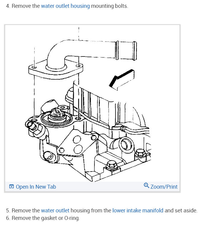

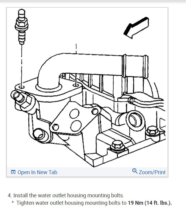

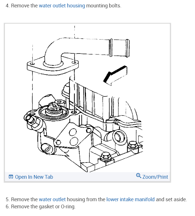

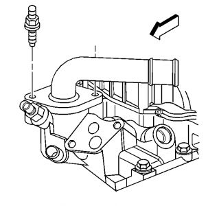

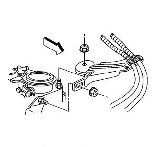

  • 75,992 POSTS
Removal Procedure
https://images.2carpros.com/forum/automotive_pictures/12900_therm1_1.gif
1.Remove the necessary coolant from the radiator. Refer to Draining and Filling Cooling System. 2.Remove the air outlet duct. Refer to Air Cleaner Outlet Duct Replacement. 3.Remove the throttle body bracket. Refer to Throttle Body Assembly Replacement. 4.Remove the thermostat housing mounting bolts.

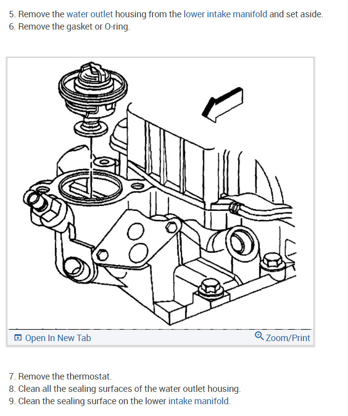

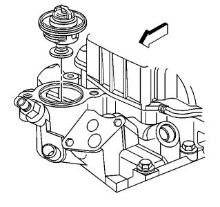

https://images.2carpros.com/forum/automotive_pictures/12900_therm2_1.gif
5.Remove the thermostat housing from the lower intake manifold and set aside. 6.Remove the gasket or O ring.

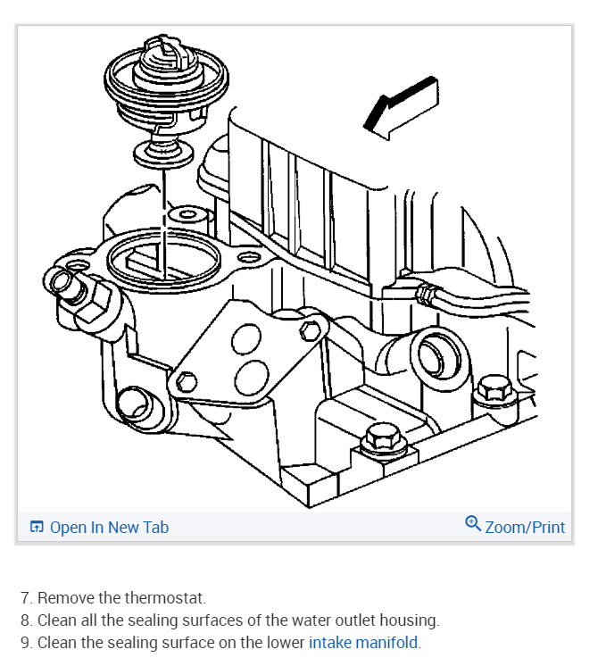

https://images.2carpros.com/forum/automotive_pictures/12900_therm3_1.gif
7.Remove the coolant thermostat. 8.Clean all the sealing surfaces of the coolant outlet. 9.Clean the sealing surface on the lower intake manifold. Installation Procedure

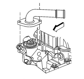

https://images.2carpros.com/forum/automotive_pictures/12900_therm4_1.gif

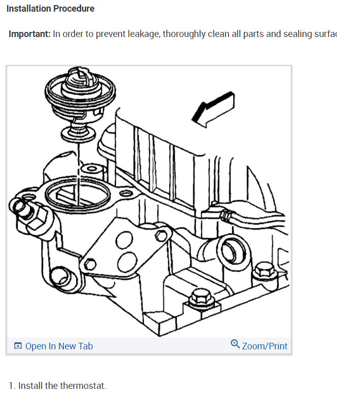

Important: In order to prevent leakage, thoroughly clean all parts and sealing surfaces. 1.Install the coolant thermostat.
https://images.2carpros.com/forum/automotive_pictures/12900_therm5_1.gif
2.Install a new gasket or O ring. 3.Place the thermostat housing on the lower intake manifold. Ensure the gasket or O ring is in correct position.
https://images.2carpros.com/forum/automotive_pictures/12900_therm6_1.gif
Notice: Refer to Fastener Notice in Service Precautions. 4.Install the thermostat housing mounting bolts. *Tighten thermostat housing mounting bolts to 19 Nm (14 ft. lbs.) . 5.Install the throttle body bracket. Refer to Throttle Body Assembly Replacement. 6.Fill the cooling system with specified coolant and concentration. Refer to Draining and Filling Cooling System. 7.Install the air outlet duct. Refer to Air Cleaner Outlet Duct Replacement. 8.Inspect all sealing surfaces for leaks after starting the engine. Refer to Cooling System Leak Testing (On-Vehicle) or Cooling System Leak Testing (Off-Vehicle).
