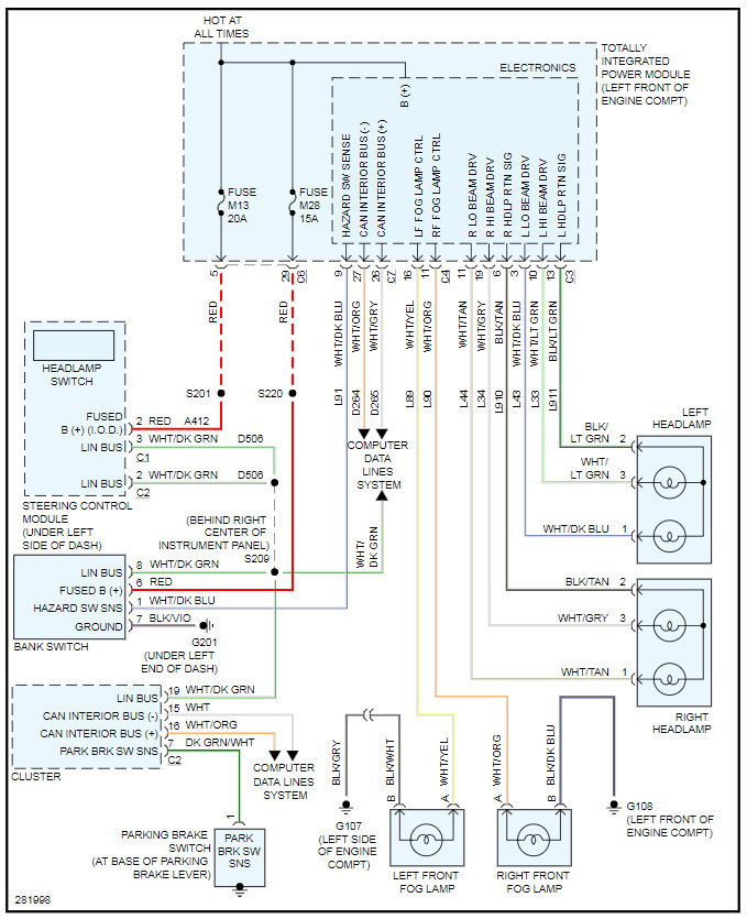

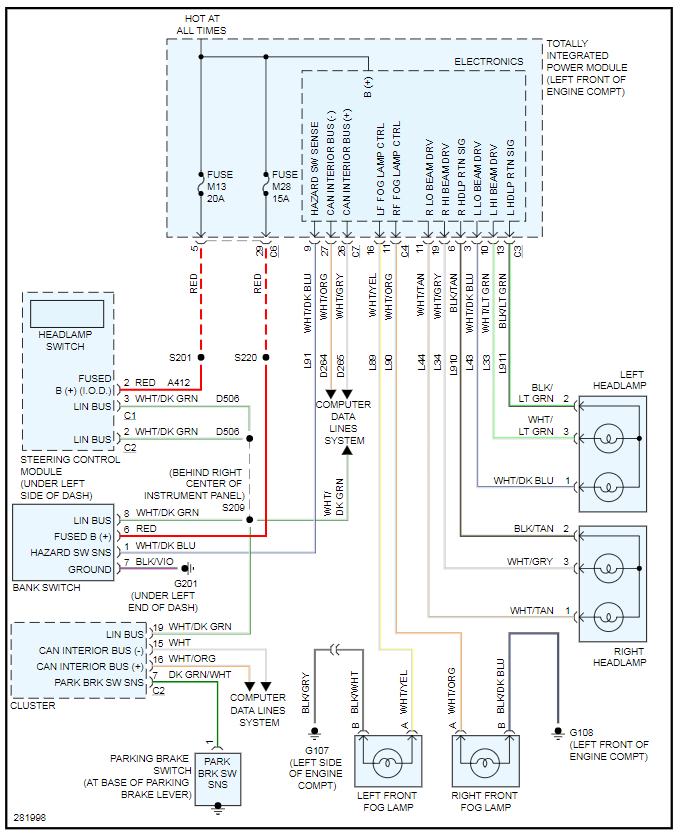

I can tell when headlights will/won't work by unlocking car sometimes they turn on and won't the next. Went a few days without turning off while driving now they turn on/off whenever. All other lights work just sometimes not the headlights. Will flicker both lights, one would work.Checked fuses and changed turn signal switch.
Nov 10, 2020 at 10:56 PM

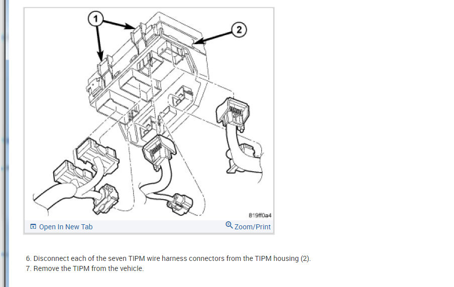

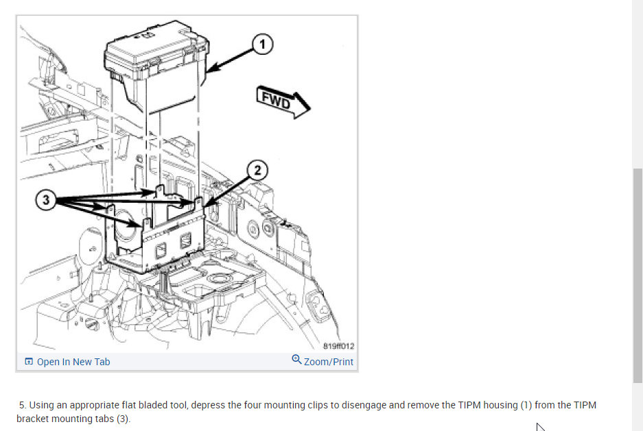

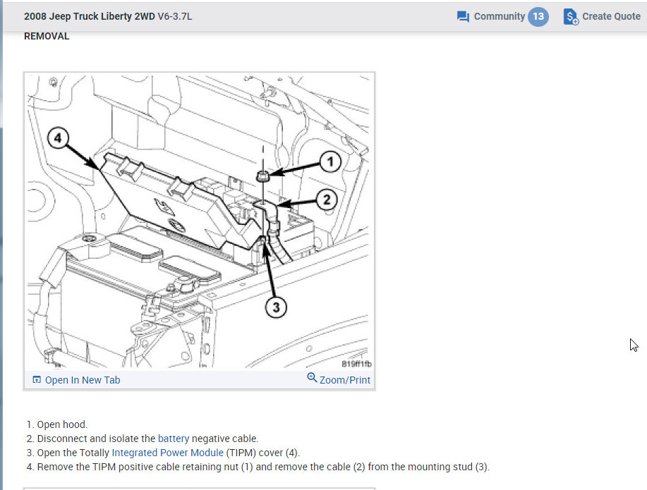

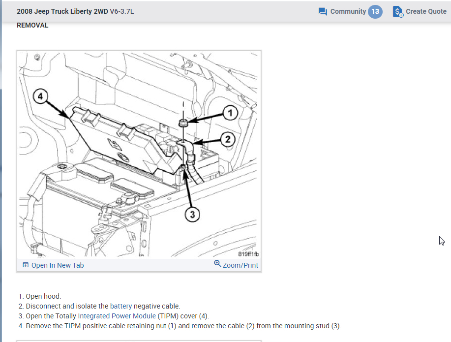

More then likely you have an issue with what is called the TIPM or Totally Integrated Power Module or a wiring issue. The fact that this is both lights it is most likely the TIPM since there are separate wires for each lamp from the TIPM.
If it were me, I would replace the TIPM and if it continues then you are going to have to start replacing the wiring.
Let me know what questions you have. Thanks
