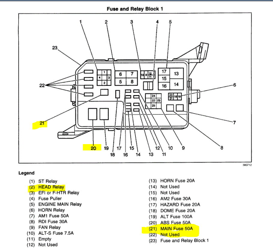

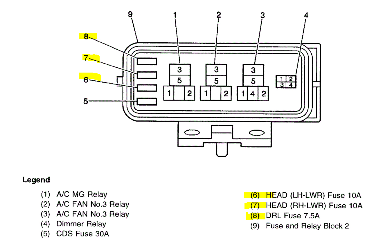

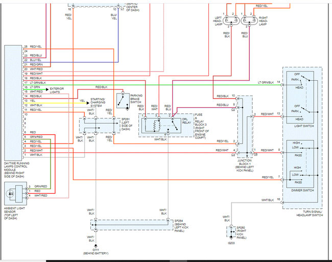

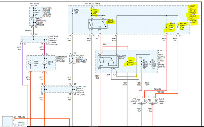

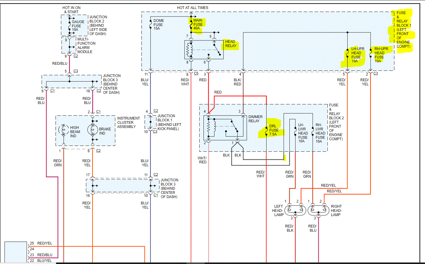

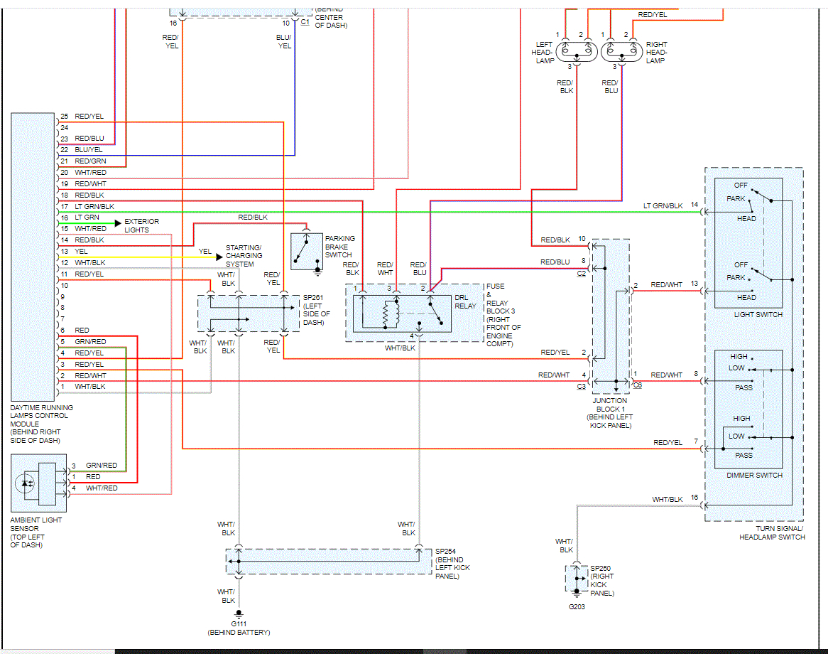

There are a few different fuses that need to be checked. I attached the wiring schematic below of the headlamp system. It was one page long, but I cut it in half to make it readable.
On the schematic, I highlighted fuses and a relay. These are all located under the hood in fuse and relay boxes 1 and 2.
When checking the fuses, it is important to confirm there is power to them in addition to checking the fuse.
Pics 3 and 4 show the fuse locations.
Also, here is a link that explains how to test a relay. Pull that as well and inspect it.
