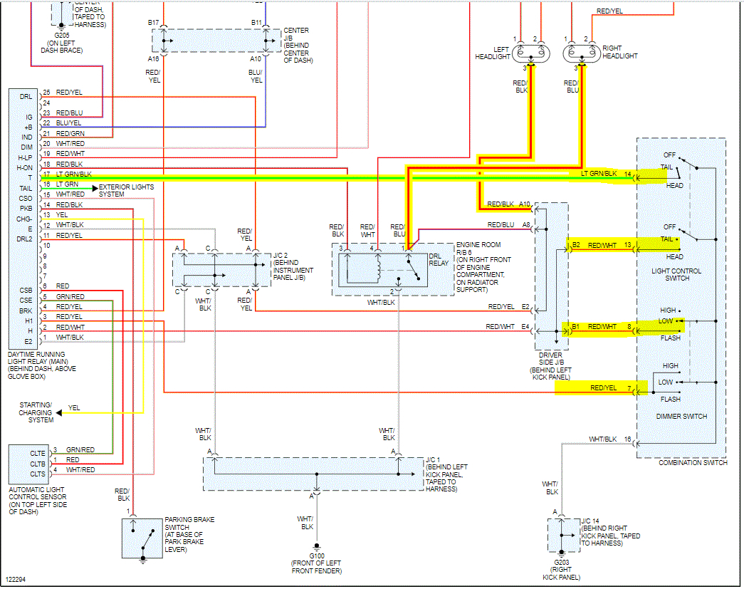

When my car is on during the day, the DRL work just fine. However, when the I go to turn the headlights on using the dimmer switch the lights do not work at all, both low and high beams; though the high beam light will illuminate on my dashboard when trying to use the high-beams.
I have checked all of the fuses and replaced all of the relays in addition to replacing the dimmer switch with no luck. I have also replaced the relay/running light control module with one from a junkyard.

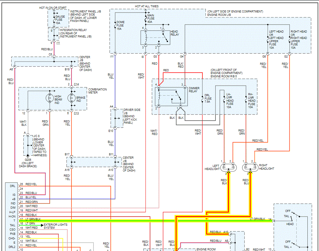

If all fuses are good, the relays are good, and you replaced the main DRL relay above the glove box, power is likely being lost before the switch.
I attached the headlamp wiring schematic below. Check the wires I highlighted at the switch for power. Also, if you haven't already, confirm there is power to the fuses you checked. Note I had to cut the schematic in half to make it readable. I did overlap the two pics so you can follow from one to the next.
