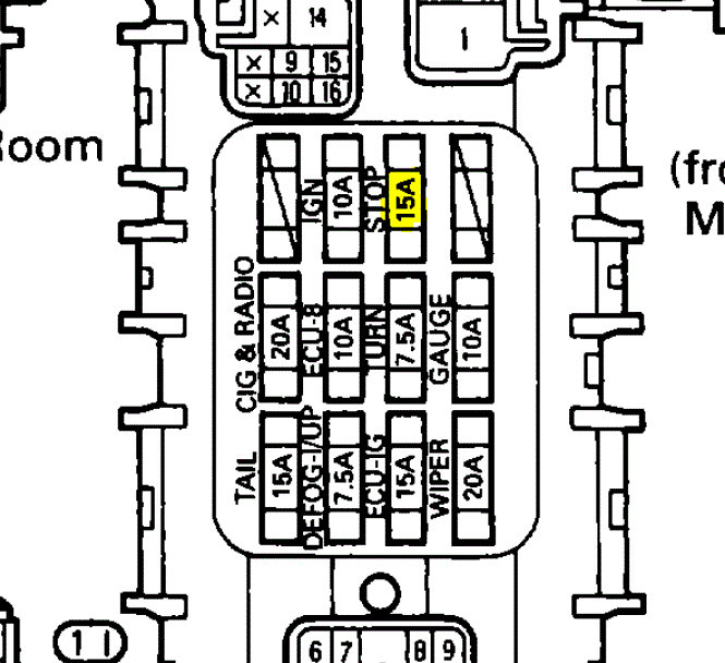

The first thing I want you to do is to remove the fuse for the brake lights. Do the lights turn off? If not, we have a short to power. So let me know.

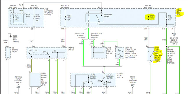

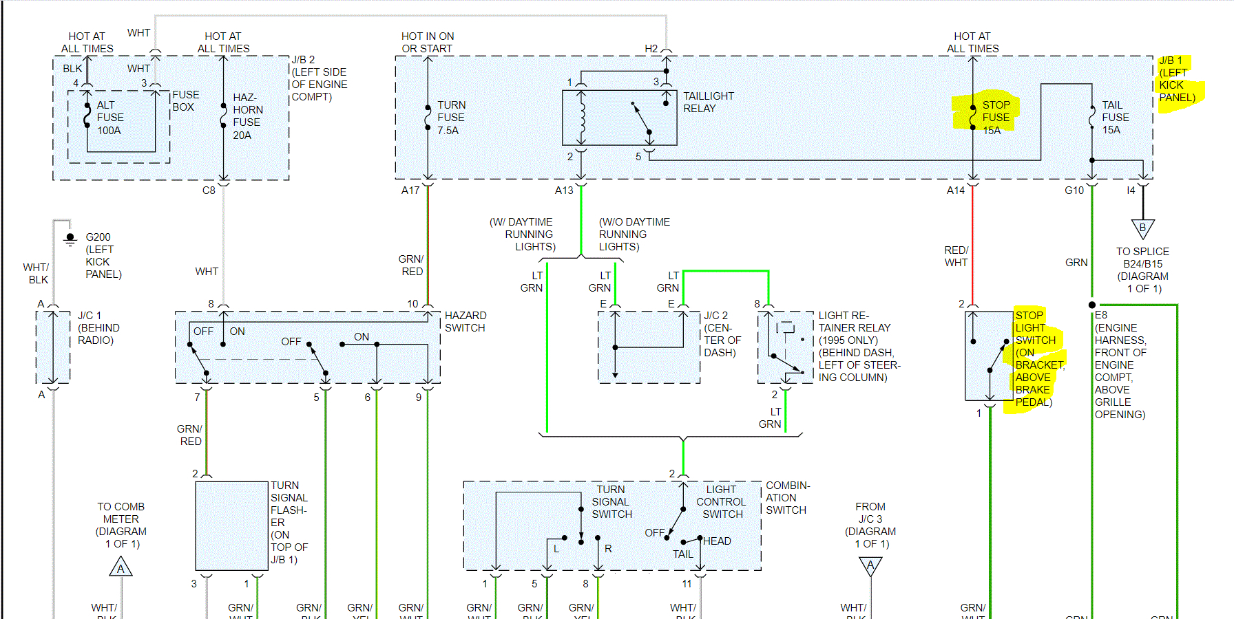

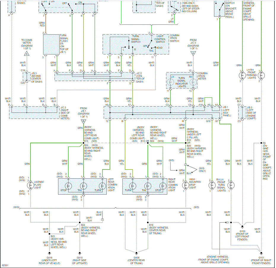

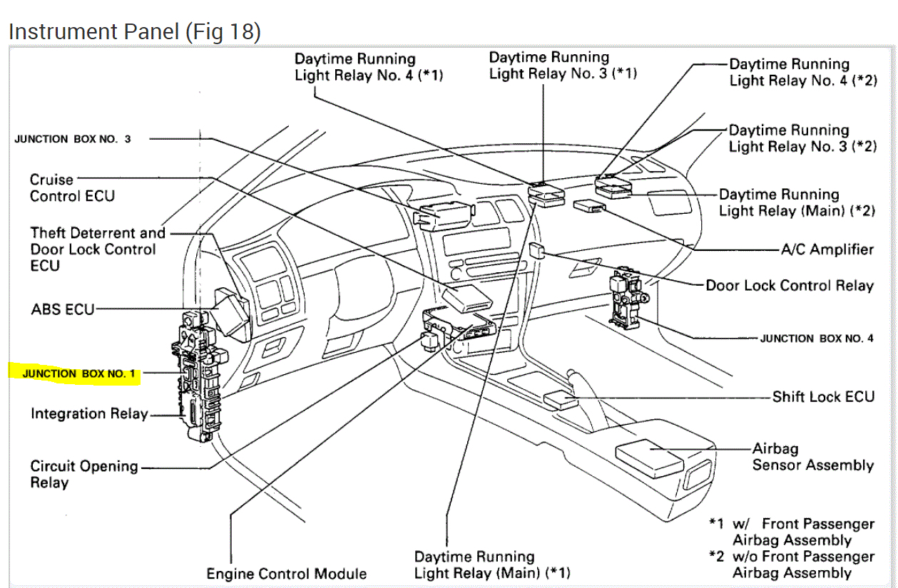

Let me know what you find or if you have other questions. Additionally, I attached the wiring schematic below for the exterior lighting. I highlighted the fuse and the switch. Also, pic 3 shows the location for junction box 1, and pic 4 shows the fuse for the brakes.
