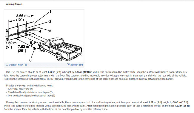

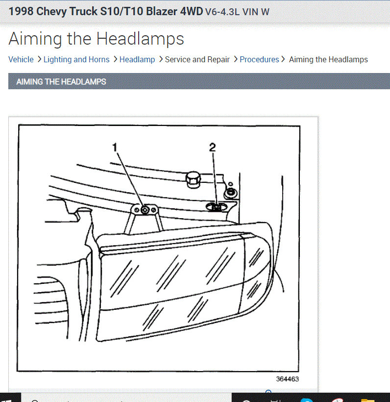

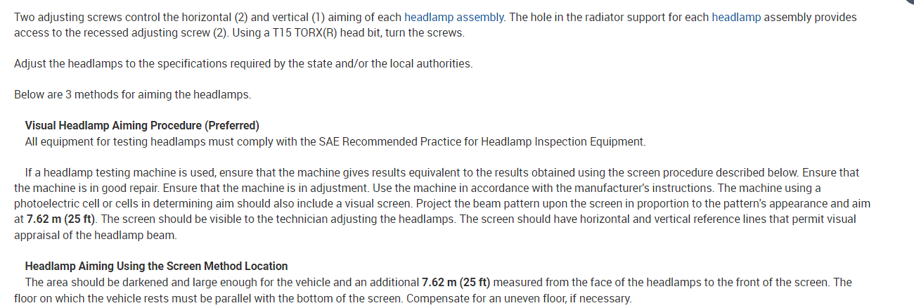

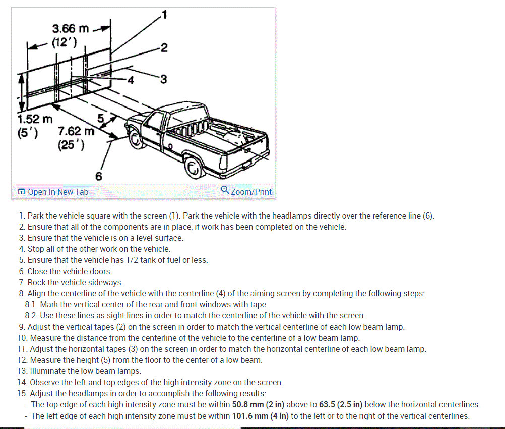

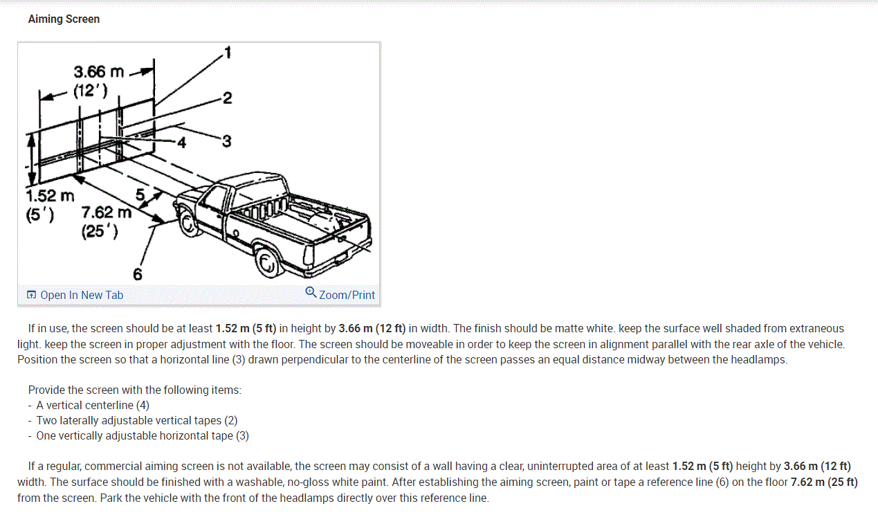

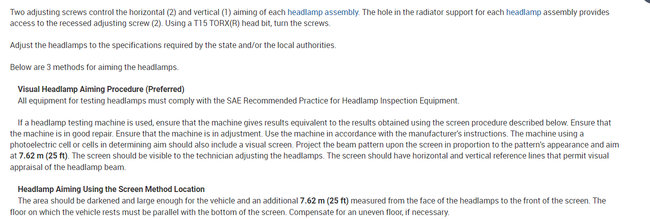

Adjusting the headlamps requires either a special headlamp aimer or a screen. You should be able to set things up with a stationary object like a garage door to aim them.
If you look at the attachments below, they provide the directions for aiming, how to adjust the lights, and distances.
