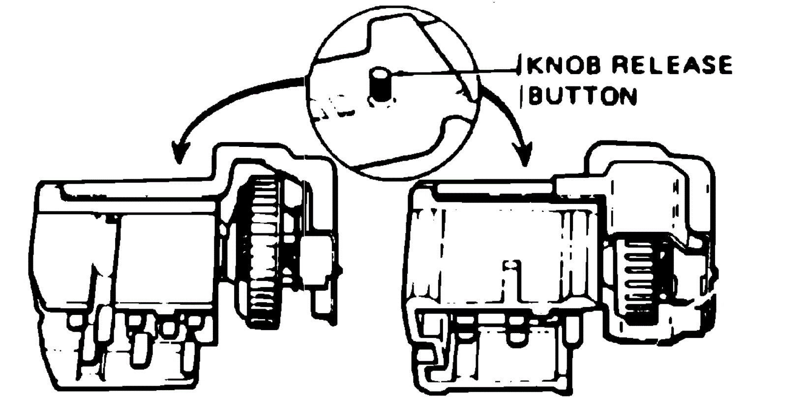

While driving the headlight randomly cut off
1989 FORD LTD
30,000 MILES • 6 CYL • AUTOMATIC
PINEKNOTTT409
And I hear a buzzing sound when they cut off. Sounds like the buzz is coming from around the steering column.

Could the noise be coming from the headlamp switch? I have seen them overheat and cause what you are describing.
If you determine it is from the switch, here are directions for replacement.
__________________
1989 Ford LTD V8-302 5.0L
Procedures
Vehicle Sensors and Switches Sensors and Switches - Lighting and Horns Headlamp Switch Service and Repair Procedures
PROCEDURES
Headlamp Switch
See Pic 1
1. On models equipped with airbag disable airbag system as described under MAINTENANCE PROCEDURES/AIRBAG SYSTEM DISARMING.
2. Under instrument panel, depress light switch knob and shaft retainer button on side of switch and, while holding button in, pull knob and shaft assembly from switch, Fig. 2.
3. Unscrew trim bezel and remove locknut.
4. From under instrument panel, pull switch from panel while tilting downward, disconnect electrical connector and remove switch.
5. Reverse procedure to install.
