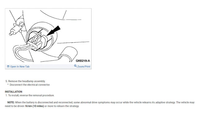

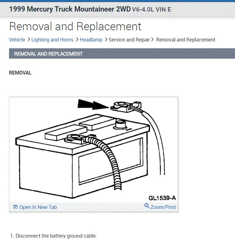

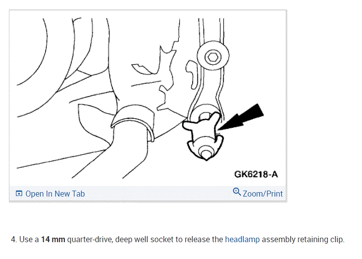

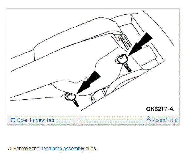

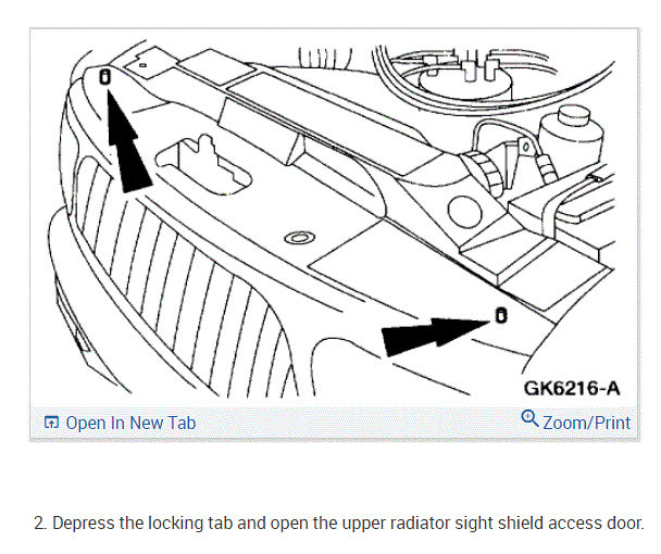

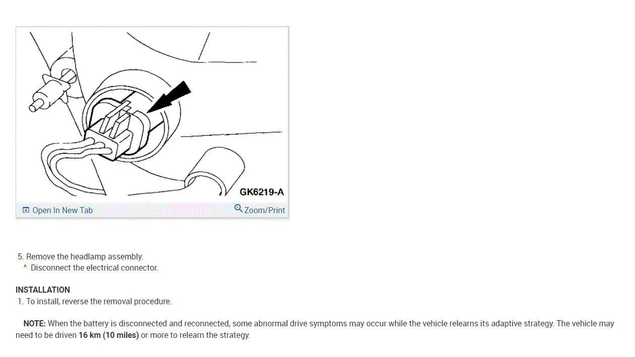

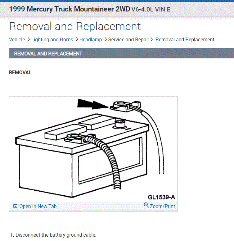

Need step by step guide to changing out headlight assembly on the vehicle listed above.
Jul 11, 2021 at 10:24 AM
  • 110,240 POSTS
Replacing the headlamp assembly isn't too difficult on this. If you take a look at the attachments below, they provide the step-by-step procedure for the removal and replacement of the assembly.
