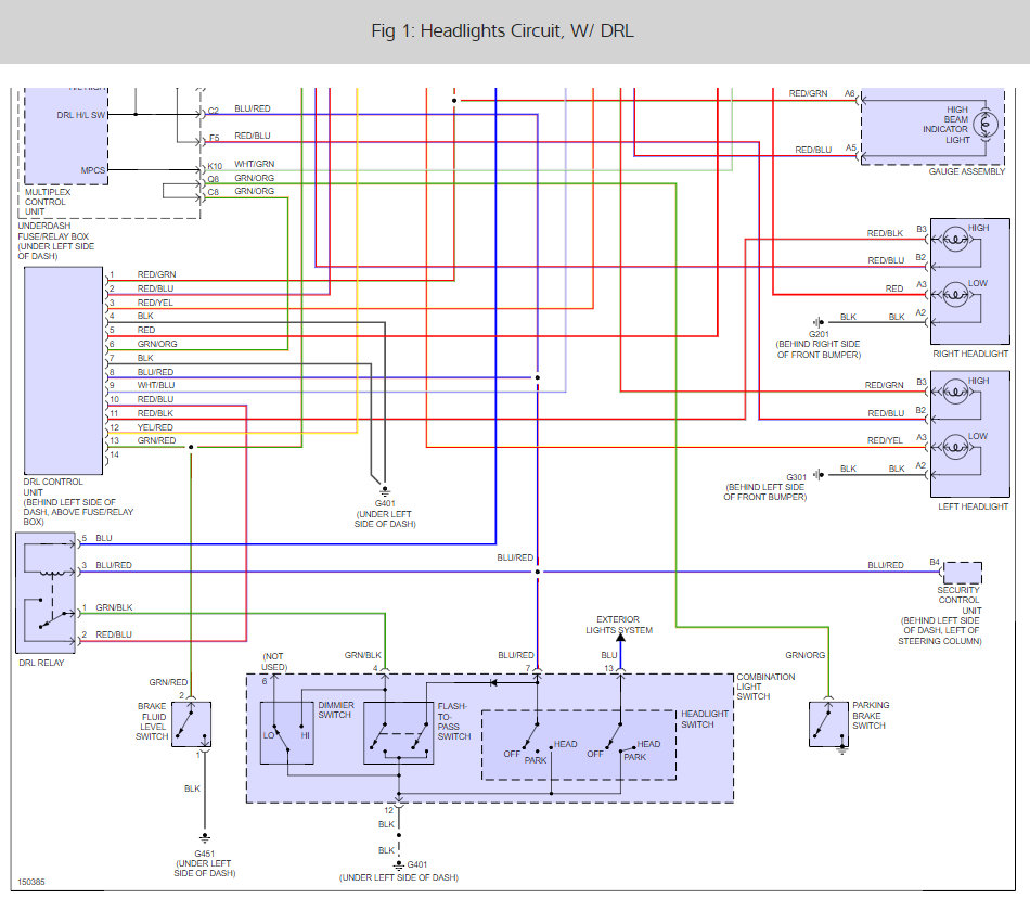

Headlights are not lighting up, except for passenger side high beam. DRL indicator light is on in the dashboard. Have tested fuses and relays for resistance and they are giving a resistance.
The tail lights and reverse lights work perfectly, as well as turn signals.

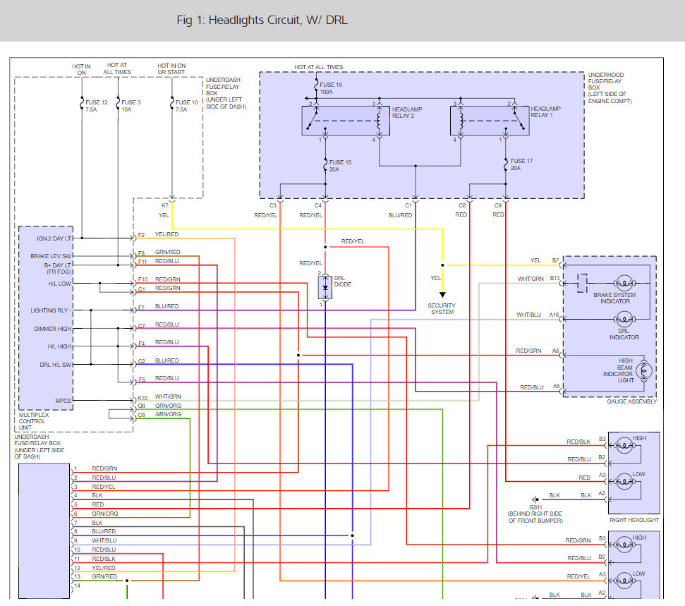

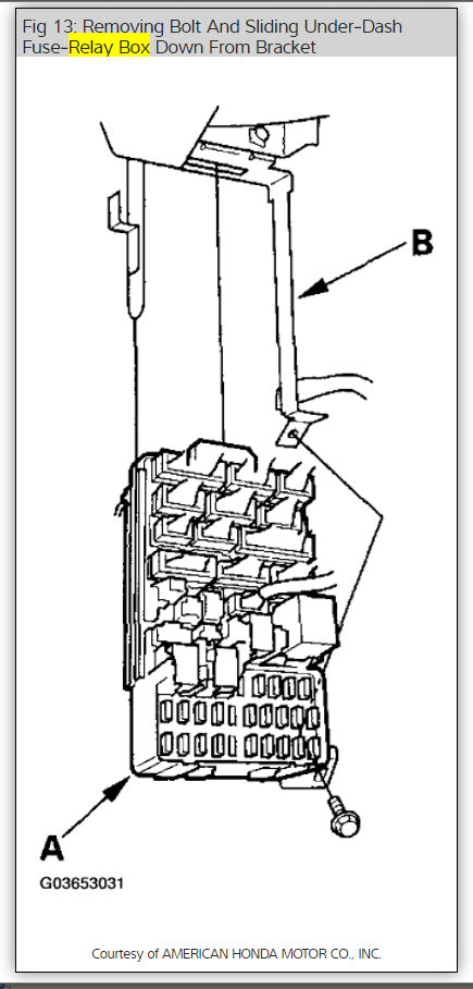

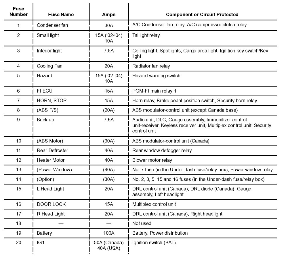

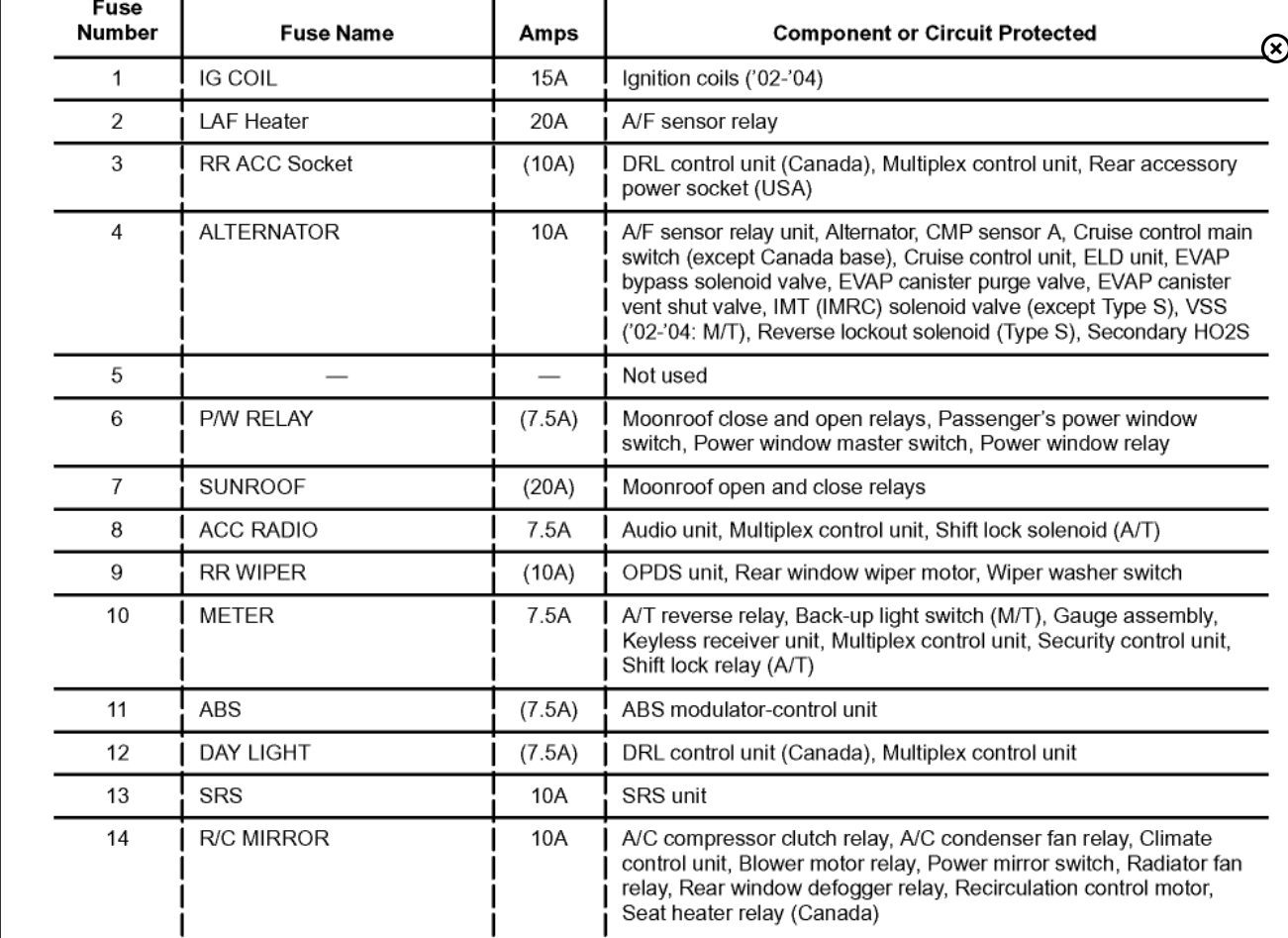

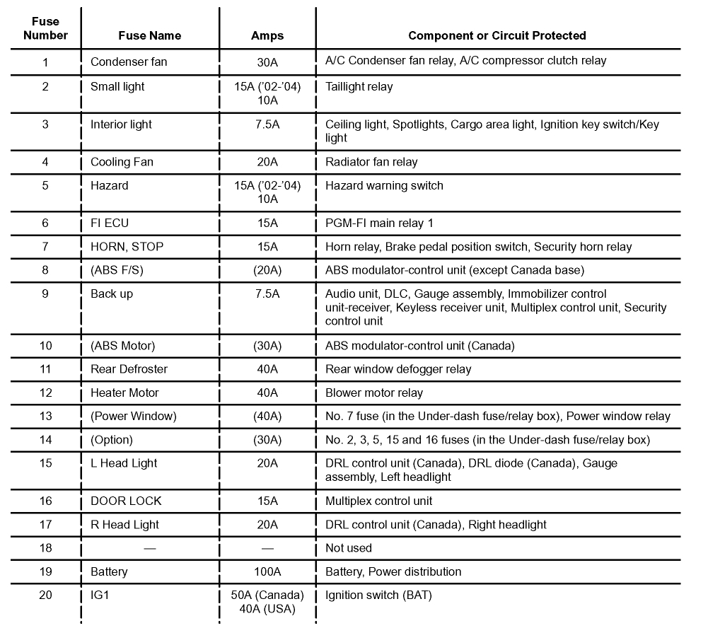

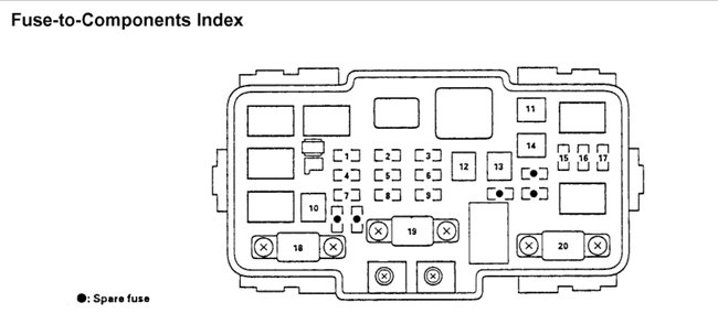

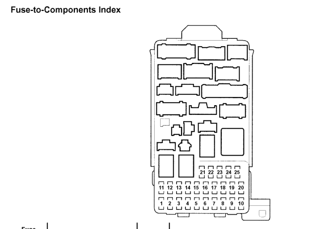

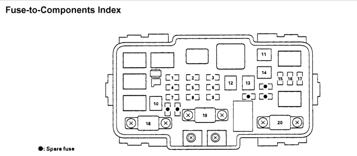

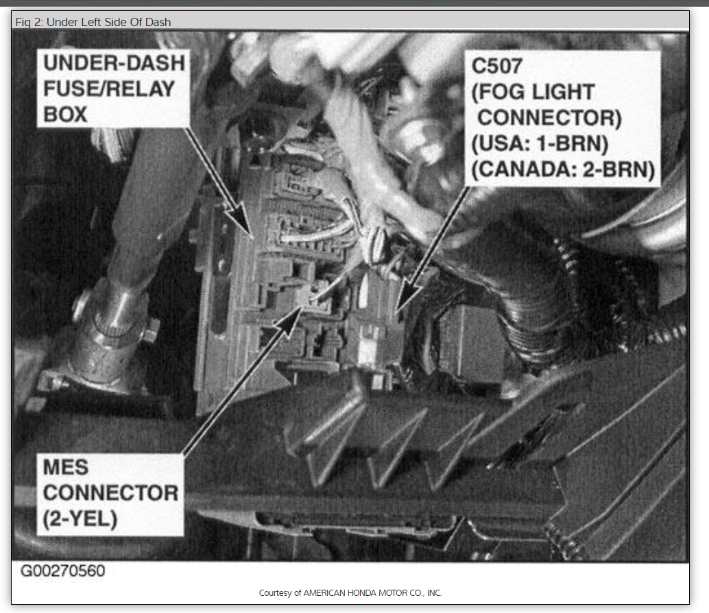

There are two relays and three fuses that run the system. Below are some guides and diagrams to help you run some simple tests and figure out what the problem is. Check fuse #12, 3 and 10.
and
If they check out test the power through the switch.

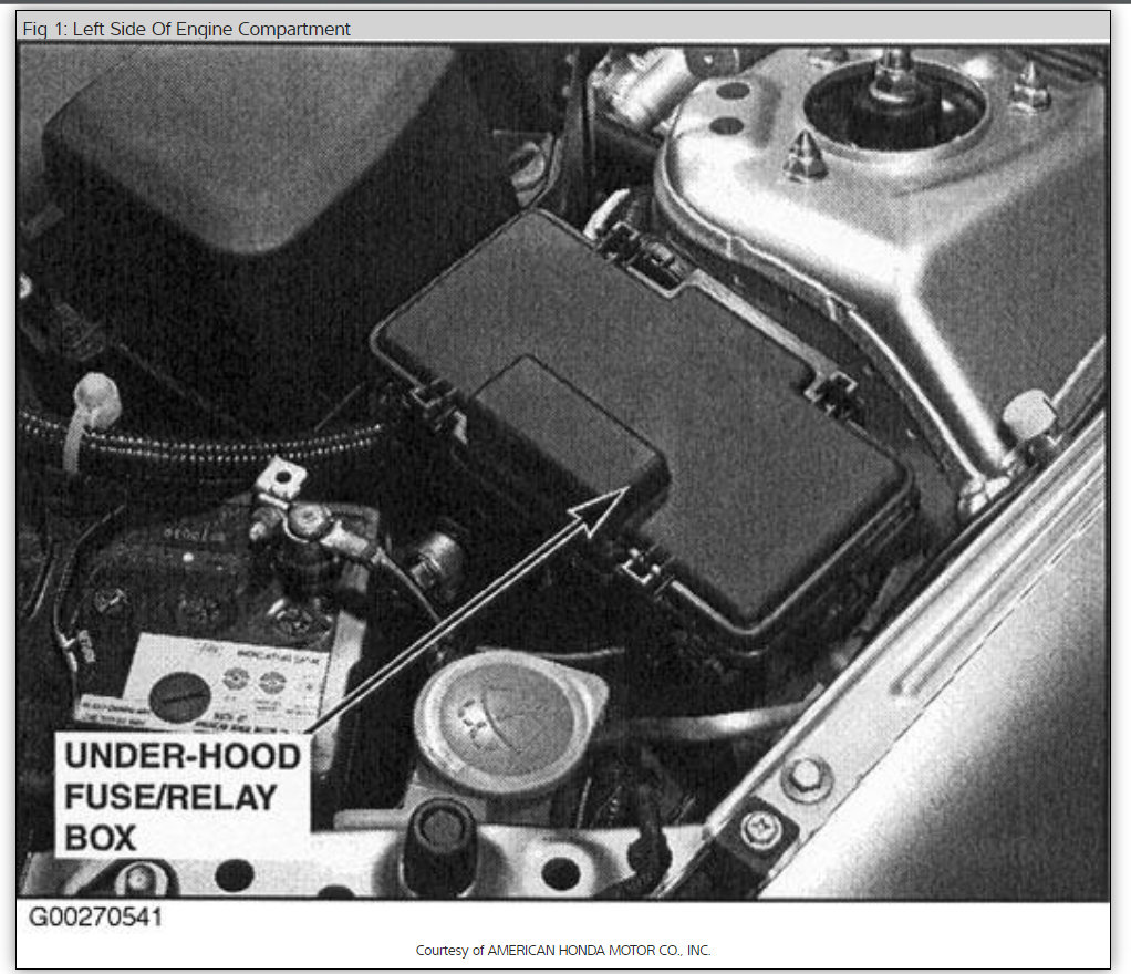

So I have tested all the fuses and the relays do appear to be working, so that all looks good. However, I did notice that fuses 15 and 17 in the under hood fuse box are not lighting the test light, despite supposedly always being hot. I have tried a new fuse in the socket and still it does not light the lamp. However, I have also found that the battery fuse is only an 80a although it's supposed to be 100a. Would this have any effect?
Oct 11, 2017 at 9:01 AM
  • 54,832 POSTS
I would replace the fuse but if it is not blown it will not effect anything. Are the relays activating when the headlights are turned on can you feel them click?

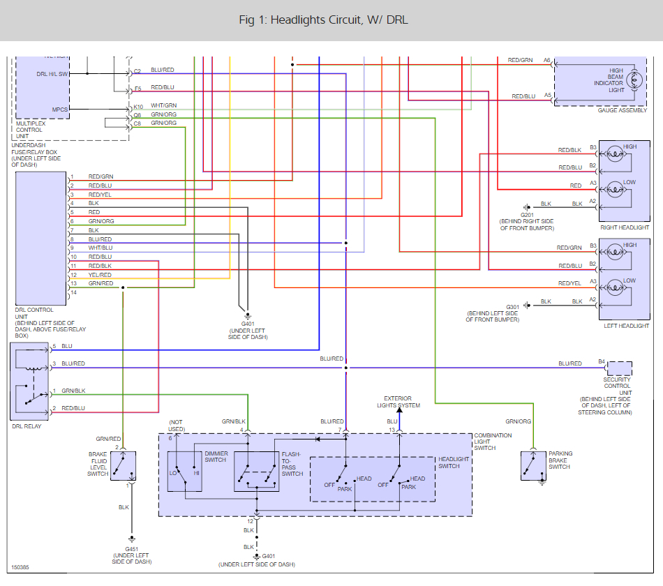

So I have confirmed that the fuses are getting power and the relays are good. However, I've noticed that when I turn the stick from drl to high beam, the high beam bulb on the passenger side come s on but dimly flickers, and the driver side on just flashes and quickly goes out. A single halo on the passenger side works as well. Could it possibly be a ground causing the flickering?

Check for any corroded earth terminals around the head light looms, check for loose or corroded head light plugs, the dim light may indicate a bad earth for the circuit.

I assume you are referring to G201 and G301, which requires me to take the front bumper down, right?
Oct 12, 2017 at 5:35 AM
  • 54,832 POSTS
Yes, I would test for power output at the DRL controller it sounds like it has failed. Also it could be the amplifier for the headlight as well. We are loosing power somewhere keep testing until you find it. Test the switch as well use the wiring diagrams to help.

So I know this was posted back in October, but I recently got enough time to poke through the headlight wiring. I traced back from the ballasts and discovered some wires with plastic coatings gone, and ground wires stuck to the chassis by rust. I have repaired the wire coatings and exposed more clean wire from the grounds as well as sanding out the rusted areas. I now have 5/6 bulbs working, but have yet to get around to the final low beam (which may only be a bulb). In the meantime, thank you guys for all your help in troubleshooting!
