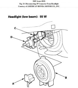

how do i replace the light bulb for the low beam?

Hi joingary, HEADLIGHT (LOW BEAM) 1. Disconnect the 3P connector (A) from the headlight.
https://images.2carpros.com/forum/automotive_pictures/192750_HeadlightLowBeam05RSX_1.jpg
2. Remove the rubber cover (B). 3. Pull the retaining spring (C) away from the bulb (D), then remove the bulb. 4. Install a new bulb in the reverse order of removal. Make sure the notches in the bulb align with the tabs in the headlight.
