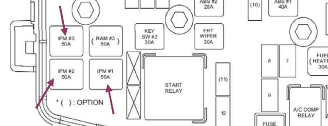

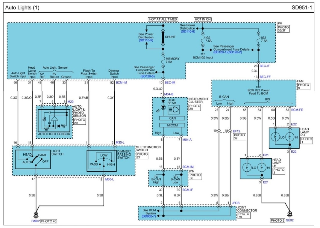

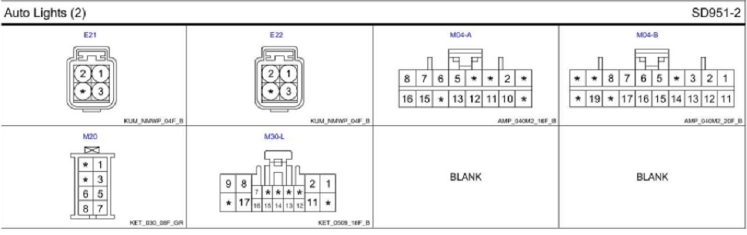

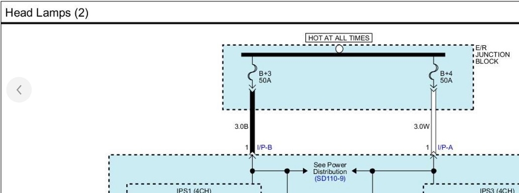

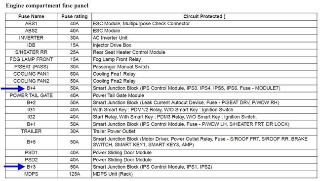

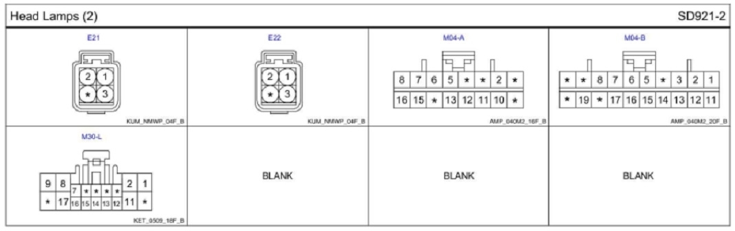

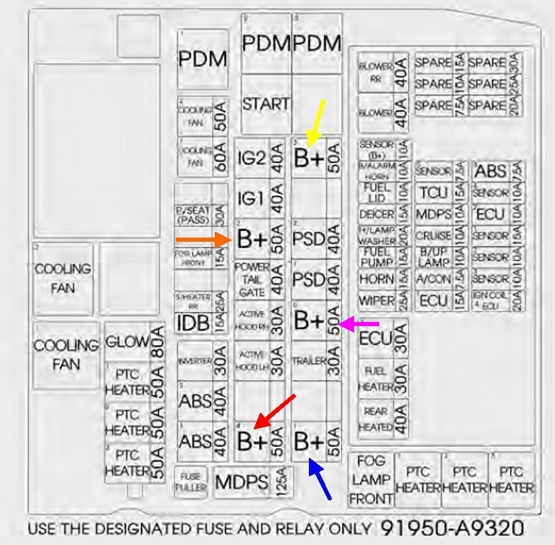

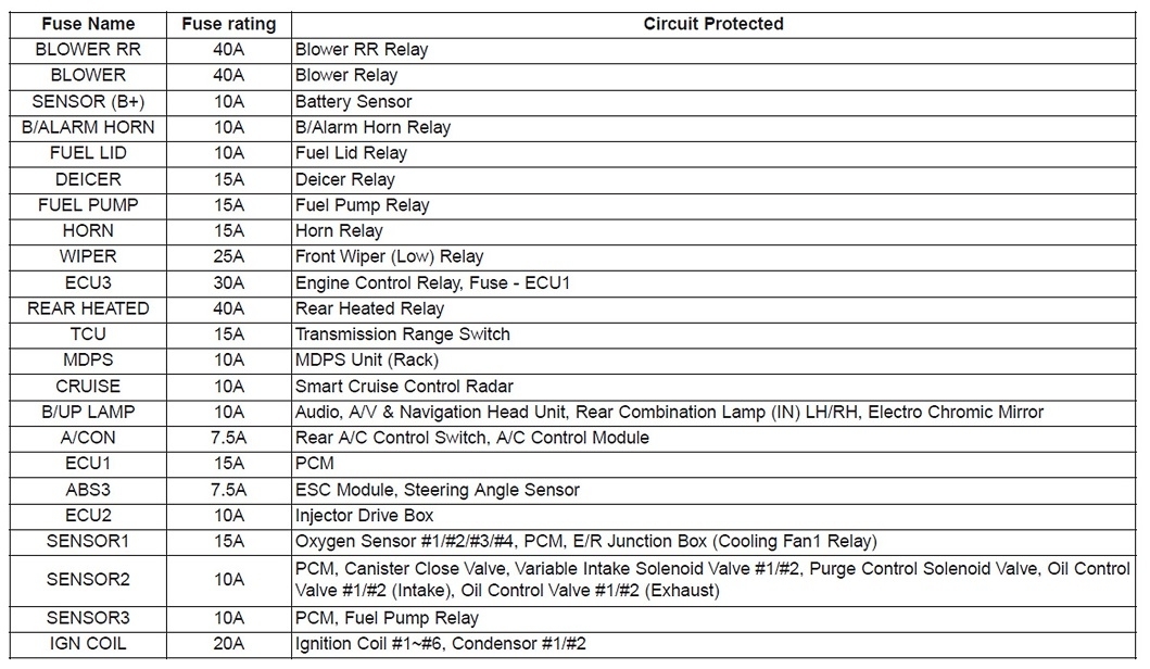

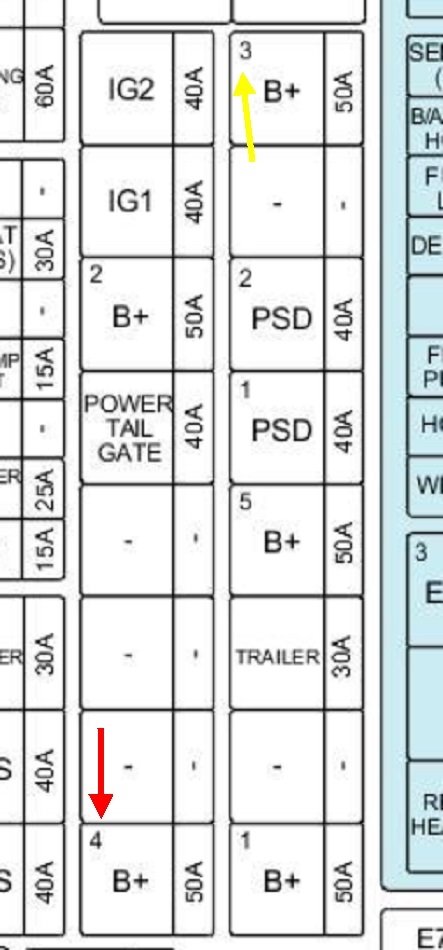

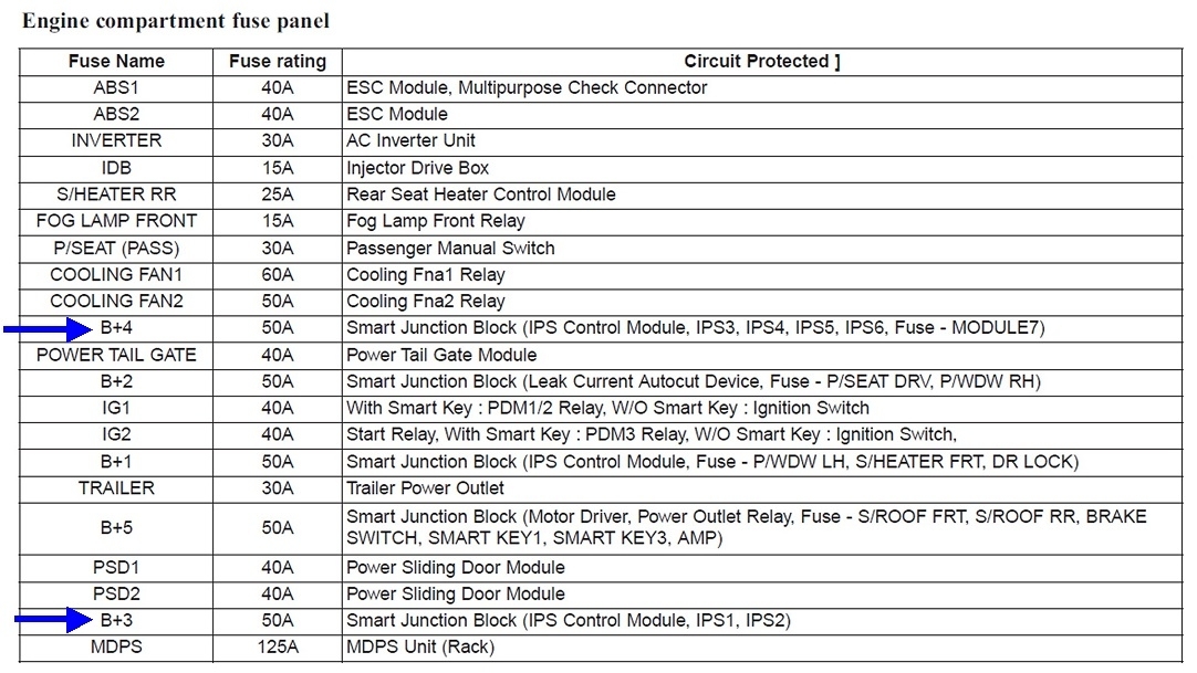

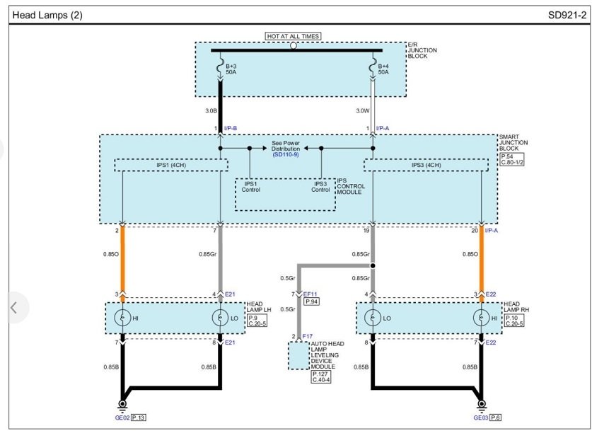

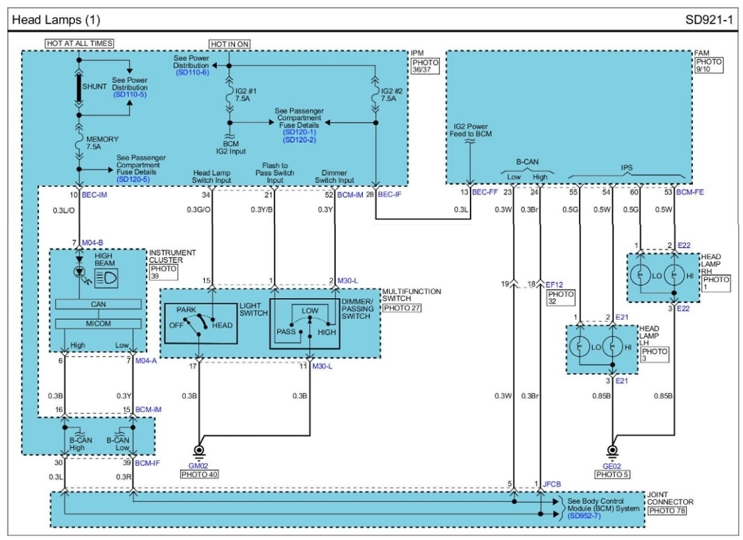

The engineers spent extra time making this as confusing as possible. These first two diagrams are for the headlight system. The third one is just the top of the second diagram expanded to make it easier to read. It shows a pair of 50-amp fuses labelled "B-3" and "B-4".

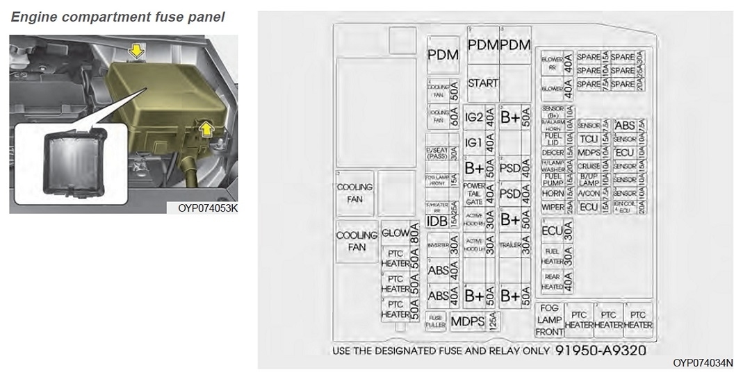

The "B+" fuses are in the engine compartment fuse box. The problem is there's five of them, and they don't specify which two are for the headlights. If you figure out which two they are, let me know and I'll add a note to the diagram.
Mar 29, 2022 at 2:40 PM

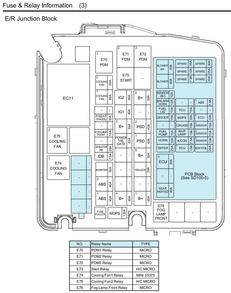

CARADIODOC
  • 34,321 POSTS
Here's a better drawing of the engine compartment fuse box. It shows the two fuses, B+3 and B+4.

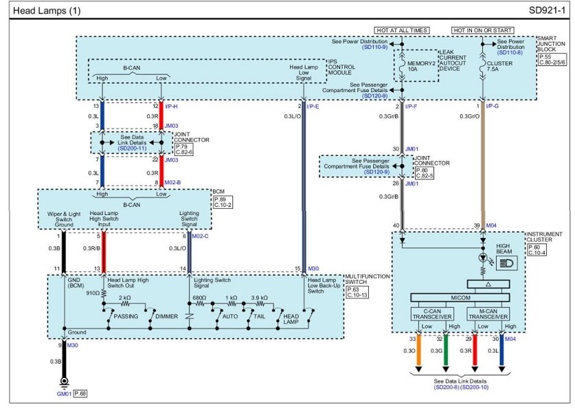

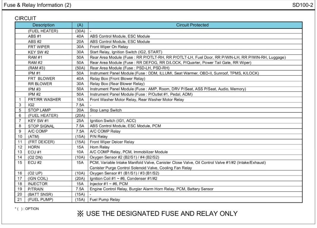

Here's the diagrams for the 2012 model. The first two are for standard headlights. The next two are for "auto" headlights. I'm going to make separate posts to reduce the confusion.

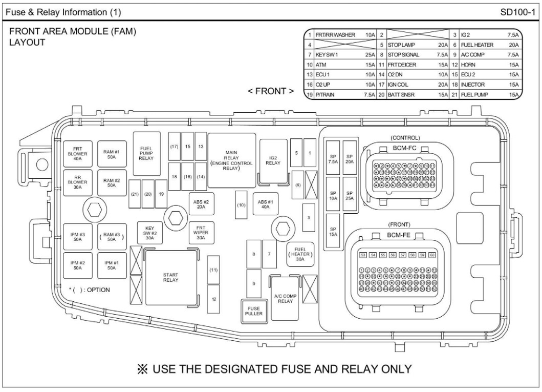

CARADIODOC
  • 34,321 POSTS

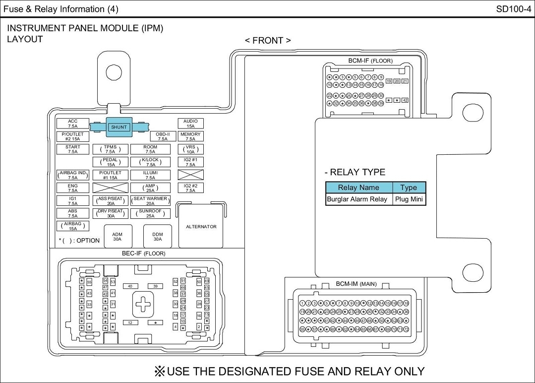

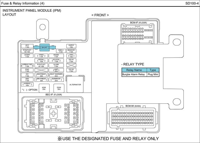

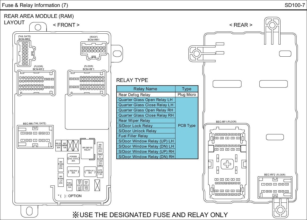

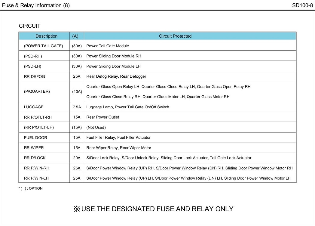

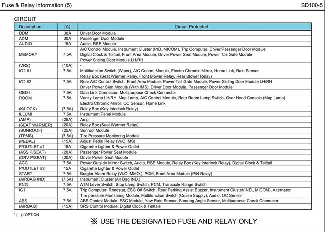

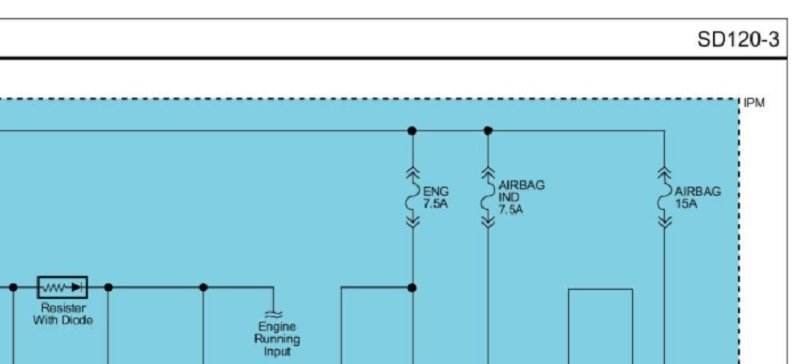

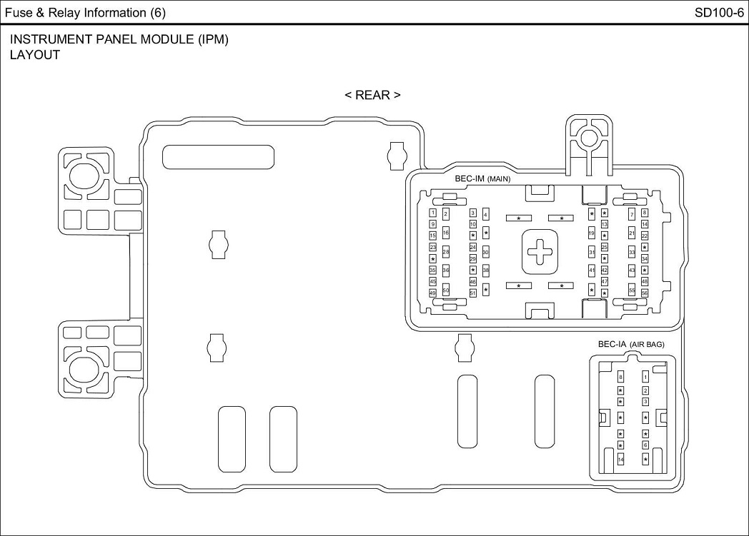

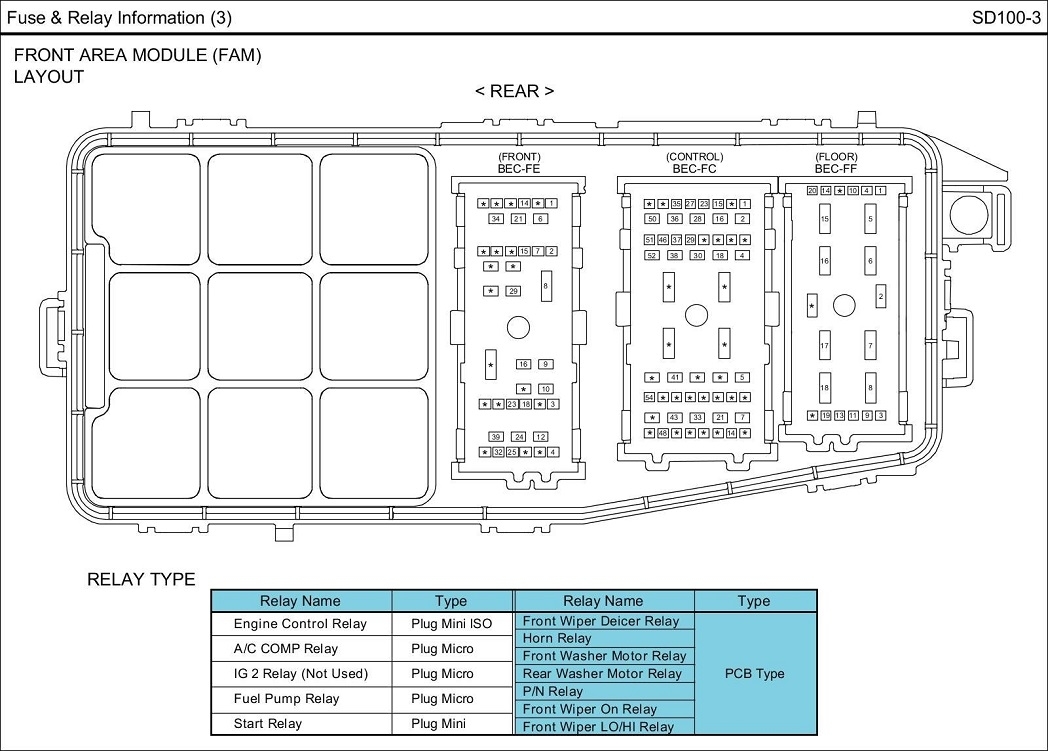

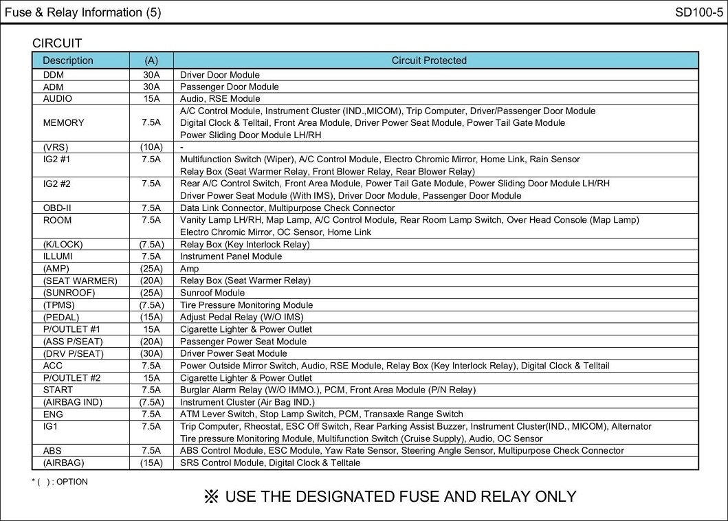

These are the fuse box layouts. The first three are for the "Front Area Module", (FAM). The third one is just the rear view in case you need it.
Diagrams 4 - 6 are for the Instrument Panel Module", (IPM), and again, the third one is for the rear view.
Diagrams 7 and 8 are for the "Rear Area Module", (RAM). The rear view is included.
For good measure, the Relay Box was part of this, so I included it.

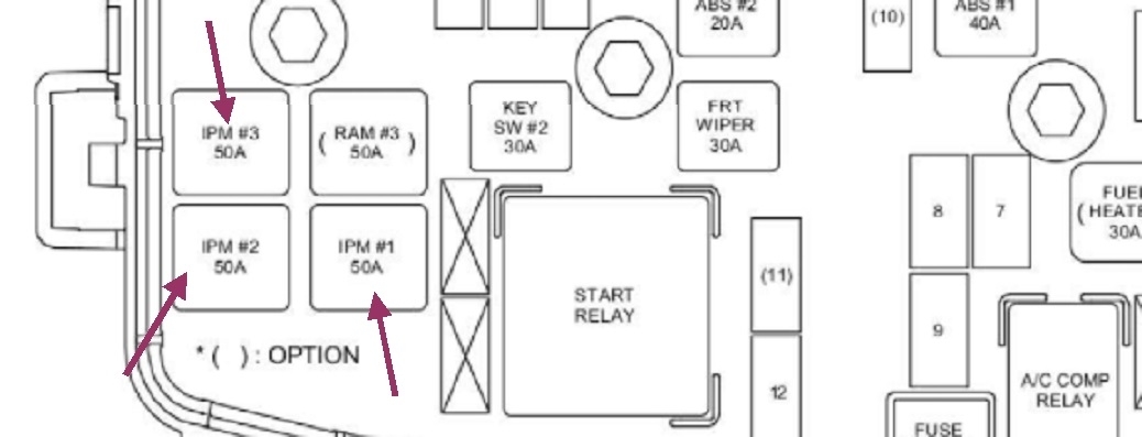

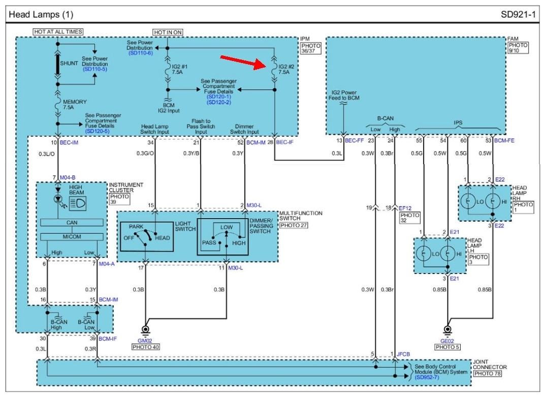

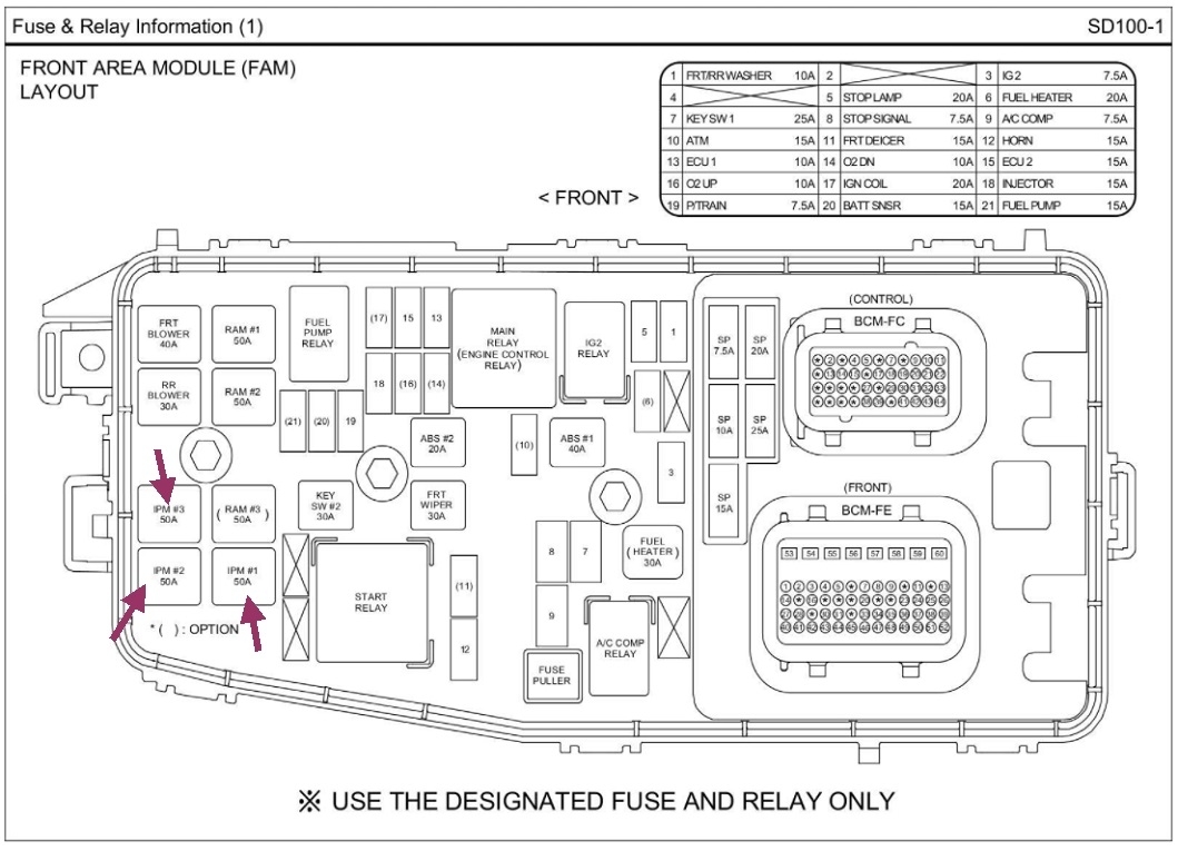

This is a non-OEM diagram for the head lights. As with the manufacturer's diagrams, the red arrow is pointing to the only fuse they show feeding the front Area Module. That's a 7.5-amp fuse, (red arrow). We know that we can't handle the entire module, but they seemed fit to not show anything else.
Based on what we saw in the 2015 Diagrams, might I suggest the three 50-amp fuses, (purple arrows), are for the head lights. I'll keep looking for better information.
Mar 30, 2022 at 1:44 PM
CARADIODOC
  • 34,321 POSTS
The only other thing I found is there is a direct battery feed to the Front Area Module. The 7.5-amp fuse I pointed out in the previous post is not related to the head lights. This would suggest the three 50-amp fuses are involved, even though they couldn't be bothered to list them as such.

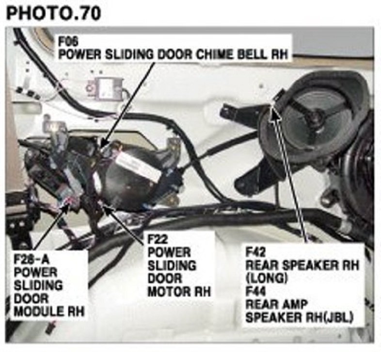

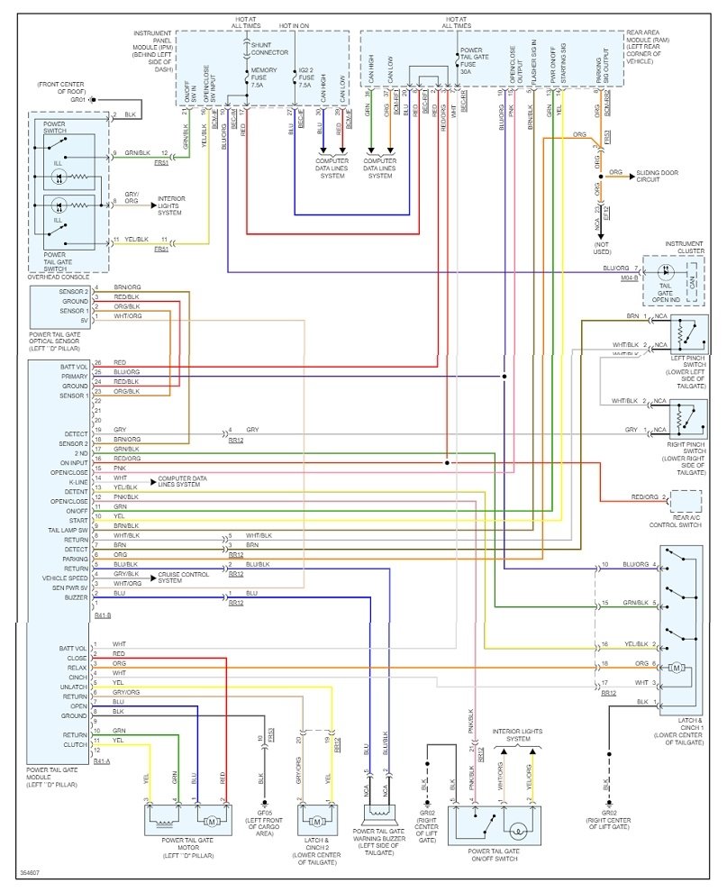

They don't list anything for the headlights specifically. I found buzzers related to the sliding power doors and the power lift gate. Will either of those help?
sliding doors and lift gate, buzzer location.

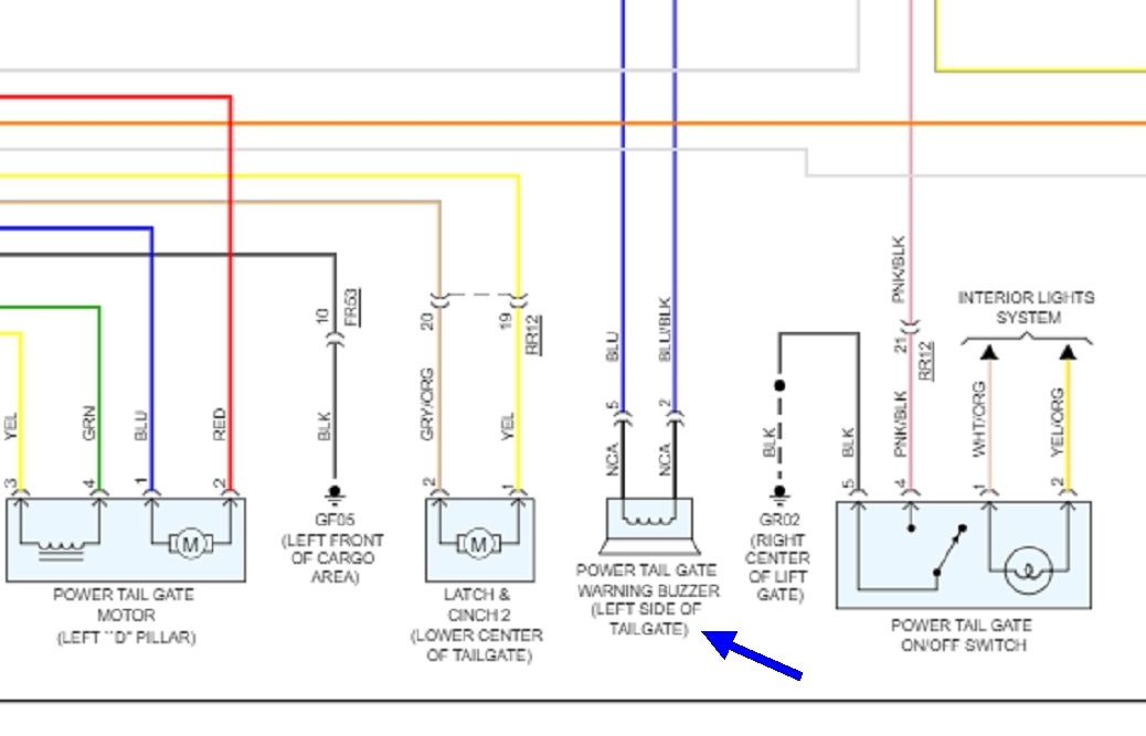

Mar 31, 2022 at 1:05 PM
CARADIODOC
  • 34,321 POSTS

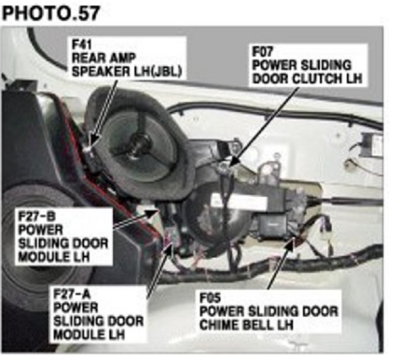

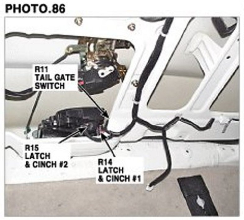

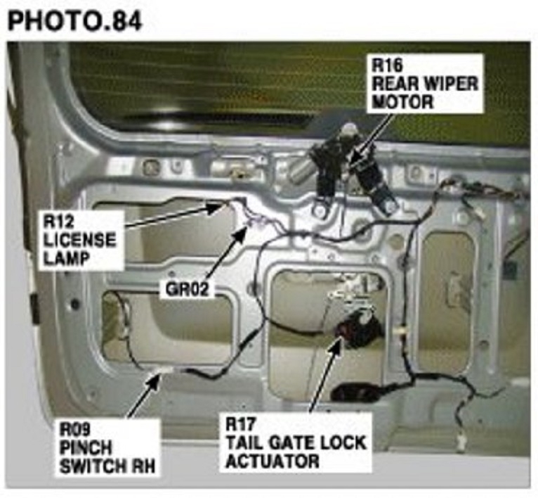

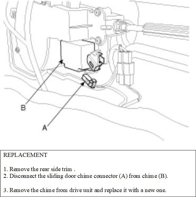

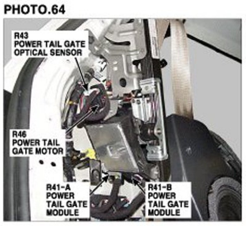

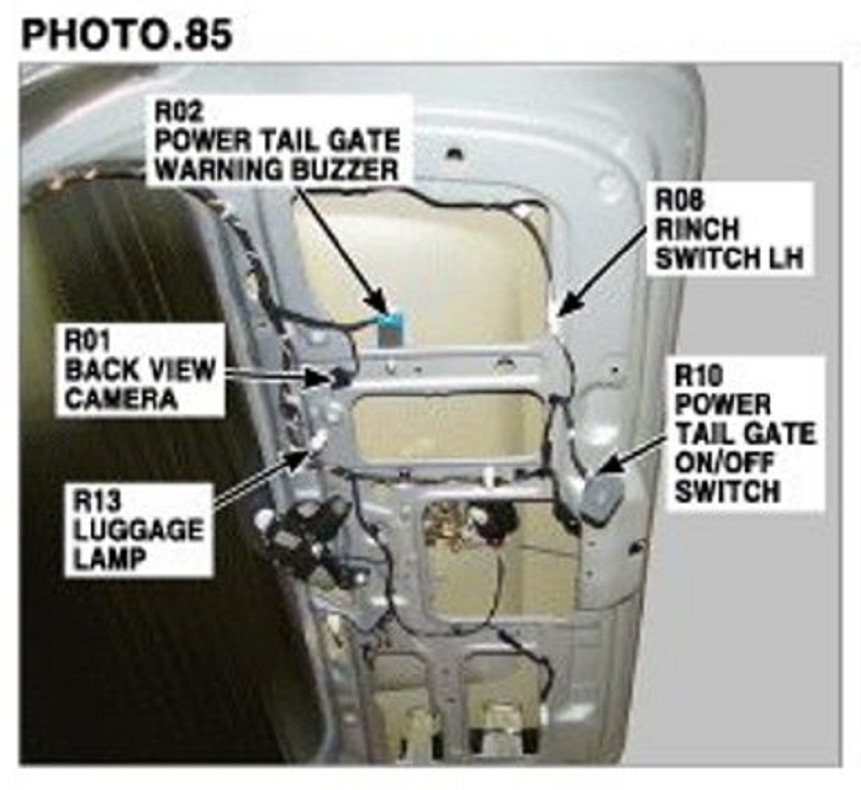

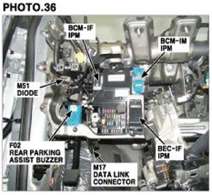

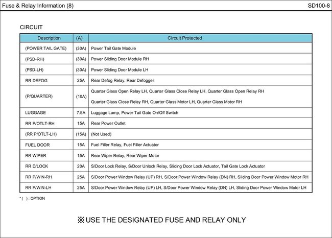

First, I found the drawing showing the sliding door. The diagram shows the lift gate chime is in the lift gate. The third diagram is just the lower part expanded to be easier to read.
Later I found these photos. I posted every photo related to the two power sliding doors and everything for the lift gate. Note that they do show the chime locations.

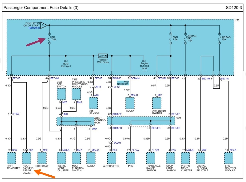

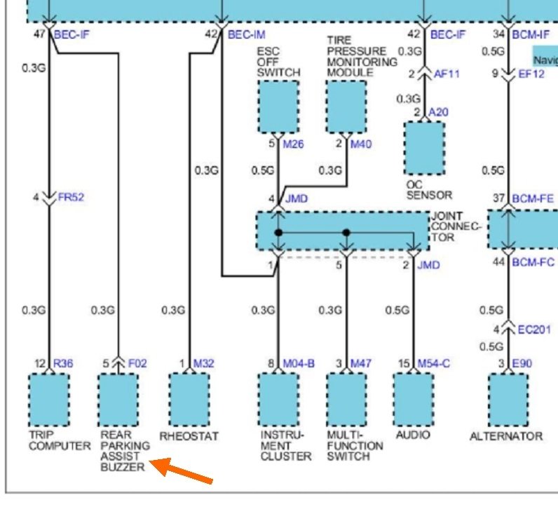

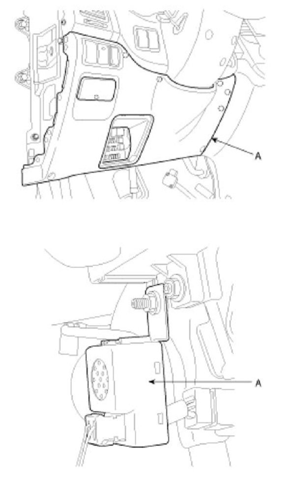

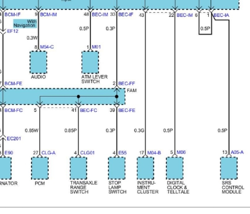

can you find the buzzer beneath the steering column? The problem is it stops sounding off when i step on the brake and stops when i start moving. i appreciate all your help. Thank you so much.
Help me find it, its driving me crazy when driving or at least the fuse that powers it.
Mar 31, 2022 at 4:19 PM
CARADIODOC
  • 34,321 POSTS

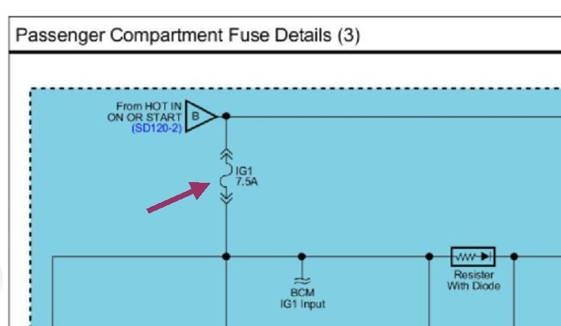

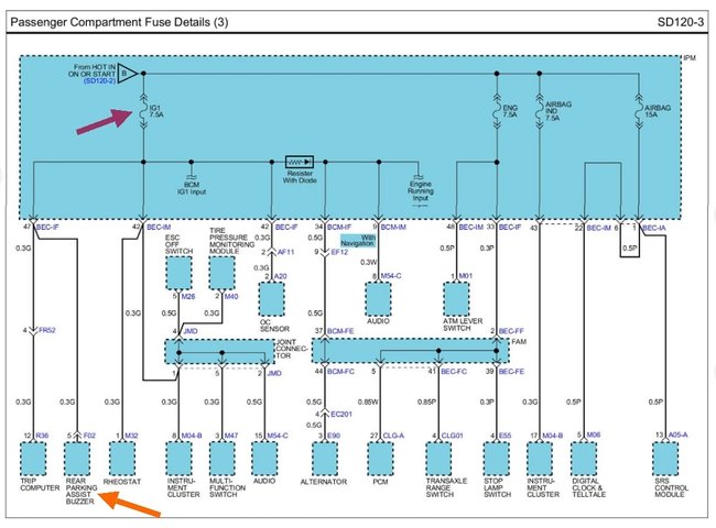

This is what's shown for the dash.
The third diagram shows the buzzer near the lower left, (orange arrow), and it's fed from a 7.5-amp fuse, (purple arrow). That fuse also feeds a number of other circuits, so removal isn't a good option.
If you can't read these diagrams, we have two options. You can copy and paste it into a typing program, (I use MS Word 97), then expand it, which usually turns it too fuzzy to read, or I can cut it into pieces and expand them separately for you.

I can cut it into pieces and expand them separately for you-please do so, sure appreciated.
Apr 1, 2022 at 3:06 PM
CARADIODOC
  • 34,321 POSTS
Here's the diagram in four pieces.
