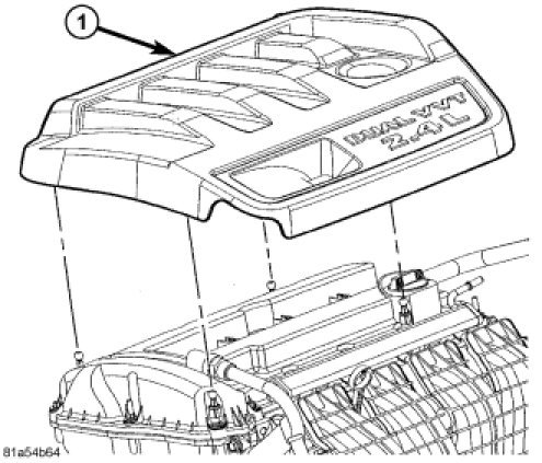

1. Remove engine cover (1).

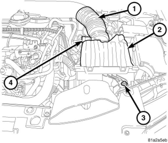

4. Remove clean air hose and air cleaner housing (2)See: Air Cleaner Housing > Removal and Replacement > Air Cleaner Housing - Removal.

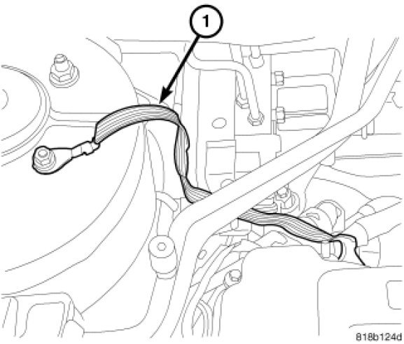

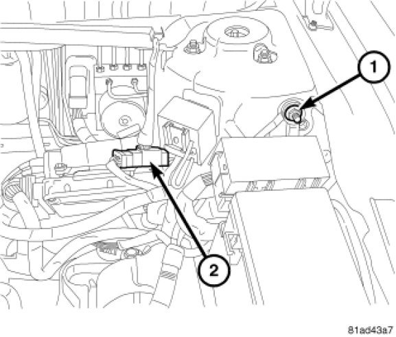

5. Disconnect negative battery cable (1).
6. Drain cooling system See: Cooling System > Procedures > Cooling System - Standard Procedures.

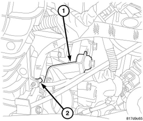

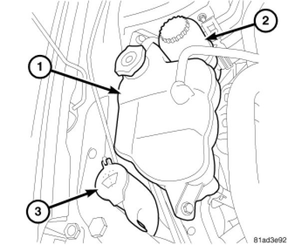

7. Remove coolant recovery bottle (1).
8. Remove and reposition power steering reservoir (2).
9. Remove power steering pump and reposition.

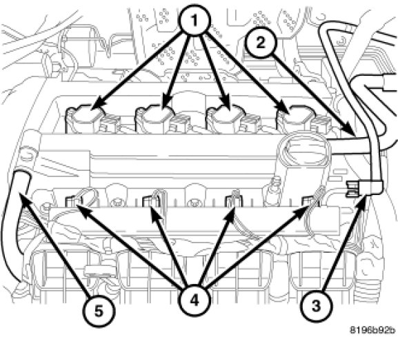

pic 6

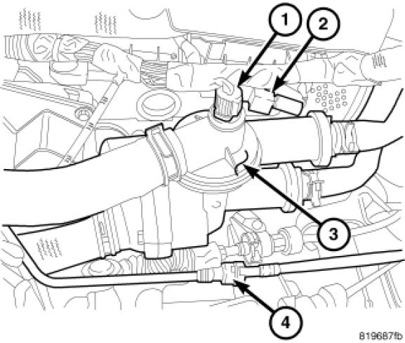

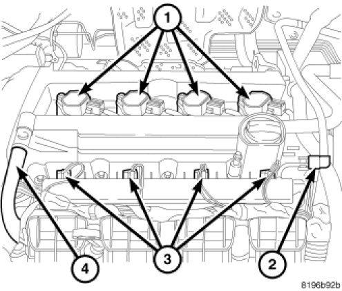

10. Disconnect breather hose.
11. Disconnect PCV hose (4).
12. Disconnect ignition coil electrical connectors (1).

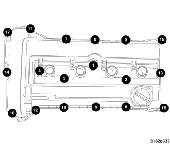

13. Remove cylinder head cover.

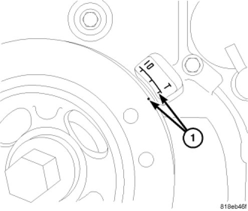

16. Set engine to TDC (1).

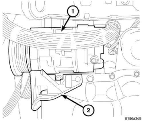

pic 8
18. Remove lower A/C compressor bolts if equipped.
19. Remove lower A/C compressor mount (2) if equipped.

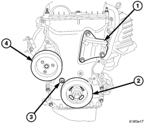

pic 9

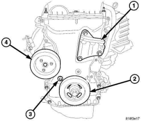

20. Remove accessory drive belt lower idler pulley.
21. Remove crankshaft damper (2).
22. Remove water pump pulley (4).
23. Remove right side engine mount bracket (1) lower bolt.

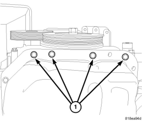

pic 10
24. Remove timing chain cover lower bolts (1).
25. Disconnect oxygen sensor electrical connectors.

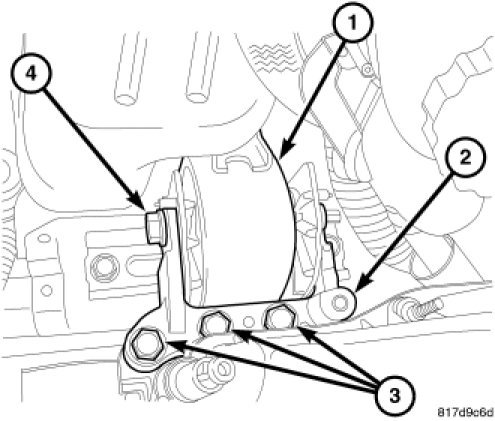

pic 11

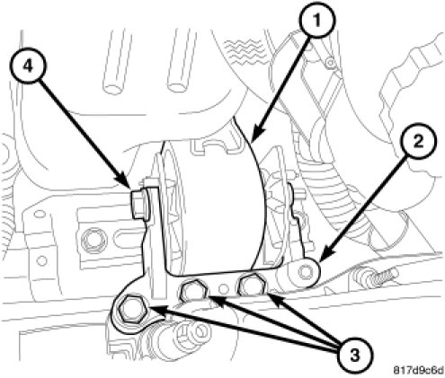

29. Remove right engine mount through bolt (4).
30. Remove right engine mount to mount bracket bolts (3).
31. Remove right engine mount adapter (2).

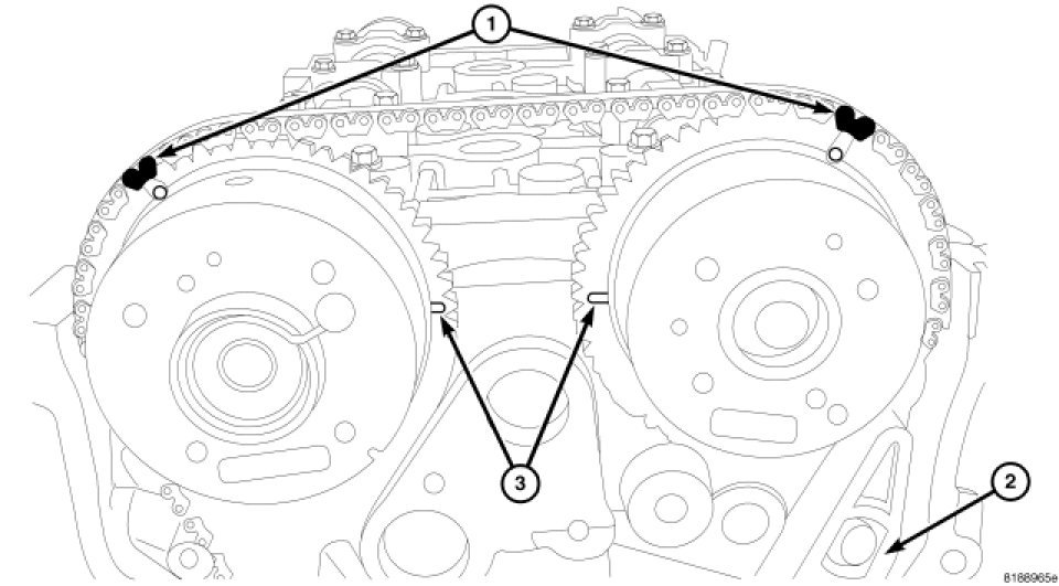

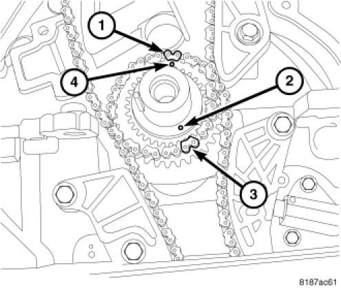

pic 13

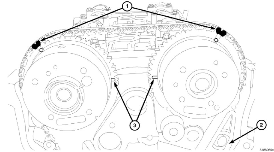

NOTE: If the timing chain plated links can no longer be seen, the timing chain links corresponding to the timing marks must be marked prior to removal if the chain is to be reused.
37. Mark chain link (1) corresponding to camshaft timing mark.
pic 14
38. Mark chain link (3) corresponding to crankshaft timing mark (2).

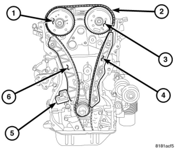

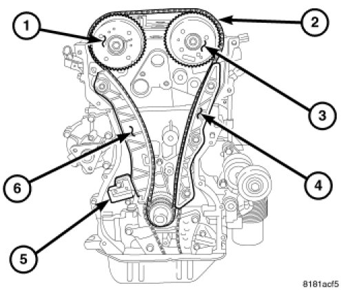

pic 15
39. Remove timing chain tensioner (5).
40. Remove timing chain (2).
41. Remove timing chain guides (4,6).

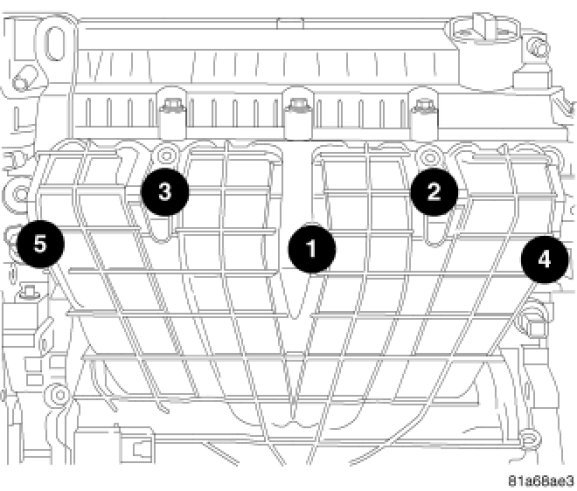

pic 17
46. Remove throttle body support bracket retaining bolt (2).
47. Disconnect electronic throttle control electrical connector.
48. Disconnect map sensor electrical connector.
49. Disconnect vacuum lines at intake.
50. Remove intake manifold retaining bolts.

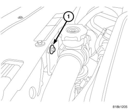

pic 18

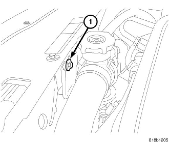

51. Remove upper radiator hose retaining bolt (1).
52. Remove intake manifold.
53. Remove coolant outlet manifold and set aside.

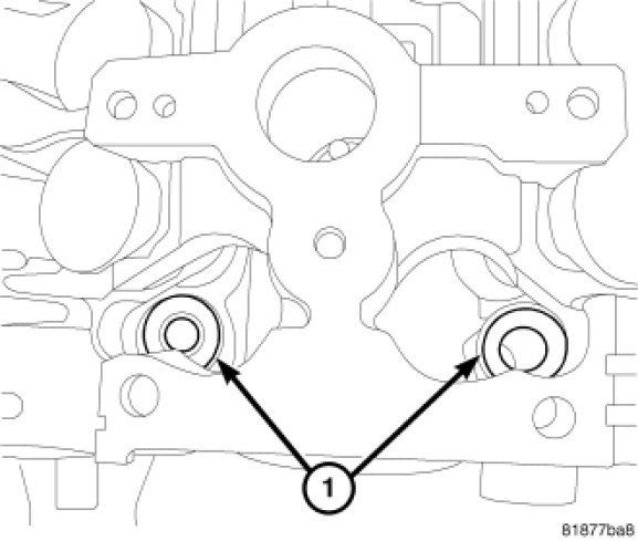

NOTE: All of the cylinder head bolts have captured washers EXCEPT the front two (1).

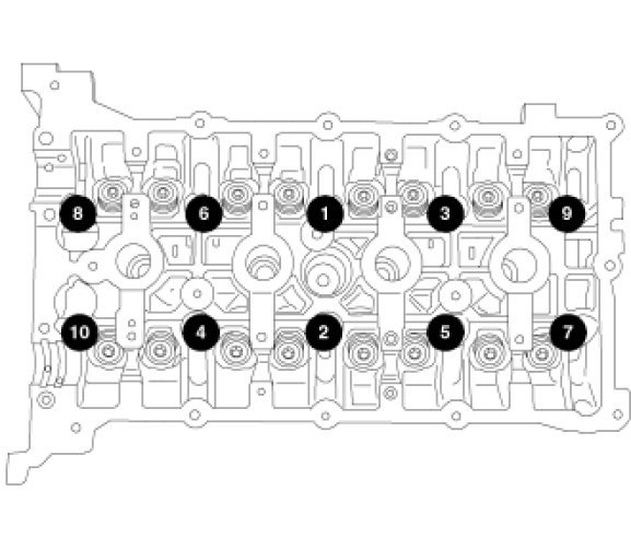

56. Remove cylinder head bolts.
57. Remove cylinder head from engine block.

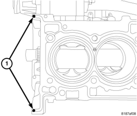

2008 Dodge Avenger L4-2.4L
Cylinder Head - Installation
Vehicle Engine, Cooling and Exhaust Engine Cylinder Head Assembly Service and Repair Removal and Replacement Cylinder Head - Installation
CYLINDER HEAD - INSTALLATION
INSTALLATION - CYLINDER HEAD

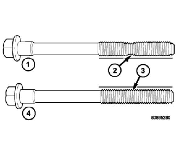

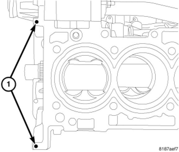

NOTE: Ensure cylinder head bolt holes in the block are clean, dry (free of residual oil or coolant), and threads are not damaged.
NOTE: The Cylinder head bolts should be examined BEFORE reuse. If the threads are necked down, the bolts should be replaced.
Necking can be checked by holding a scale or straight edge against the threads. If all the threads do not contact the scale (2), the bolt should be replaced.

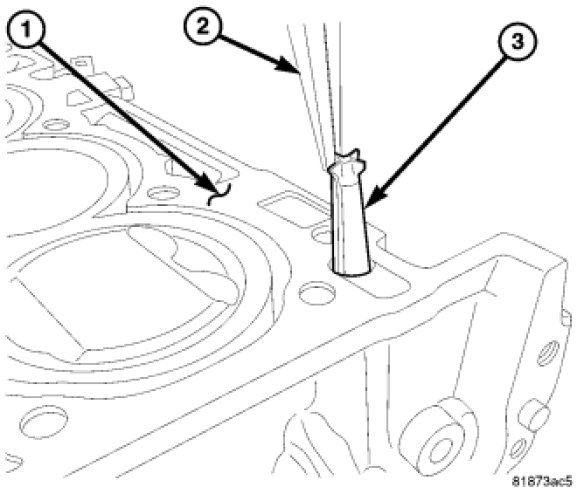

CAUTION: Always replace the variable valve timing filter screen (3) when servicing the head gasket or engine damage could result.
1. Replace the variable valve timing filter screen (3).

NOTE: When using RTV, the sealing surfaces must be clean and free from grease and oil.
NOTE: When using RTV, parts should be assembled in 10 minutes and tighten to final torque within 45 minutes.
2. Place two pea size dots of Mopar(R) engine sealant RTV or equivalent (1) on cylinder block as shown.
pic 24

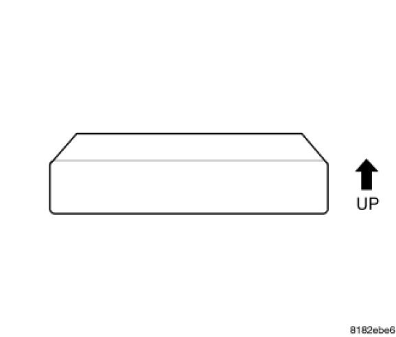

3. Position the new cylinder head gasket on engine block with the part number facing up. Ensure gasket is seated over the locating dowels in block.
4. Place two pea size dots of Mopar(R) engine sealant RTV or equivalent (1) on cylinder head gasket as shown.
NOTE: The head must be installed within 15 minutes before the RTV skins.
5. Position cylinder head onto engine block.

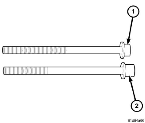

CAUTION: This engine was built with 2 different style cylinder head bolts. Each style bolt requires a different torque value. The bolts can be identified by the short bolt head (1) and the long bolt head (2).
6. Measure the bolt head from the washer to the top of the bolt head. The short bolt head (1) measures 8 mm (5/16") and the long bolt head (2) measures 13 mm (1/2").
7. Identify whether your engine has the short head design (1) or the long head design (2).

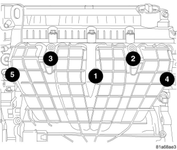

10. Install the cylinder head bolts and tighten in the sequence shown.
pic 29
11. If your bolt has the short head (1), use the following torque specifications:
- First: All to 30 Nm (25 ft. lbs.)
- Second: All to 61 Nm (45 ft. lbs.)
- Third: All to 61 Nm (45 ft. lbs.)
- Fourth: All an additional 90°
CAUTION: Do not use a torque wrench for the Fourth step.
12. If your bolt has the long head (2), use the following torque specifications:
- Second: All to 73 Nm (54 ft. lbs.)
- Third: All to 73 Nm (54 ft. lbs.)

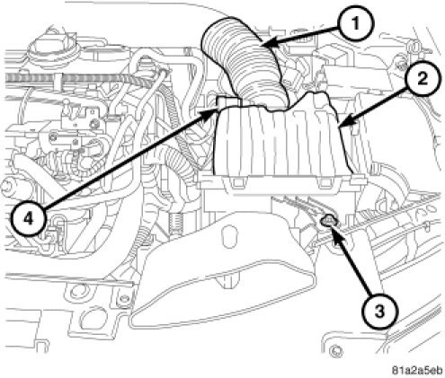

45. Install clean air hose (1) and air cleaner housing (2)See: Air Cleaner Housing > Removal and Replacement > Air Cleaner Housing - Installation.
