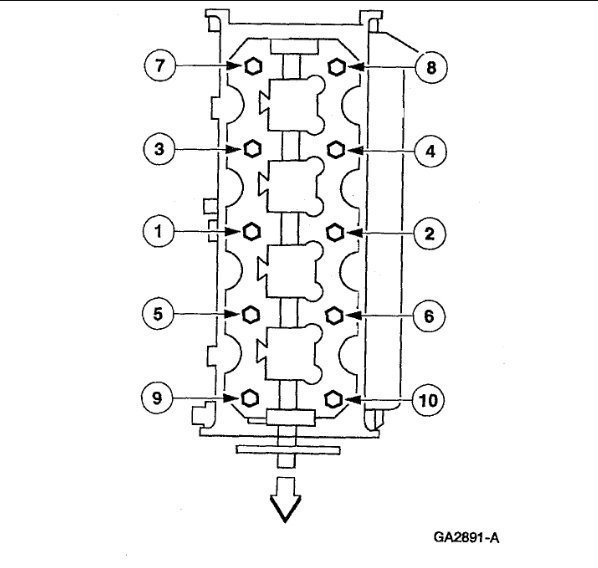

Good afternoon,

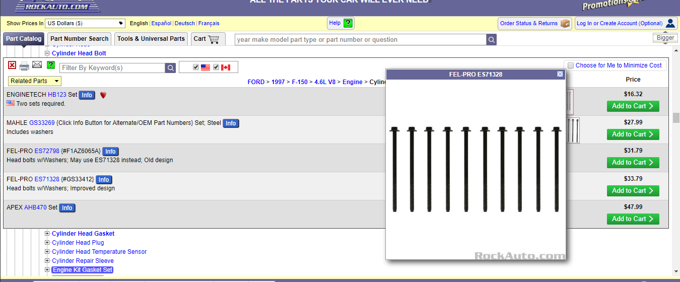

Yes, replace all the head bolts with new only.
No, there is not lube. That will effect the torques. They get installed and torqued dry.
TORQUE SPECIFICATIONS
CAUTION: Cylinder head bolts must be replaced with new bolts. They are tighten-to-yield designed and cannot be reused.
Tighten the LH cylinder head bolts in three stages in sequence shown:
Stage 1: 37-43 Nm (27-32 ft lbs.).
Stage 2: Rotate 85-95 degrees.
Stage 3: Rotate 85-95 degrees.

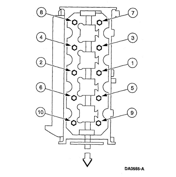

Tighten the RH cylinder head bolts three stages in sequence shown:
