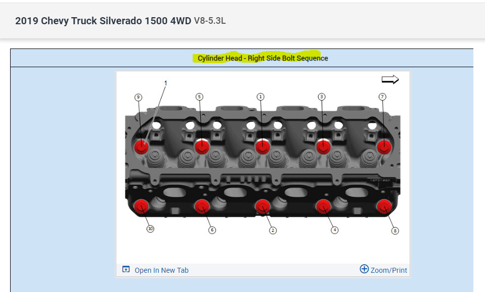

Can I get the Head Bolt torque specs and Sequence?
2019 CHEVROLET SILVERADO
123,342 MILES • 5.3L • V8 • 4WD • AUTOMATIC
TYLERJ.W
I want to replace my lifters. I just can't seem to find the torque specs or sequence to reinstall the heads. Would someone be able to point me in the right direction? I can find specs for older generations but nothing for 2019.

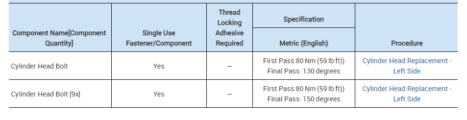

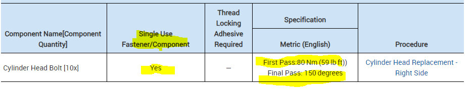

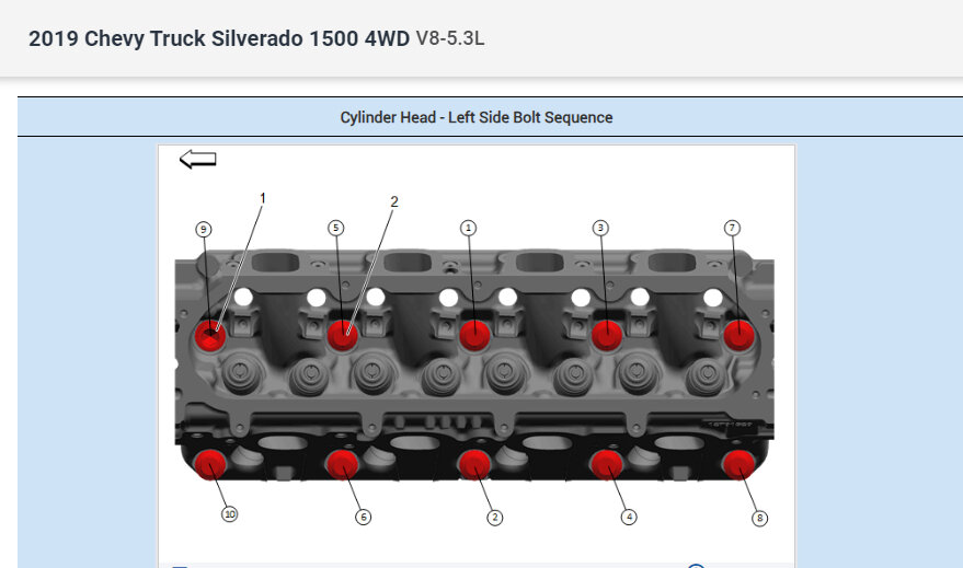

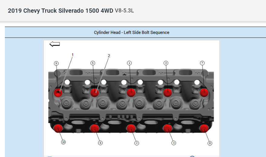

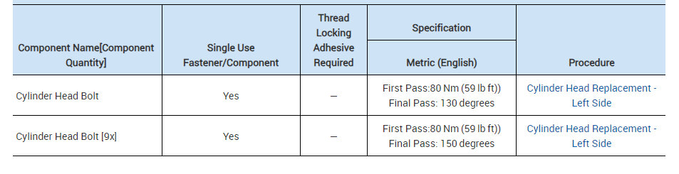

I attached the sequence and torque specifications below for you. In my manual, it is broken down by sides, left and right.
Note that anytime the head bolts are removed, you must replace them with new ones. They stretch when tightened and that only happens one time. So, they can't be reused.
Let me know if this helps.
