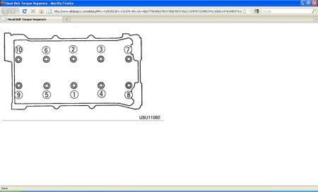

Head bolt torque and sequence ?
15,800 MILES • 1.6L • 4 CYL • 2WD • AUTOMATIC
PENNYE ROBERTS
The vehicle listed above is the LX model. please help! I keep getting conflicting information from the web.
Sep 15, 2019 at 7:35 AM
  • 110,248 POSTS
Welcome to 2CarPros.
Here are the torque specs and procedures. The sequence is listed in the picture I added.
Cylinder Head Bolt Tightening Sequence
Torque:
1st: 17.2 - 22.0 Nm (1.75 - 2.25 kgf-m, 12.7 - 16.2 ft. lbs.)
2nd: + 85° - 95°
3rd: + 85° - 90°
___________________________________
Note that the second and third time you go over them the above listed numbers are not ft/lbs. They are in degrees of turning.
Let me know it that helps or if you have other questions.

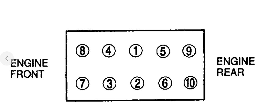

Engine Mechanical problem
2000 Mazda Protege Front Wheel Drive Automatic 100000 miles
head bolts torque sequence for a 2000 mazda 1.8l protege
Oct 31, 2020 at 4:57 AM (Merged)
SATURNTECH9
  • 30,869 POSTS
https://images.2carpros.com/forum/automotive_pictures/416332_2000_mazda_protege_1_1.jpg
Tighten the cylinder head bolts in two or three steps in the order shown to achieve a final torque of 76-81 Nm (56-60 ft. lbs.) There you go.
