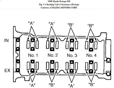

dohc engine. has a loud ticking on startup more so when cold. Sound like one valve. I have added oil addative with not much help. Is there anything to adjust or replace without having to remove the head? thanks

No, the camshafts need not be removed but a special tool would be required to compress the valve springs to remove the shim.
https://images.2carpros.com/forum/automotive_pictures/192750_ValveClearance98Protege_1.jpg
Valve clearance checking procedures. 1. Remove valve cover. Ensure engine is cold. Rotate crankshaft clockwise until No. 1 piston is at TDC of compression stroke. Measure valve clearance between base of camshaft lobe and valve tappets at "A". See Fig. 3. If clearance is not within specification, replace adjustment shim. 2. Rotate crankshaft clockwise about 360 degrees positioning No. 4 piston at TDC of compression stroke. Measure valve clearance between base of camshaft lobe and valve tappets at "B". See Fig. 3. If clearance is not within specification, replace adjustment shim.
https://images.2carpros.com/forum/automotive_pictures/192750_ValveClearance98ProtegeFig03_1.jpg
Courtesy of MAZDA MOTORS CORP.

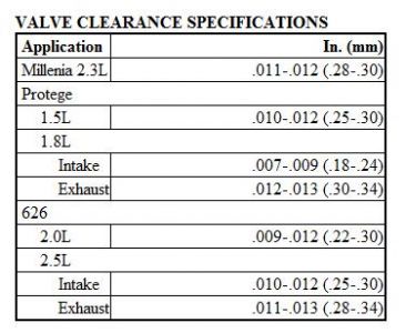

Checked valve lash as you suggested. #2 intake both, and both #3 exhaust, are out of spec .02 inches or .5mm. Should I change shims as ticking goes away after about 1 minute of running? thanks

0.5 mm is quite a lot of clearance. I believe it is 0.05 mm out of specs.
Since it is out of specs, it would be best to get the shim replaced to get the clearance to specs. Prior to doing so, check that the cam lobes are smooth and no abnormal wear or roughness are present.

Thanks for the info. I was looking in the wrong place for your answer. The clearance is .002 inches out or spec. I had thouble with the converson. I am having trouble finding the shims , even at the mazda dealers any suggestions Since you think I should try to replace the shims, where I might try to buy them.

If the dealer does not have it, then the other place you can try would be major parts store. It need not specifically be for Mazda. Just ensure the diameter and thickness is correct and it would work.
Do you have the procedure for getting the correct thickness?
