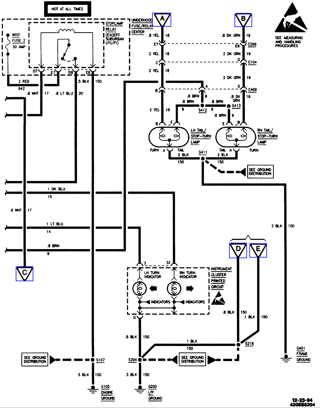

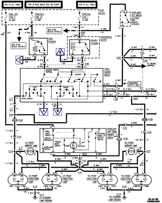

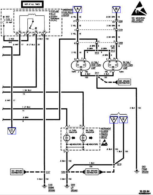

Okay, so I have a problem about my hazard lights, they do not work. So I checked the fuse for it and if you look on the description for that fuse in that spot it is for the hazard lights, brakes, and turn signals. My brakes and turn signals work but not the hazard lights. Like I can press down the hazard light button and it will click like two times but really fast then it stops. But every once in a while only one blinker light comes on and I think it is only my left one that turns on but remember this is only happens every once in a while and I do not even press down the button in order for it to turn on, even though it should. Is there any answer I could possibly get from this? If you still need some more information please reply. Thanks.

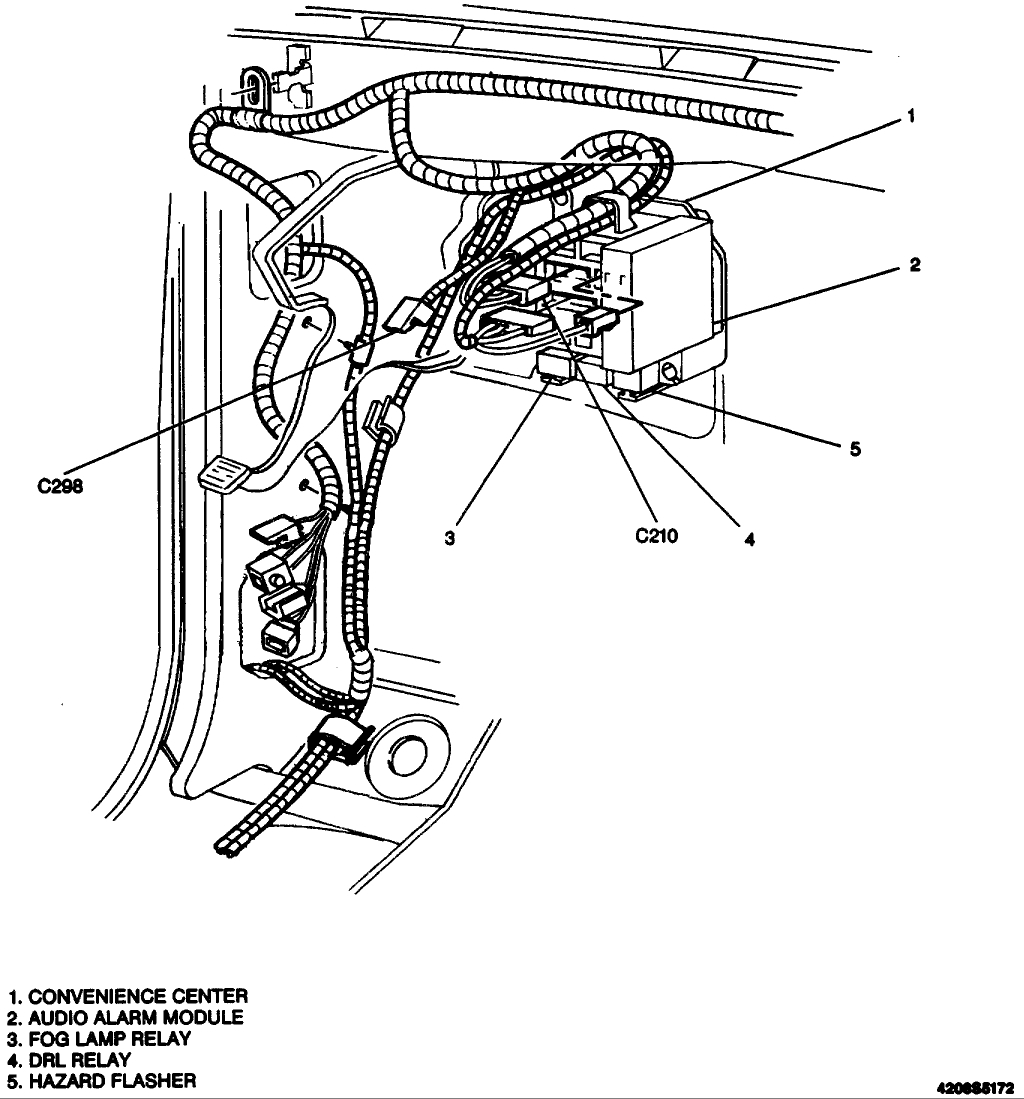

That description sounds like the actual switch or the flasher is bad. You say you can push the switch and the lights flash a couple times very fast then stop? Do the lights flash or you just hear clicks? The flasher is located in the convenience center, under the dash near the firewall. It sticks out the bottom. I would try it first. If that does not help you will likely need a new multi-function switch.
Oh, this has all stock type bulbs correct, not upgraded to LED? Those can cause problems like this because they don't provide the correct load to the vehicles electronics.

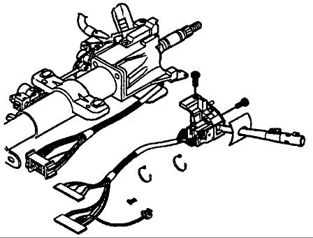

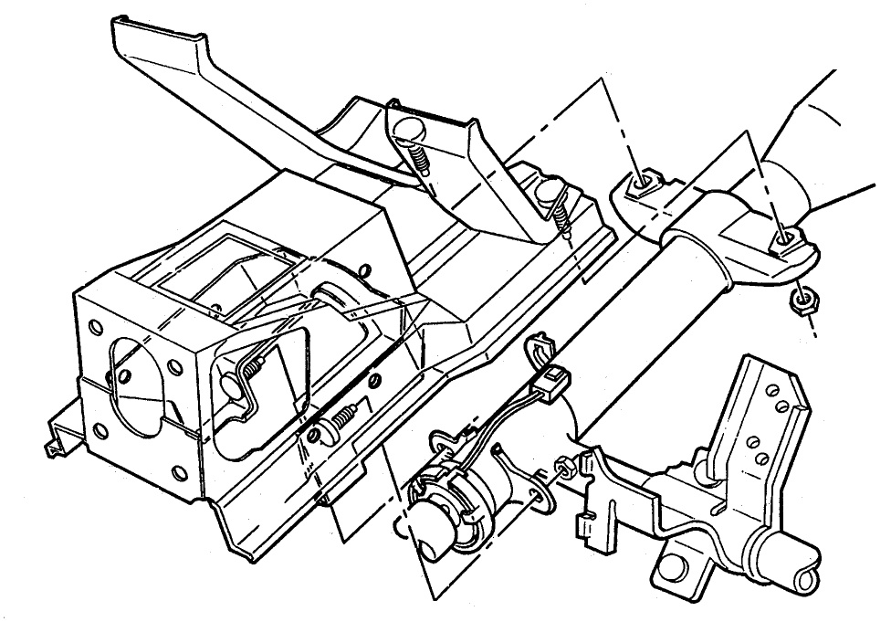

That sounds like a bad switch.
To change it out you pull the negative battery cable then the airbag module. Remove the tilt lever. Next you need to remove the steering wheel and the knee bolster under the column. Now you remove the column covers upper and lower. Then the steering lockset and loosen the nuts that hold the column in place.
Release the straps that hold the wiring harness, then release the plugs from the wiring block. Remove the two screws and the switch.
